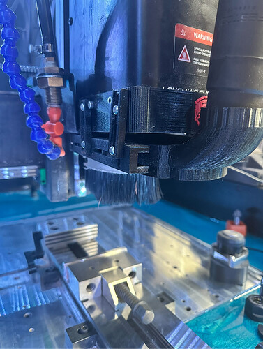

Designed dust boot that can be raised and lowered as well as inserted and removed based on material.

this looks great! would you be willing to share the step files for the dust boot?
