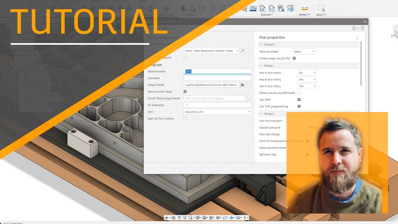

I was really excited to cut my first piece the other day. Finally got everything working. I’m not good with computers at all so I’m sure I’ve been making everything harder than it needs to be. I’m on a Crossfire Pro with THC and using a machine torch from George with the razorweld 45 from Langmuir. Anyway, when I went to do my post processing on my second project, the post processing menu in Fusion 360 changed and I can’t figure out where to post it so I can open it in firecontrol

What are screen caps? Captions? I uploaded a
Picture of the screen where I am having the
Issue
I only asked what you had in the small box because what post processor you load in this small box will change the options you have in a larger box.
There was a library selection drop down menu. I couldn’t find any containing “firecontrol” in the title. I tried this one hoping I could copy it and export it to firecontrol. I was unable to do so.

First thing I tried was what Jamesdhatch suggested and it worked!
