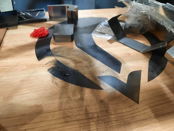

I started cleaning my punches and dies, using acetone and paper towels. Went to clean the base and took off the painted logo. Triple Joy! Needless to say, I was livid at this point.

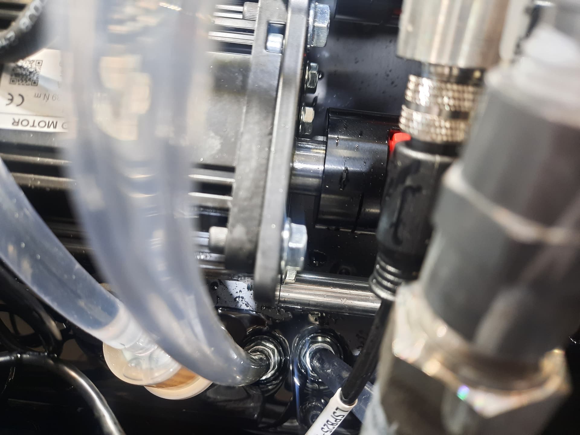

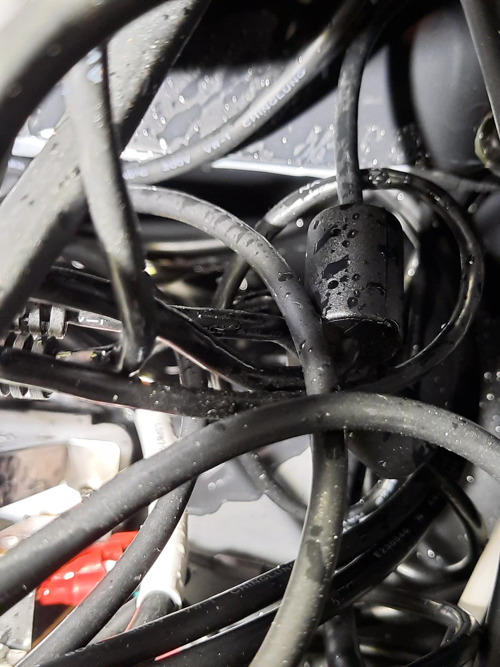

I made some bends today - no pop, no hard limits, no problems at all…except for a large puddle of OIL dripping out the bottom screws of the electrical enclosure… haven’t pulled the top off yet, but i’m sure there is going to be OIL EVERYWHERE…
Placing sensitive electronics, drivers, power supplies and all the cable plug connections directly inside an enclosure with high pressure oil …without a divider or separator of any kind…seems like a horrible idea. not looking forward to this at all…5th round of buyer remorse creeping in
Might want to double check, but I think this is a corrosive. That wont be good long term on electronics.
Thankfully this is the sort of oil you could dip your electronics into and they would be fine. You will still want to wipe up the worst of it. A bit of paper towel with some alcohol or just some blown air should do the trick.
Once you open up the box and find out if anything is wet that is above the hydraulic fluid tank, shoot me a message and let me know and I can get you a solution if there is anything you should do. Hopefully this is just some leftover leakage through a tear in the silicone sealant on the lid.

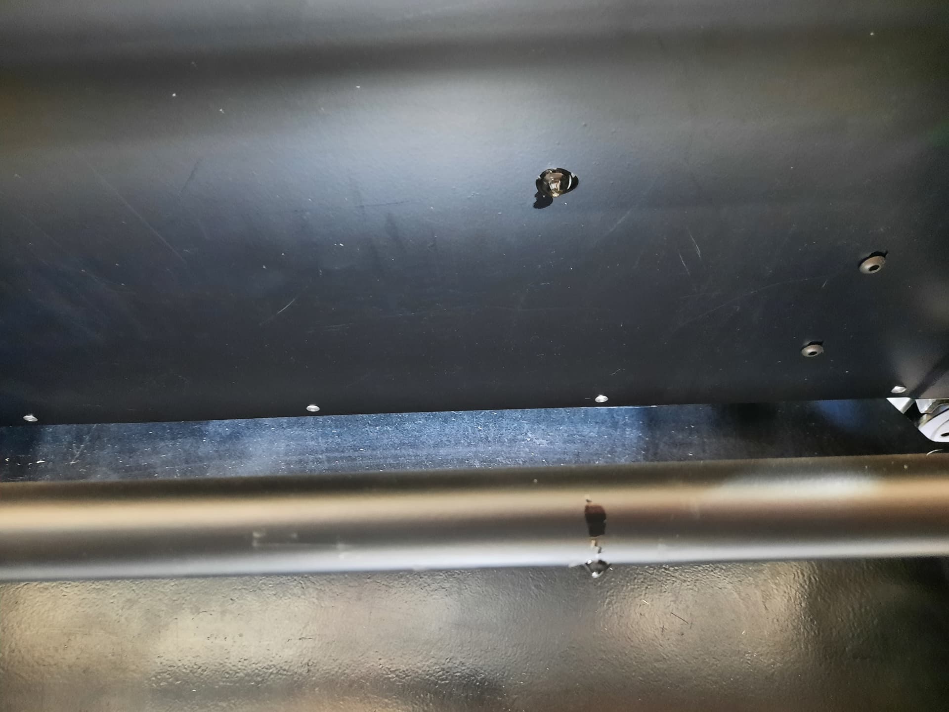

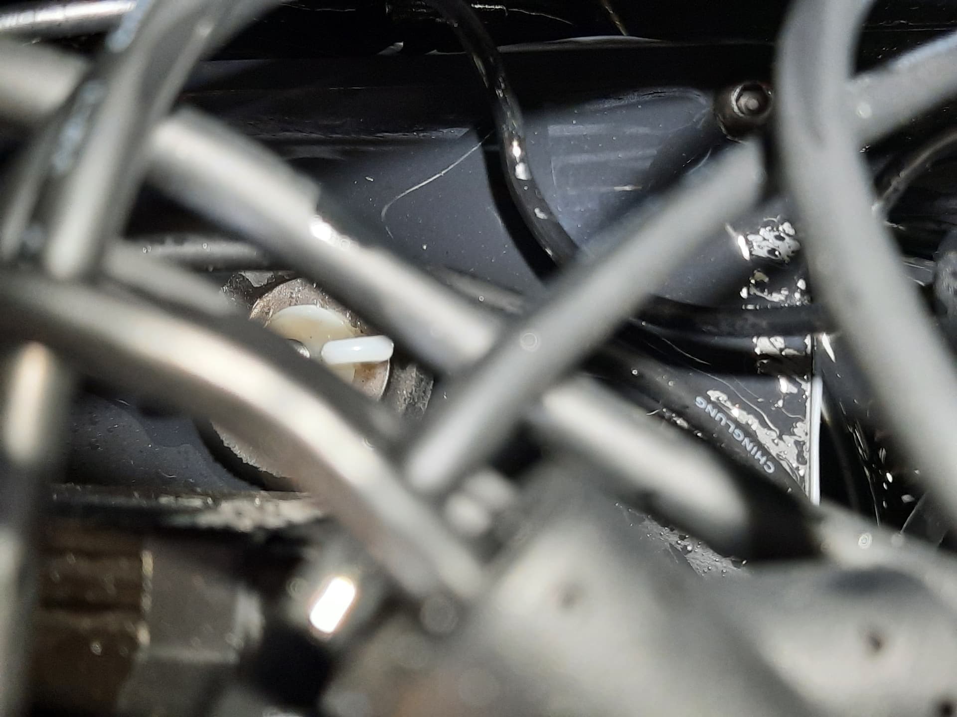

I removed the enclosure lid to inspect, and yes, it looks like the lid of the hyd tank is the source of the leak. I see the grey sealant oozed out in some places, especially around the tank bolts. I assume there is no gasket used here? and the seal is expected from the sealant alone ? :roll_eyes:
The oil level is approximately 2" from the top through the fill hole. IDK how much the pumps shoot oil around inside the tank, but it’s not over filled.
I see the tank lid top is the attachment point to the enclosure on two sides with 4 bolts. Since you suspected this was the source of the leak, I assume this is a common issue and I’m not the first or the last to deal with this.
Do you have a procedure documented to distribute or a video on how to repair this ?
Is there a drain procedure to get the oil out of the tank- disconnect “X” line and use the pump to bleep out the majority of oil from the tank and lines before taking the hard lines apart?
It looks like the tank and pumps/motors will come out in one unit, then the scraping/removal of the old sealant, cleaning and install a new gasket with sealant.
Please tell me you are using some sort of EPDM or BUNA-N gaskets for all of the machines shipping out now???
If you let the sealant cure 50% before tightening the bolts down, the sealant would have a chance to do it’s job, instead of tightening the bolts down 10 seconds after application and all the sealant oozing out of the joint, leaving a razor thin amount of sealant to do the work of a gasket.
I stuffed a diaper in the bottom of the box for now to soak up the mess and stop it from leaking all over the machine. It’s not just a few drips, it’s a puddle. Thankfully none of the boards or electronics got oil on them.
Now that the unit is stationary, you shouldn’t see anymore of a leak. That was just from the sloshing of the oil during shipping. The pumps do not significantly churn the oil so there is no repair needed unless you plan to ship it again.
We fill the tanks to 2", but they can be as low as .75" and still function. Since we sent out your unit we have changed the type of sealant we use to a more heat-resistant one which has helped.
