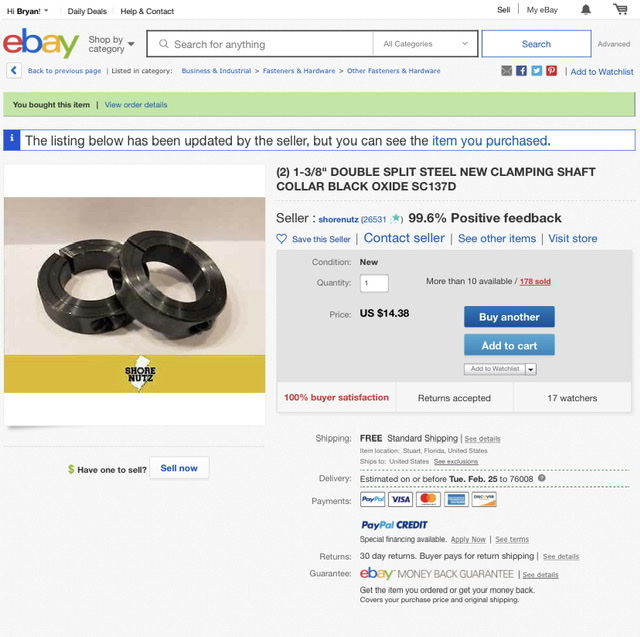

While waiting one my pro to arrive I’ve been doing some reading and decided I wanted to take advantage of having a machine torch mount but didn’t want to spend $75-$100 for something so simple. I bought these rings off ebay for $15 that fit the Hypertherm machine torch perfect. I plan to weld them to a piece of flat stock once I figure out exactly how wide it needs to be. For non welders, they could easily be tapped the bolted to a piece of flat stock.

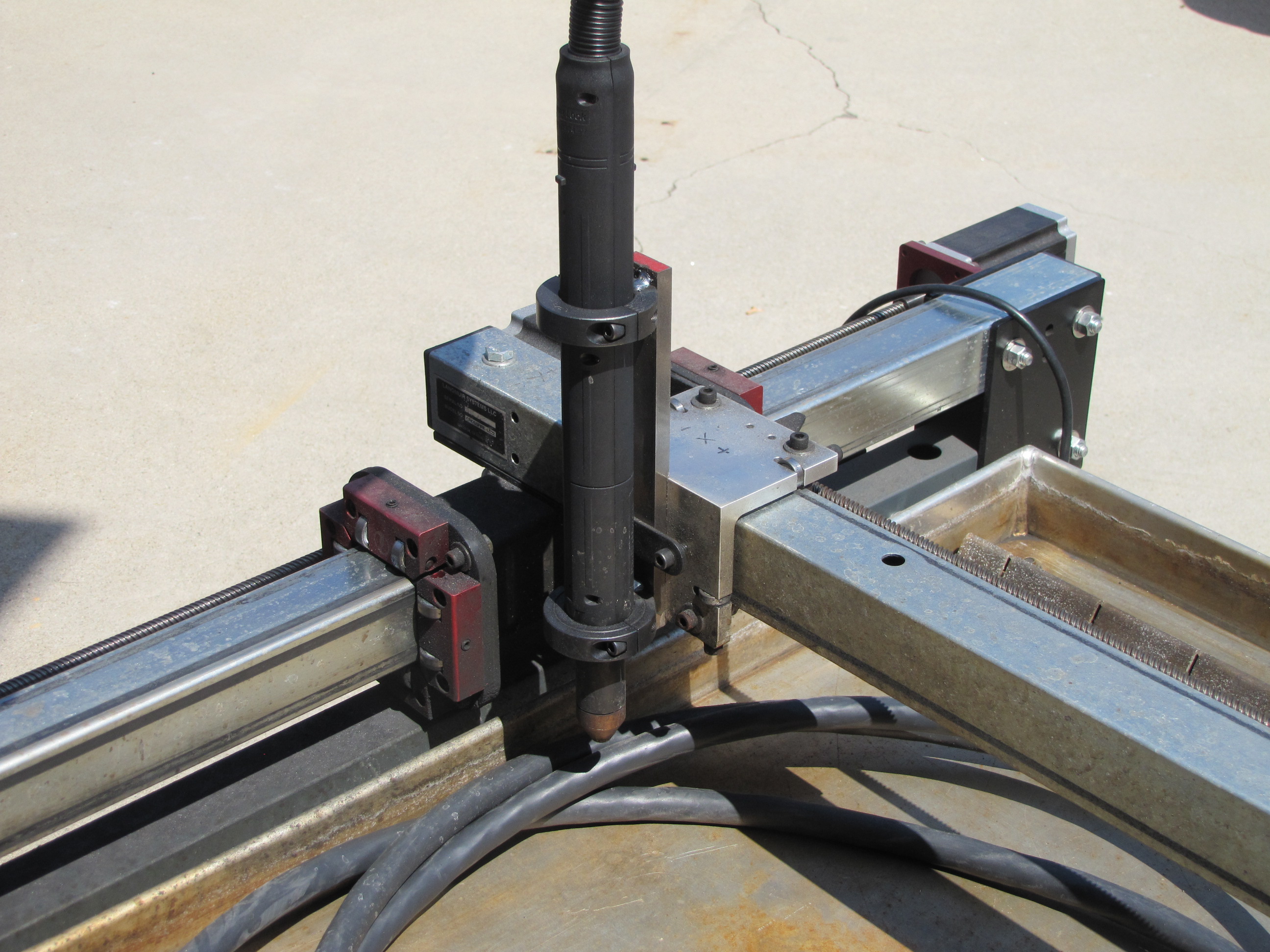

Good idea! I 3D printed my rings in ABS and cut a piece of 1/4" aluminum on the Crossfire for the slide bar. Everything turned out perfectly square but I feel like that was almost luck. With no adjustments, if the gantry isn’t perfectly square, there’s no way to adjust for a tilt in any direction.
The upright for the torch holder is 8 mm x 25 mm or in inches 0.318"x 0.987".
That’s from my standard crossfire table, but they look the same. Thanks for the clamp info.

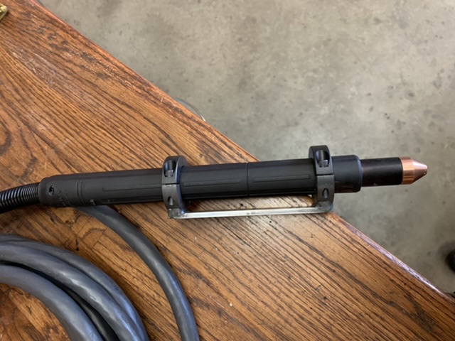

Sanded some 1” stock down to .986ish and spent a couple minutes with a speed square and ruler. Then clamped it down, tack it together and check to make sure the the bar is parallel to the torch body then weld it up. Pro should be here Monday, hope to try it out soon.

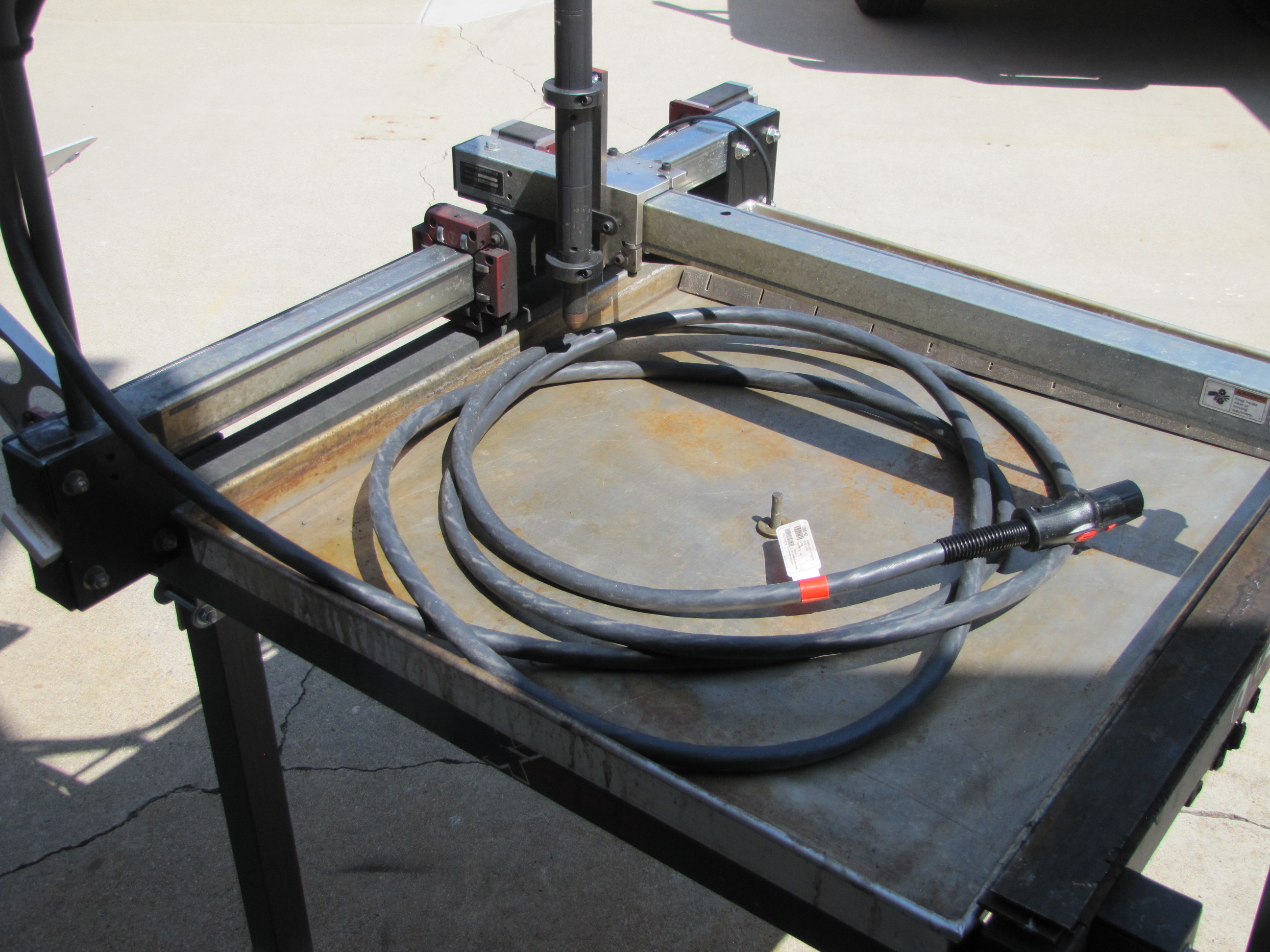

I still have a lot to learn so my question may have overlooked something obvious: Will I need to plan on making or buying a machine torch mount to mate with the Crossfire Pro table (April build)? Is the table not equipped to grab onto the torch as-is?
My Hypertherm 45xp arrived earlier today so it looks like I’ll be spending the weekend reading the manual.
The one supplied will work just fine but it attaches to the retainer cap, which you have to remove to change consumables. Kind of defeats the purpose of buying a machine torch to leave on the machine all the time when you have to take of off to change consumables. This one attached to the body so you can remove the retaining cap while the torch is attached to the machine.
So I’ve been busy leading the new machine and having fun with it. The torch mount works correctly, the only thing I changed is the thumb screw Langmuir provides sticks out too far to use with these rings so I replaced it with a 1/4”-20 socket head cap screw to match the other side. It’s nice checking/changing consumables without removing the torch.

I completed my torch mount a few days ago and it seem to work really well. I do like being able to check the consumables without removing the torch. I put the two clamps in the milling machine and cut a flat on the back or the threaded part. the flat is the same width as the steel bar, just under 1" wide.
Originally I was going to connect the clamp rings to the bar with screws, but I broke a tap in one of the clamp rings, so I just welded them. I made a wooden spacer to keep the torch and bar parallel. Photos below.
