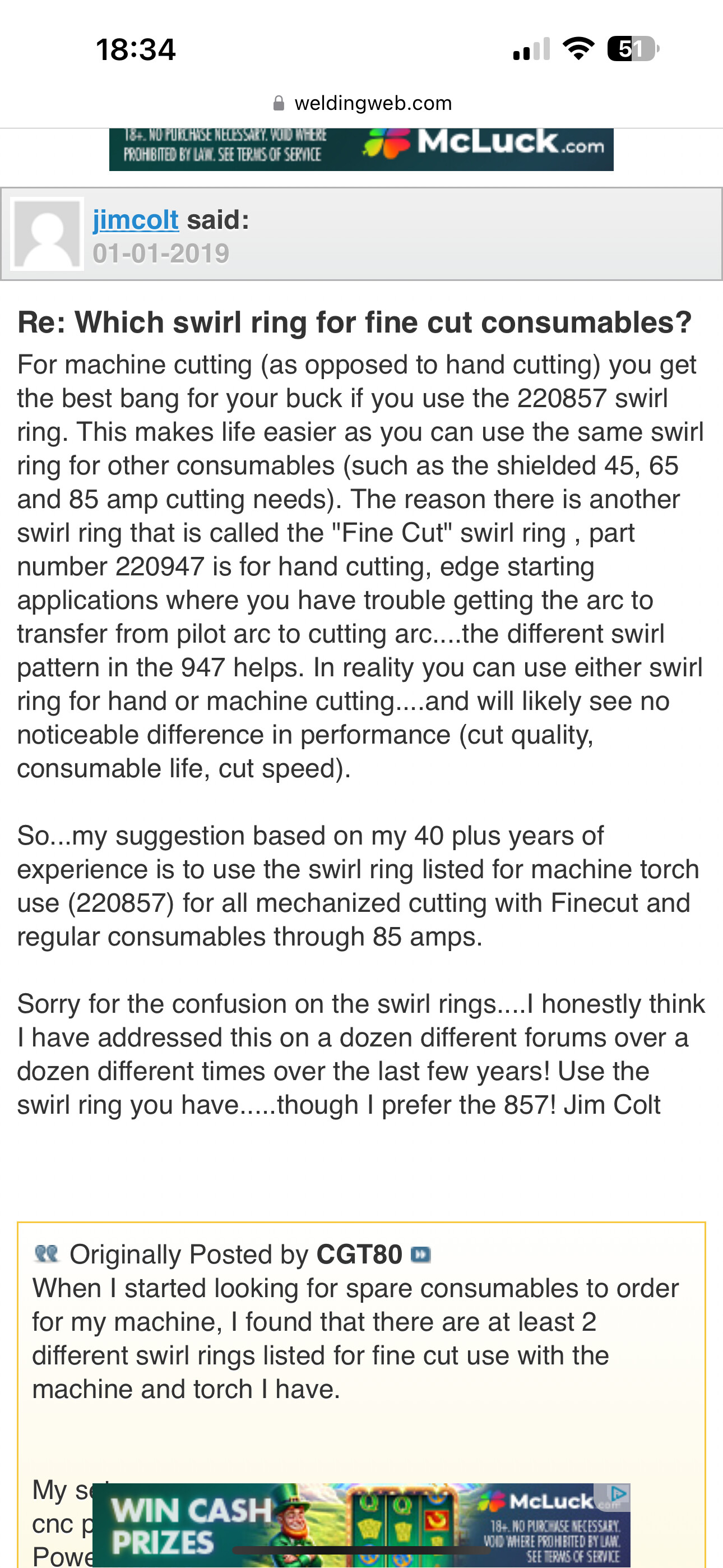

You did not elaborate on a few of the questions you asked above. Im wondering if the fine cut swirl ring has a significant effect?

To your other questions. I dont have the fine cut wirl ring, so perhaps I need to get that?

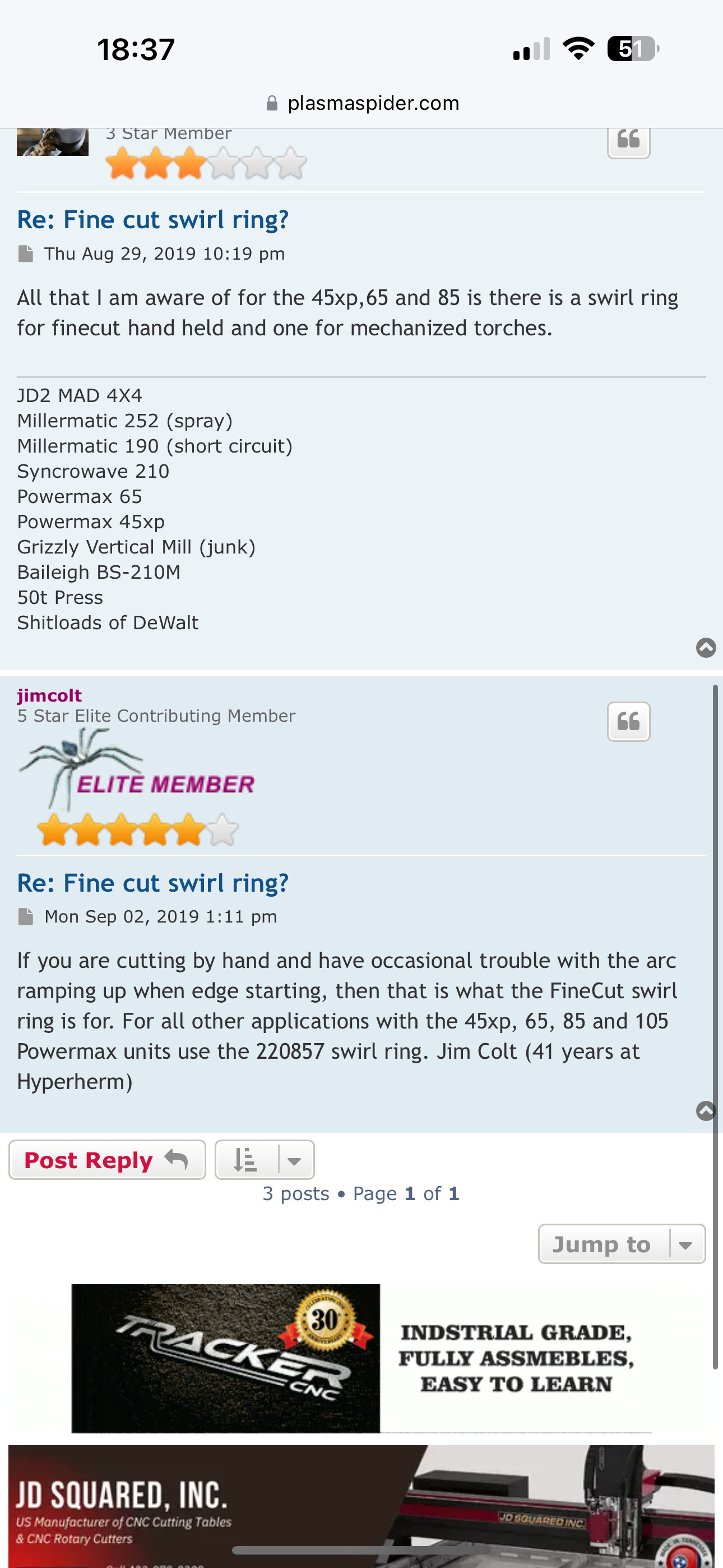

I was preparing to give you a hard time for not simply using what hypertherm tells you to use in the manual, but decided to do some research first besides just being a hypertherm fanboy and saying “because they said so”. Although, it’s hypertherm, so there is still a little bit of “because they said so”. Lol
Turns out, the reason for the redesigned swirl ring is for helping get the arc started for hand cutting and the fine cut swirl ring is not required for machine cutting. Jim Colt was a hypertherm engineer, here are two posts from him.
It makes sense for them to say to just use the fine cut swirl ring, saves them from having to clarify the difference in application.
Thanks, I went ahead and ordered a fine cut swirl ring today before you put this post up - ah well never mind.
