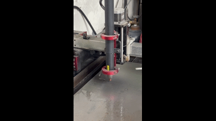

I have a Crossfire table. Recently i noticed when i am manually moving the nozzle it rises at a certain spot on the table repeatedly. If i move it to that spot and lower it, it will still lower more when i move away from the spot. It also does it when I do a dry run. Also it does it in both direction.
does it do that when the torch is on the far right sides of the table? post a pic of how you have the torch mounted.
i just figured out how to upload this
torch rising
Looks like you might need a lil more slack on the torch whip. is it snagging on something form the boom and is the boom moving with the torch when its moving around?

I fill a little stupid right now, but that was the issue. Better a little stupid than broke. I had recently moved my table around and didn’t realized how little slack there was.
