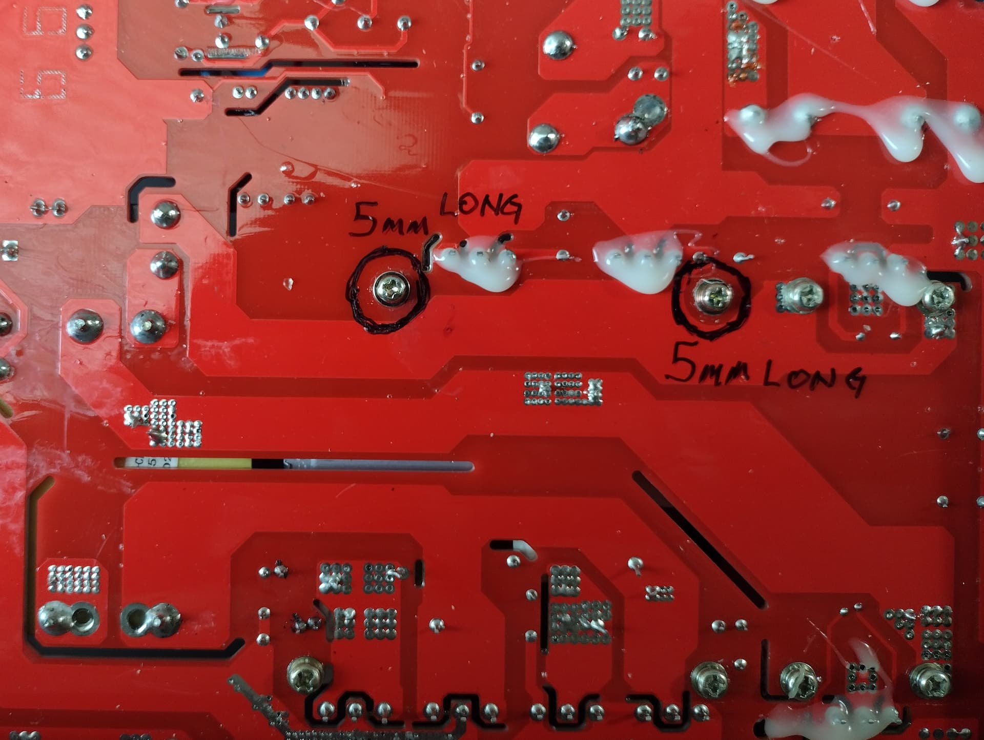

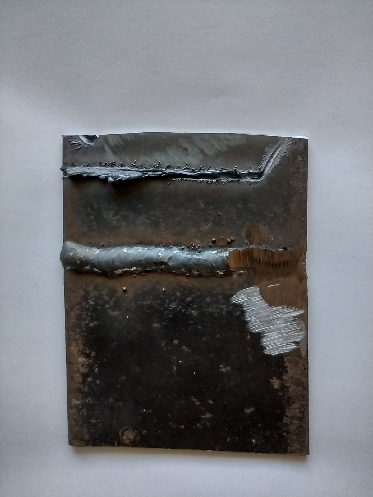

I purchased a CUT-65DS three Years ago and just tried it out. I was getting it assembled and
when I turned it on it’s side I heard a clunk inside. I removed the case and found a loose Coil on the Air Solenoid. I installed it and tightened the knob. I found a loose screw inside and put it in
my parts package. I tried it on 110 VAC, and it barley cut 1/16” steel with the flame 45 degrees
opposite the direction of travel. I then tried 220 VAC in the same piece of metal. I got a terrible
cut and I have attached a photo of that. I contacted YESWELDER and got Raymond. He tagged my CUT-65-DS as OOW since it had been 3 years since I purchased it. I got to thinking about

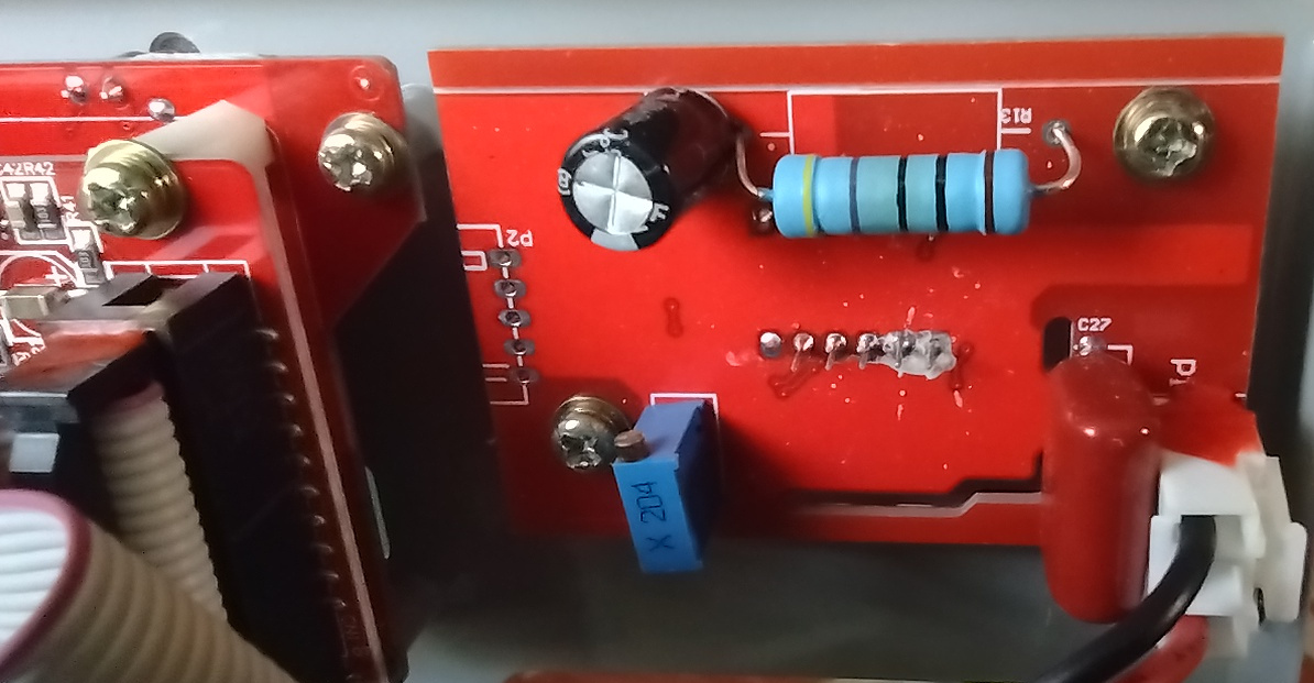

why it wouldn’t cut on 220 VAC while it cut a bit on 110 VAC. I removed the top again and looked
for threads in any empty hole in the PCB. I found one hole that had partial threads showing. Those were connected to a large Aluminum Heatsink. I loosened the other side and inserted the
loose screw in the threaded hole. But the screw wasn’t long enough to hold the part. I located
the small PCB in the upper right corner (looking from the back) and that PCB had 6mm Threads.
I replaced the 4mm long threaded screws with the 6mm long threaded screws. So, now the Small PCB had 4mm long screws and the heat sink had 6mm long screws. I shortened them to about 5.5mm long so they wouldn’t bottom out. After that my CUT-65DS worked PERFECTLY. It will slice through 3/8” bar stock using 220 VAC like Dental floss through Butter.
All because some Tech assembled the CUT-65DS with the incorrect screws to hold the Heatsink
which wasn’t making contact with the PCB. I bet YESWELDER has several Warehouses full of
CUT-65DS Plasma Cutters as returns with the Incorrect screws holding the Heatsink to the PCB.
A Simple 15 Minute FIX once you know what the problem is. So much for Case Histories for a
troubleshooting technique from YESWELDER.

If they were heatsink screws then it would not make it work, unless when you put new screws in it caused what ever is on the heatsink to make contact. This may not last long as I would guess what ever was on that heatsink broke lose from the PCB and is now making contact to the PCB.
George,
I had been looking for a way to contact you from your Website to see if you had worked on a YESWELDER CUT-65DS, for some support. I only found your Phone number.
I wish I had a Schematic of the CUT-65DS so I could explain it better, and you could verify that what was on the Heatsink was the DC Voltage components, being cooled by the Fan. Each Screw that was Originally installed was too short to keep the connection tight to the PCB. With one screw with partially stripped threads the PCB didn’t get the proper DC voltage, therefore making a partial cut with 220 VAC applied to the Cutter. By inserting longer screws I got the full DC Voltage supplied to the PCB from the DC Heatsink, from a tight connection.
If you ever get your hands on one you will quickly see what they did to get the DC fed to the Motherboard.
I’m an experienced Electrical and Instrumentation Tech, who has worked on everything from 480 VAC down to +5 VDC Power Supplies, excluding 480V Lighting, Glycol Systems, and HVAC. I do have an HVAC Certification that I got after retirement.
Thanks for your Plasma Cutter support.
Larry Kraemer
Larry,
If you got my phone number then you can call me 9 to 6 eastern time.. Pictures of the board and the components that are on the heat sink would also help.
