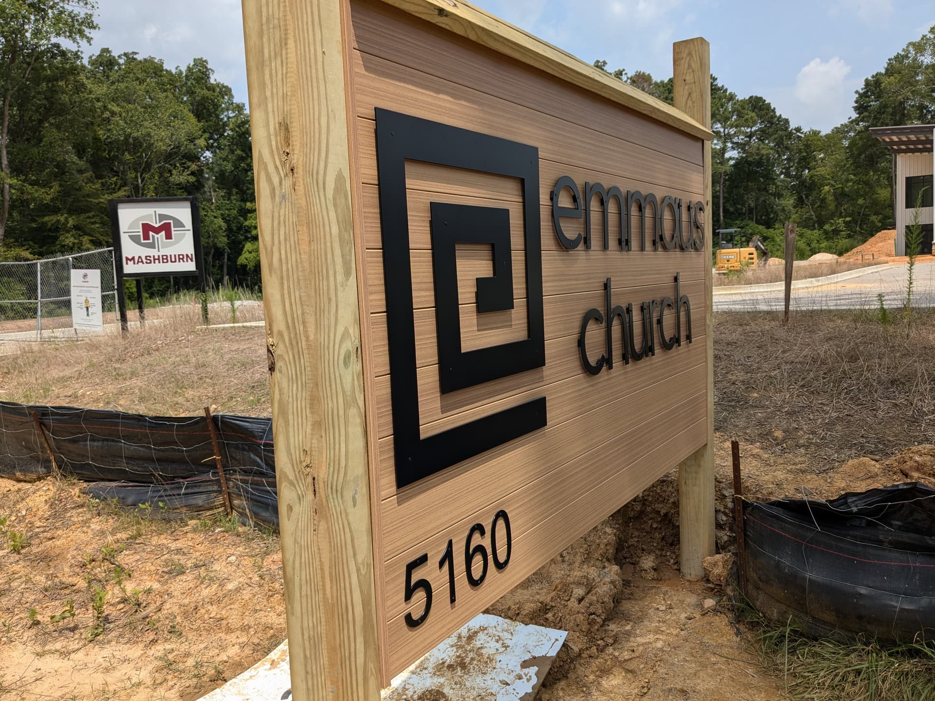

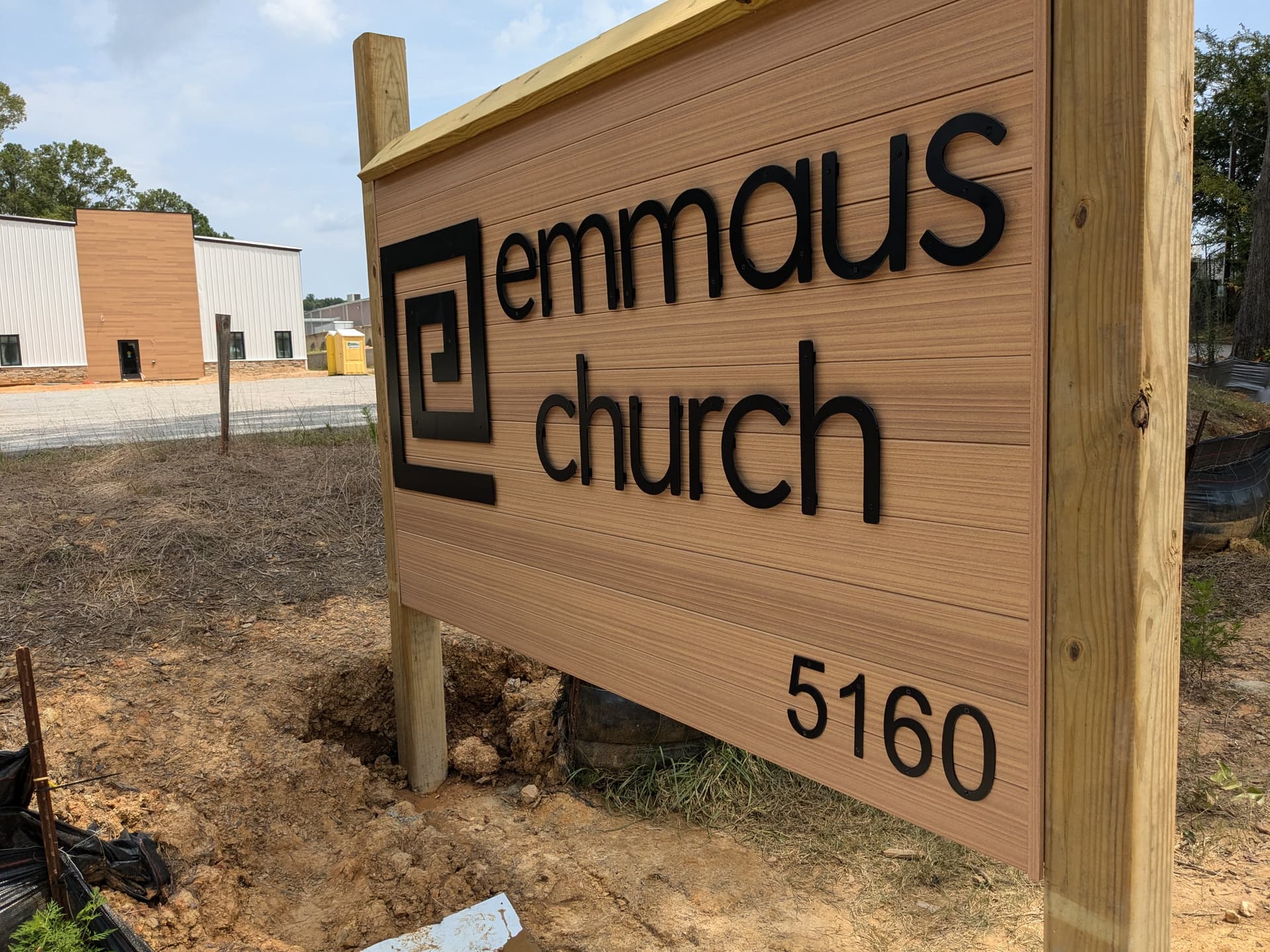

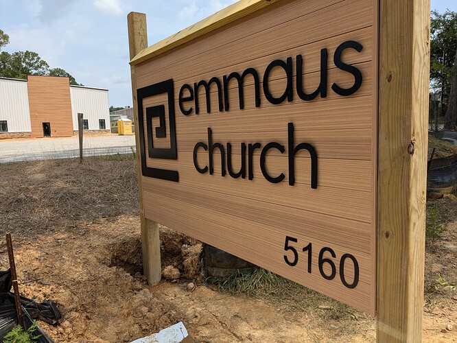

This job convinced me that I needed a plasma table, I actually sub-contracted a friend out of state where we used to live to cut it out then had everything powder coated locally. I designed this and used Deepnest.io to nest this and worked really well. I’ve also used Deepnest on numerous laser and router projects and for an open source application I’ve been impressed what it has done so far. I’ve learned that if you start off with a sheet either to small or to larger for the quantity of items you have and then iterate the sheet size you can get better optimization.
That looks really nice! Hopefully the 4x4 or 6x6 don’t rot off at the ground like most of them do!
nice work.

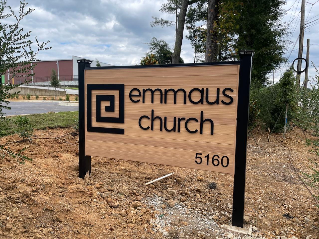

Thanks Guys, I was responsible for the metal work :wink: and yes it’s 6x6 and pressure treated wood isn’t what it used to be, they did concrete it in very well. They made a few modifications to the framing after I finished. Here’s what was sent to me as the final product.
Ya pouring them in concrete will shorten there life even more. They do look sharp painted.
How did you attach the letters to the wood?
No matter how long the posts last, That is one sharp looking sign, nice Job
Put a pic of that on your website if you have one, that will get you business!
@Knick Thanks, the sign facing is actually metal panel strips that look like wood!! I used stainless steel with a black finished head metal screws, the letter standoffs are rubber grommet pads I made from a very thick horse pad material you can get from Tractor Supply. It was leftover from making floor and bed mats for my side by side, works great.
