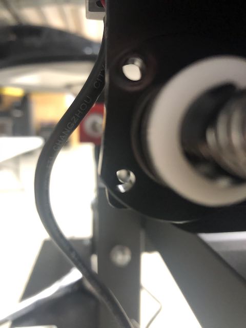

I took the lead screws out and noticed the screw is not going down the center of the support. That makes the lead screw bind up against the lead nut. I don’t know if this is correct or not, but I would have to put the lead nut in a bind to secure it.

@jamesdhatch I did loosen the screws and saw quite a bit of movement in the screws when it got down closer to where it binds up towards the stepper motor side.
I took all the screws out, checked the collar and it is free, the lead nut spins freely on the screw.
You can noticed that the lead nut holes are not really close to being centered with the mount on the Y-Axis bar. The lead nut has to be pushed over towards the Y-Axis bar to get the bolts in, which does in turn push the screw over that same direction since it is resting on the outer side of the mount.
Not sure of what else to check for, if there is anymore alignment tricks.
Did you try spinning the mount around? The flat side of the plastic mount should be flush against the side of the metal mount. It looks like it’s about an eighth of an inch too far out.

@jamesdhatch I have spun it every which way lol. You are correct, either flat side is not flush against the mount. The screw is pressing up against the welded mount and to get the screws in the holes you have to push the plastic mount over onto the welded mount holes. Puts the screw in a small bind.

Time for a note to Support. Or drilling the holes out a bit oval to give you the horizontal adjustment you need to line the plastic up and stop the screw from binding.
