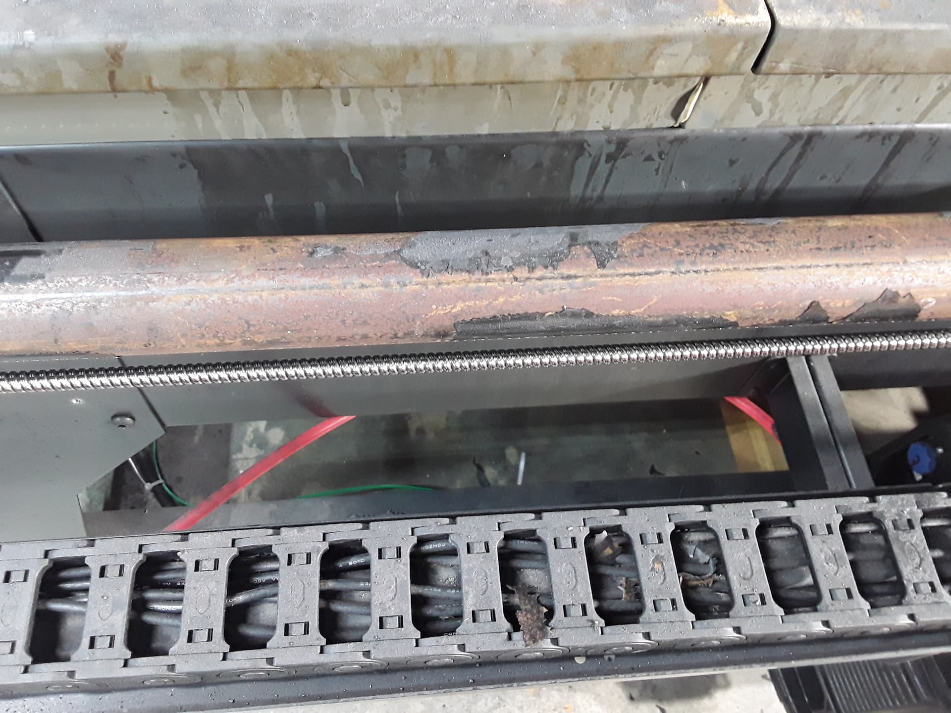

Y axis Round tubes starting to flake the finish off
I have some of that too, but does not seem to effect anything. Now I did have some of that paint flake off and stick to the bearings on the X axis and I could hear some noise, but did not really notice anything in cuts. I think I might have had my bearings on the X set a touch tight. I don’t think any finish on steel would hold up to the rollers/bearings rubbing in the same spot. Maybe anodizing?

Our Y has already been scraped and dusted in semi flat Krylon. The X axis tubes are a different animal as it seems the material was likely purchased galvanized and top coated, so you end up with a lot more funk coming off the X guide tubes.
i ran some scotch brite with a dab of grease and it helped pull off alot of the crunchy paint and smooth the groove. then i just cleaned it off with a rag and it seemed to run a bit smoother.
Same issue with the gen 2 looks like rusty exaust pipe

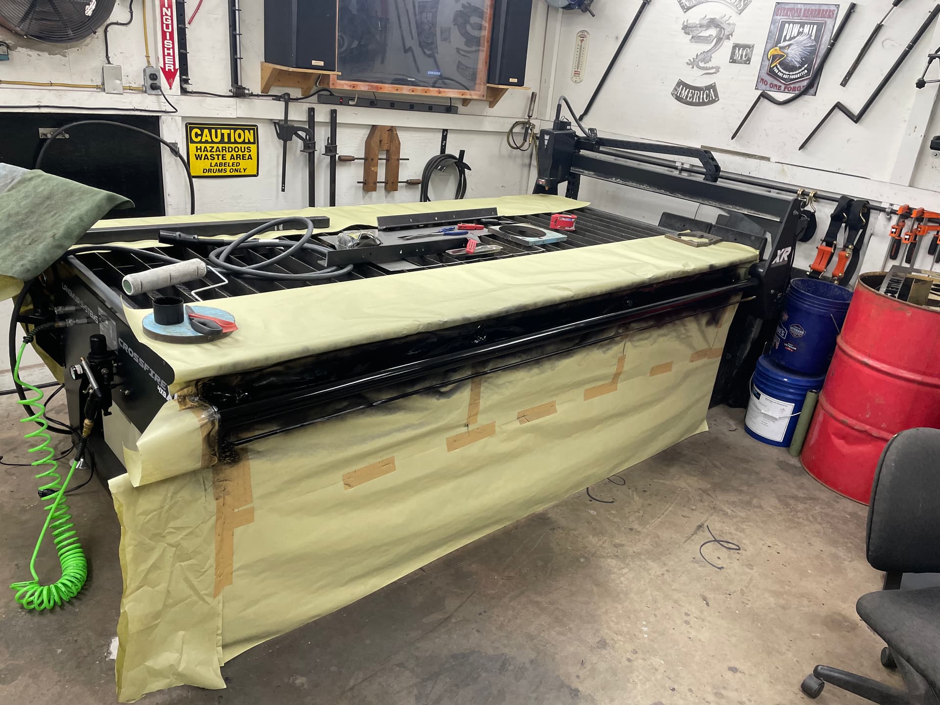

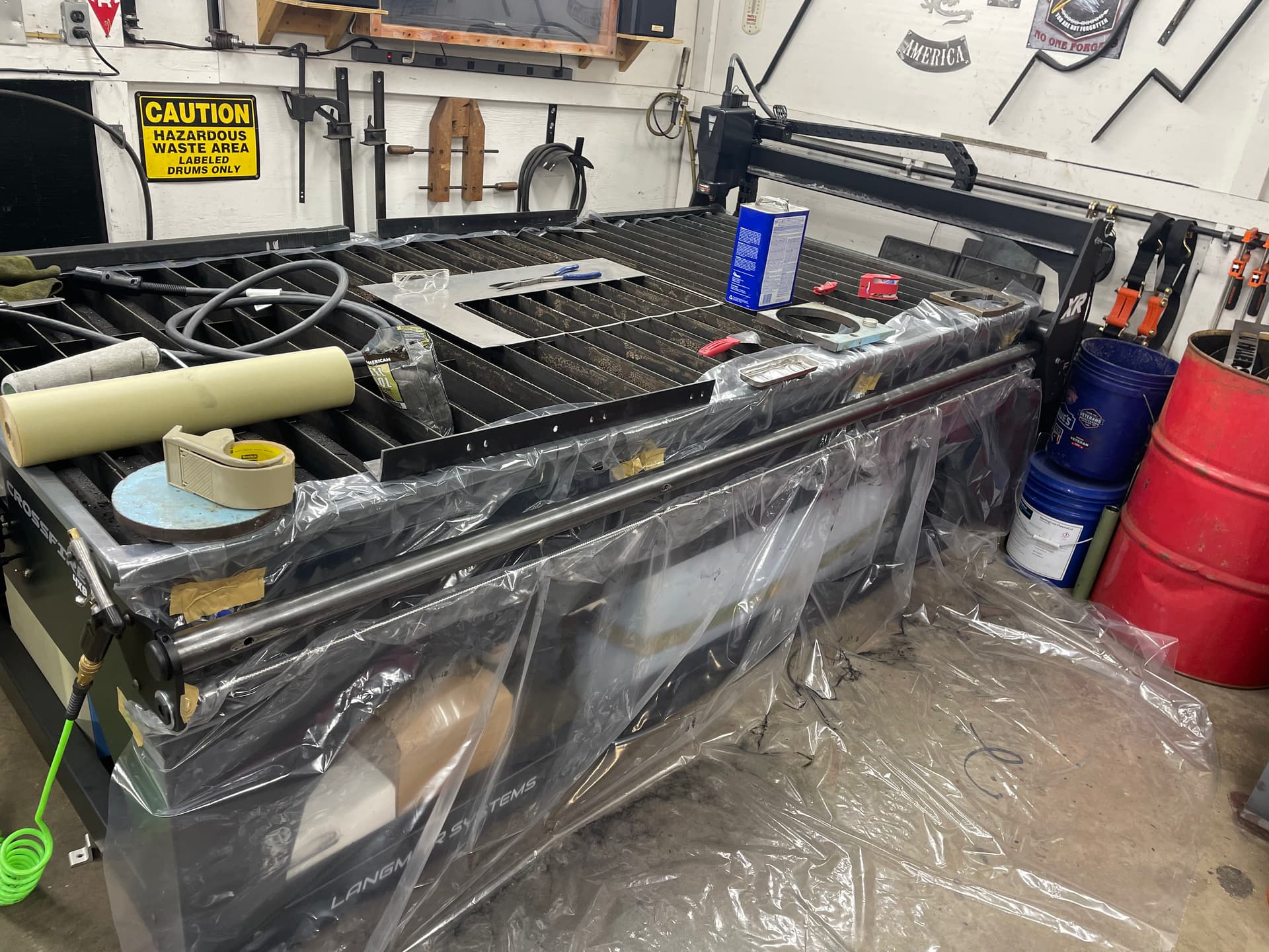

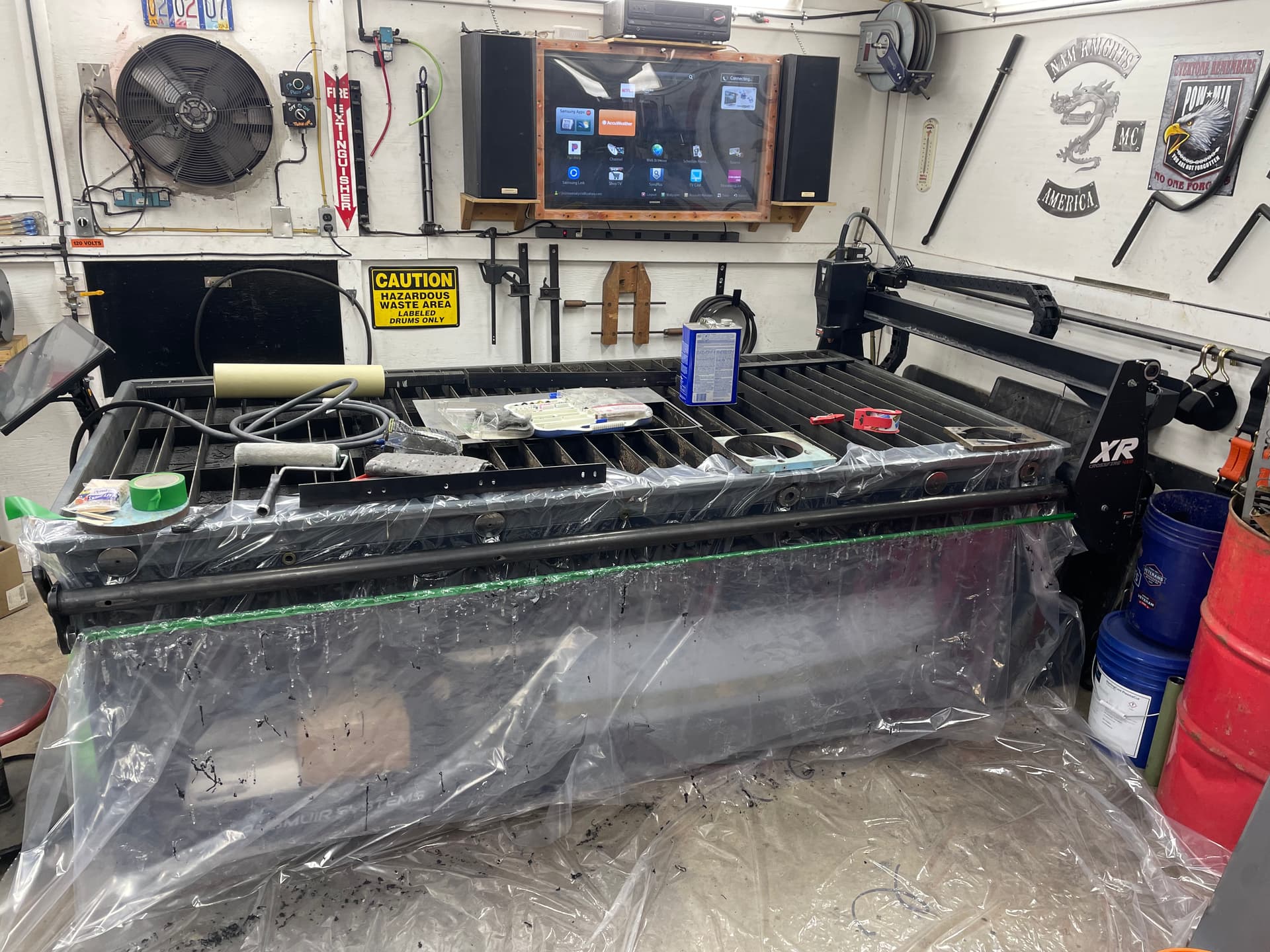

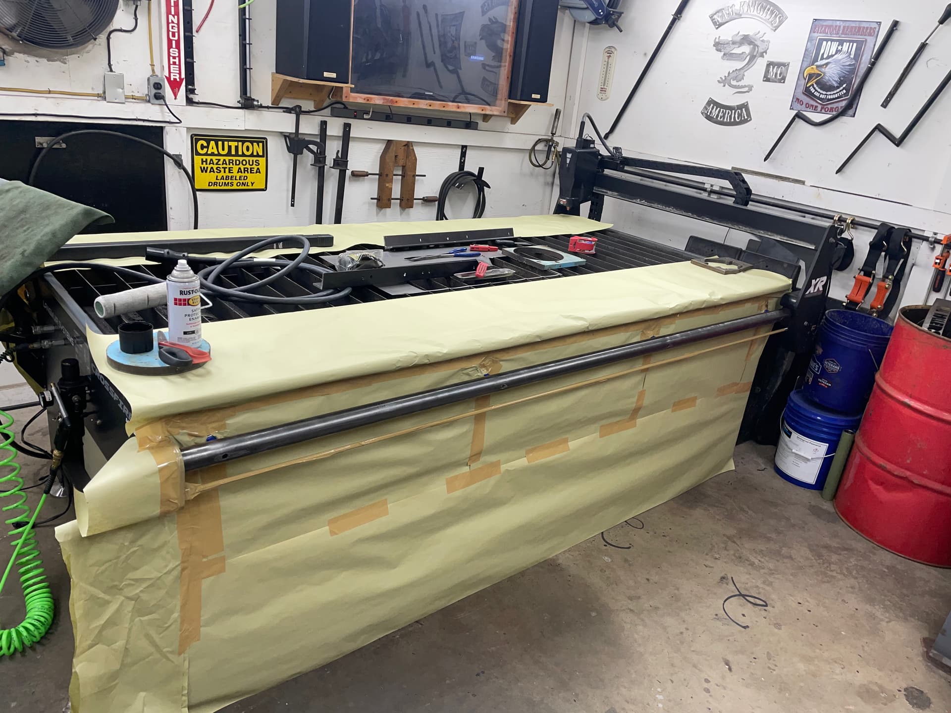

I have been dealing with this the last few days. Decided to strip all the powder coat, scuff and sand (120/240/400 then 000 steel wool. I know it’s probably overkill) and repaint with enamel paint. It should wear through the paint pretty quick and leave the rest of the tube protected.

Another paint tip is aluminum foil. I have worked with automation assembly equipment and some large GM assembly lines were being refurbished and that was the trend… Not everywhere but on some tricky spots foil works well.
If you get the gifted gator skin off you will be good.

@autotech Thanks. Thats a great tip. I’ll have to remember that for next time I paint
