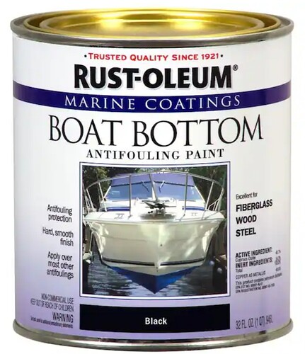

I don’t have the XR, so I can’t really say what others do. As far as paint, I might consider something that is meant to be on the bottom of a boat. I did a quick look on home Depot and this is such a product.
But, you might wait to hear from others. This “anti fouling paint” leeches copper into the water to limit algae and barnacle growth. I don’t know if that sets up a harmful situation with the plasma stream.
Another concern is that is the plans stream hits the painted surface, I am not sure if will survive and you will be back to exposed metal.

I agree on the rust-oleum paint. Clean well and let the paint dry as long as you can ( 2 weeks would be great) and you will have a very durable finish.
