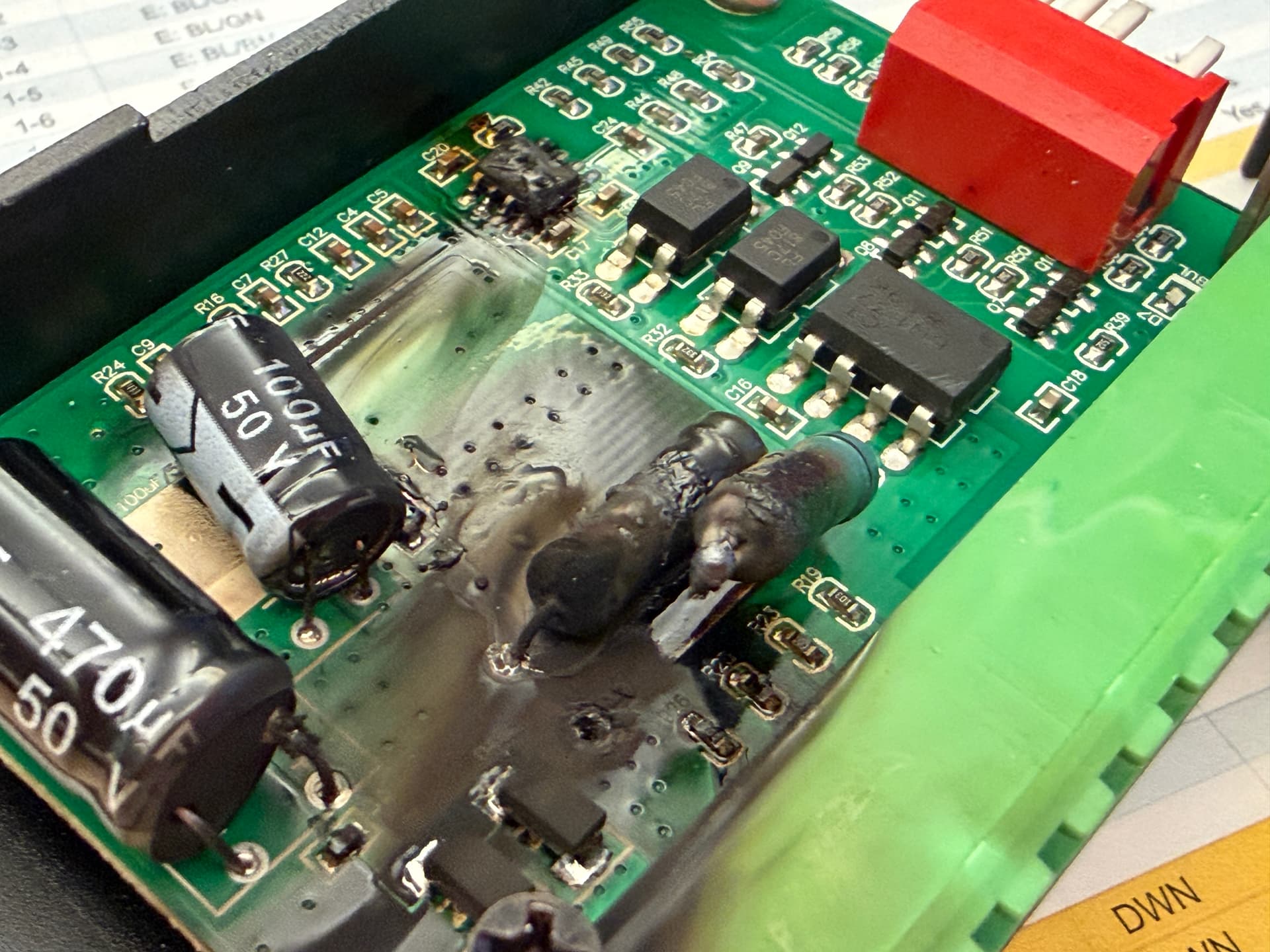

I had the Z Axis driver blow up. I replaced the Z driver and plugged the motor back in. I then went into FireControl and manually ran the Z motor up and down fine a few times. Without powering anything down I left. When I came back later it was blown up. I could smell it and manual operation from FireControl failed.

Nothing has changed for the past two years. Been running great. Few days ago driver blew up. replaced driver and went boom again. Inside electronics box looks fairly clean all things considered. Figure my next step is to check power supply, although I would think the other axis would have a problem if the supply was bad. Then check for shorts in the motor cable. Odd it ran manually for a few up/down motions after i replaced the driver the first time.

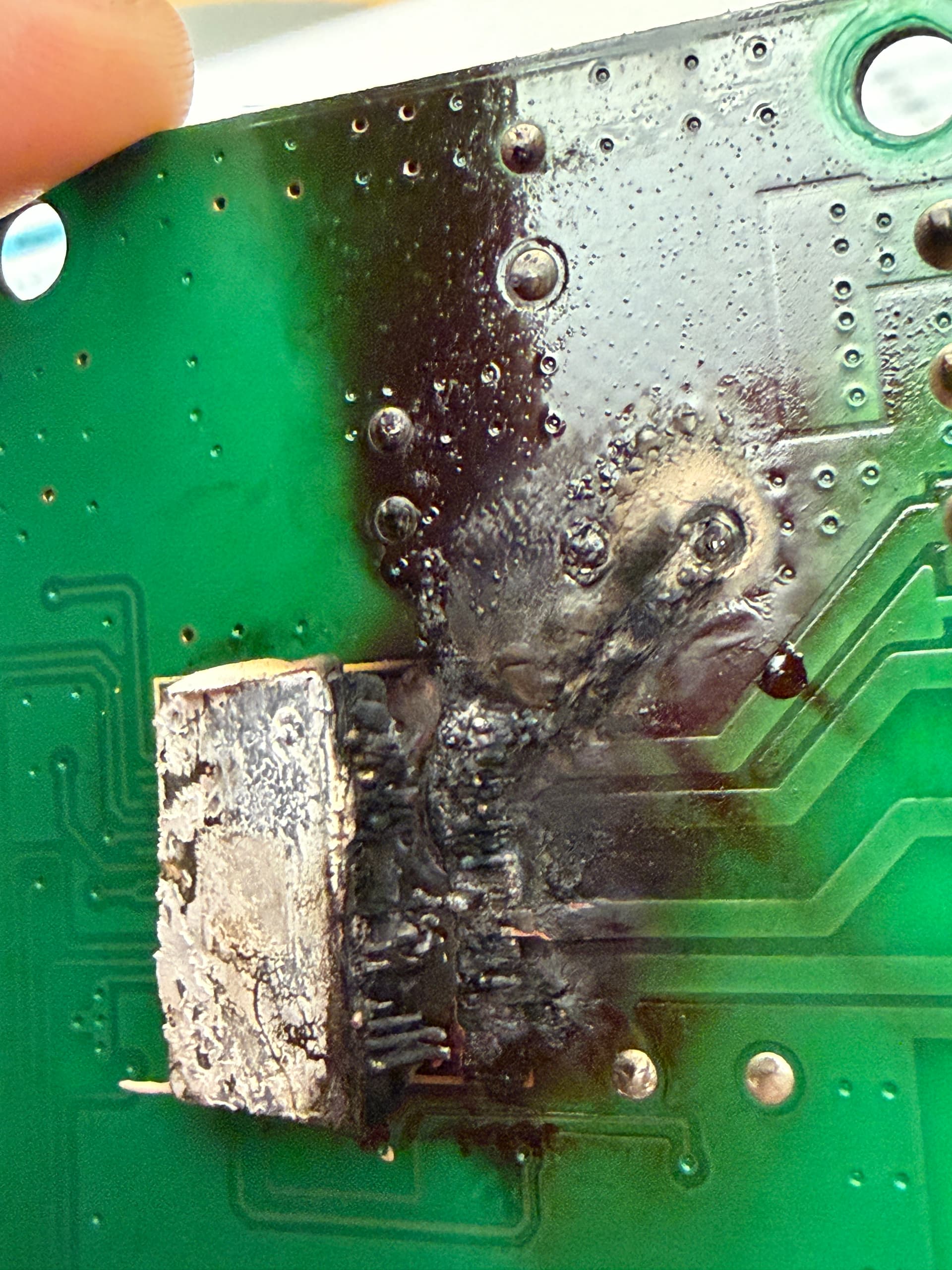

I pulled the new driver out and opened it and it is not blown up like the last one and the LED is on but it still does not move and there is a smell of electronics burning still present.

Send these photos back to the tech that built these boards ( if possible). The tech may a short history written up on this exact problem. I used to keep a repair history notebook of circuit boards I built for a 110v & 220v generator system we used to build. Once I knew exactly which parts blew up (as you said) I could almost always go backwards from there to see what typically failed with 80-90% certainty where the real problem began that caused the catastrophic failure of certain components. Not a perfect system, but worked a lot of the time, making the repairs simpler and minimizing downtime.
Stepper motor drivers are generally constant current output, which is set by some switches on the board. To burn up the board like that, usually has three different failure modes.
  1. The power supply is failing, and the output voltage is (perhaps temporarily) going too high for the board to survive.
  2. The big many pinned integrated circuit is the controller’s brain and it MUST be properly attached to a heat sync to keep it cool enough to survive on its own. The burned-up controller chip may indicate failure to keep it cool.
  3. You are getting a lot of external nearby electronic noise causing the driver electronics to turn on UP and Down at the same time which will burn up the board in a few seconds. The burned-up resistors in the picture appears to indicate a huge amount of current going out to the motor. Those big resistors measure the current to the motor.
