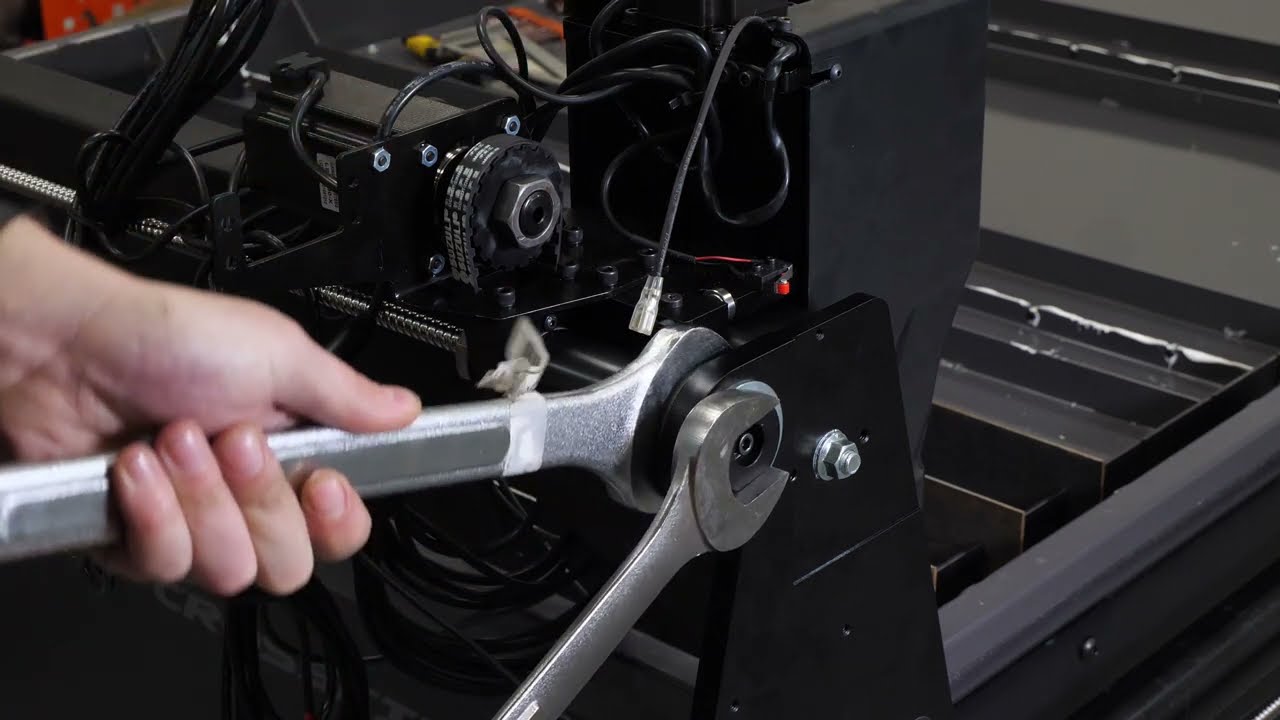

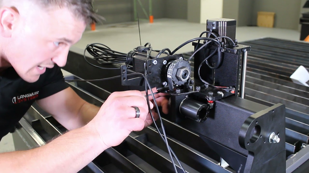

These?
Taken directly from the XR assembly instructions.
I’m sure an XR owner can elaborate farther if those videos don’t cover it.
          Thanks for reaching out. Yes, I’ve seen these videos online. I was hoping for a few more details, like torque specs and so on. I have watched these videos and am about to start on the Y-axis. Have wondered why Langmuir has used such a mix of metric and Imperial hardware. I am using the assembly of the XR and learning the programming as a stepping stone. Does Langmuir buy their sub-assemblies from suppliers inside and outside the US and just sell the kits? No problem either way, I’d like to know more about the company itself.
