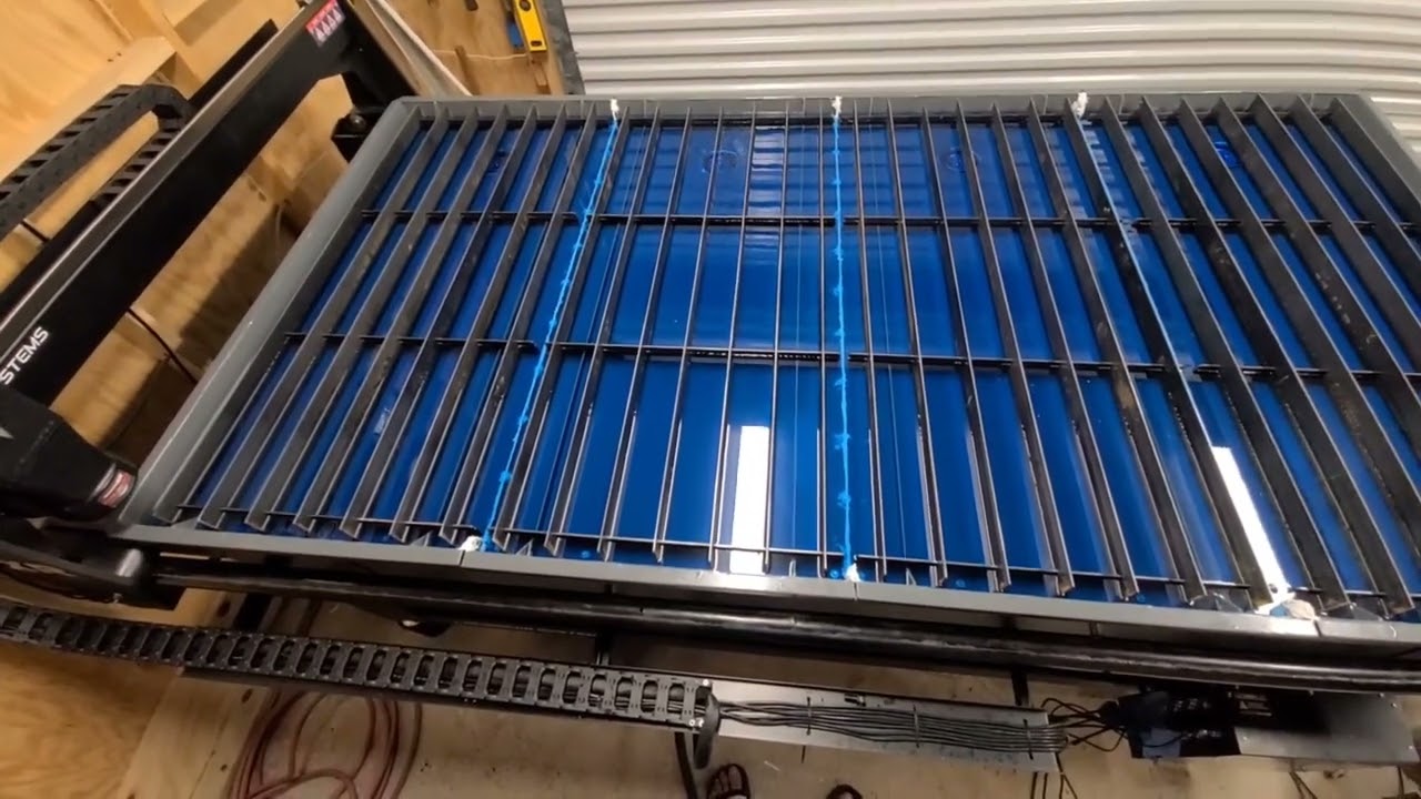

Current status on building XR delivered 3 days ago. A lot of work + extra to add the water storage but figured do it before the water tables were installed. Hats off to OxMadeFab for all inputs !.
We also added steel casters welded to lower channel and just raised the leveling pads so they are flush with top of the welded in nuts on end plates. They just sit on spacers to get the engine hoist under ( 7" min). When we want to move it, Just elevate with a floor jack and kick the spacers out. roll it back to marks on the floor and back level.
After elevating the frame on spacers we went into leveling, easy part. the potential skew on the table was a little concerning as it seems the water table was designed to keep it all square and maybe how its just designed to sit in one spot. We squared the table on diagonal measurements then welded the seams some on the top end plate and large formed C channels to ensure no movement, followed by some simple flat gussets on lower members in corners.

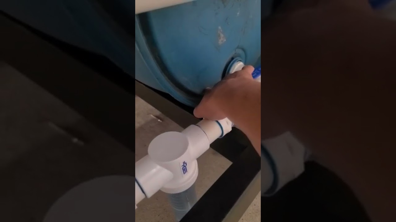

This is the drum we found 55 gal termed : “Tight head drum” not a pickle barrel etc. $20 ea on Craigs-list ea.
It is a sealed style lid the lower bung has 3/4 NPT female port not punched out, so drill out under the NPT tap drill size . The upper plug is thin so planning on tapping 1/4 NPT get it snug then a backer 1/4" coupling with o-ring so we have some compression. on the thin wall.
A lot more this afternoon on the tank fitment welding in the support bars for barrels etc .( OX made it seem easy but we didn’t want wood ) It will take a little time and doing it before the WT is in place is way easier delays production ~ No pain- no gain we hope , Keep it + K
Here are a few more images of frame stiffening the drum supports and drain fittings.
There is also a large 3/4’ NPT sediment filter not in that Lowes receipt $ 30+
In that PVC mix we also have two 3/4" PVC coupling disconnects. We will have to update if we use them thoughts were if we think the tanks are getting debris we could drain down . Floor jack one side high to get barrels out clean and flush and re install.So tempted to paint over the branding … Lets see how it fires up and runs…
