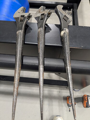

To align the frame I used Spud Wrenches in the Red outlined holes and hand tightened the 2 bolt locations in Green. This for me worked great and then leveled and squared up the frame.
Spud Wrenches
Bolt Locations
Example of some of the small holes lined up in opposite corners.

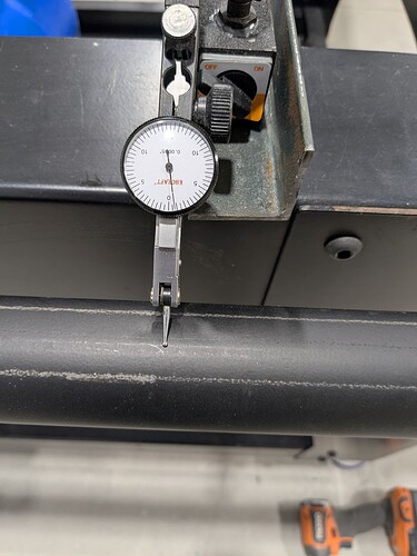

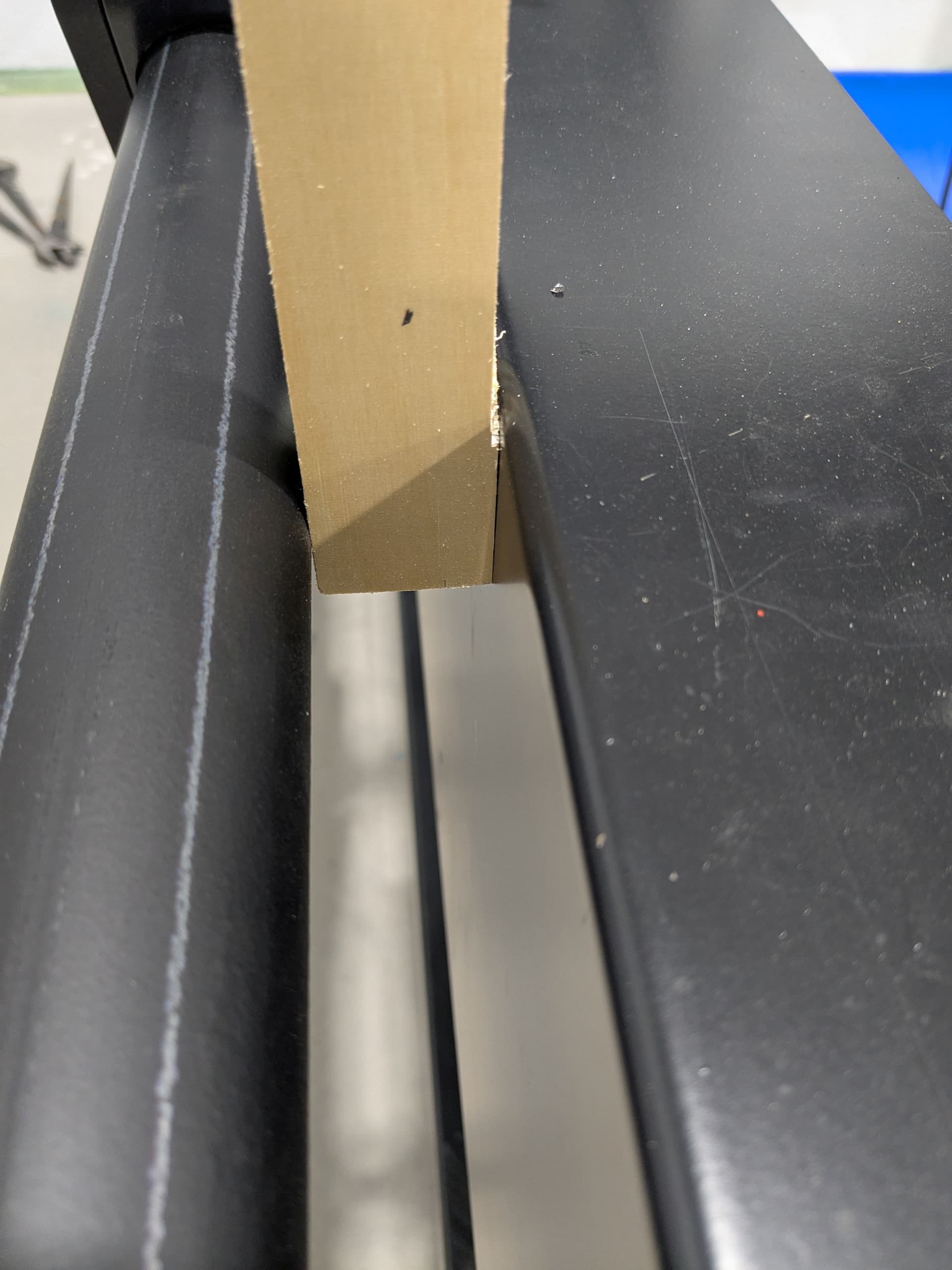

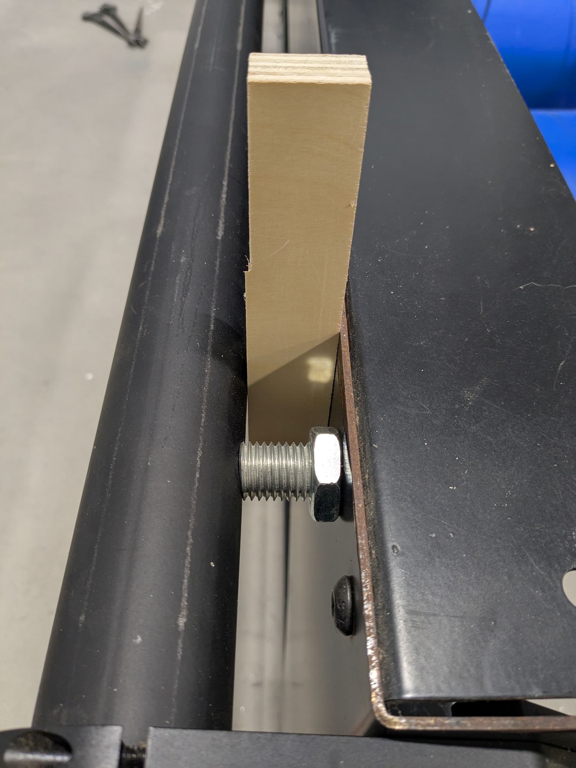

After this it was time to do the Y-Axis Rails. I used some Blue Loctite on the 1/4"-20 socket cap screws for the rial stabilizers and made sure the “fish mouth” mouth was seated correctly. I made a wood gage block for the 1.25" using dial calipers for all gage blocks. Slightly tight the 2 ends so the gage block fits, then I dialed in the height of the rail at the ends with a piece of angle iron across the entire table.

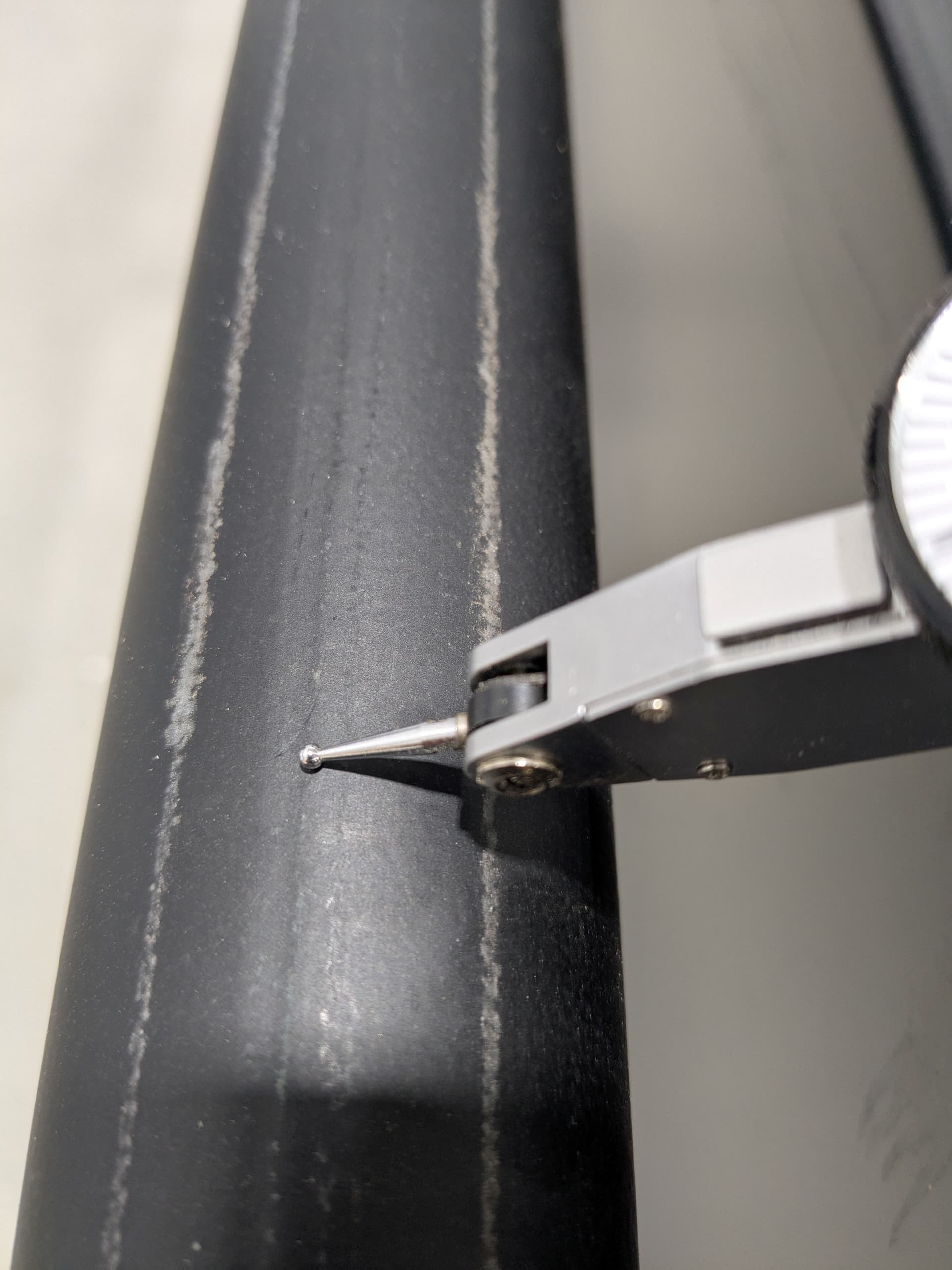

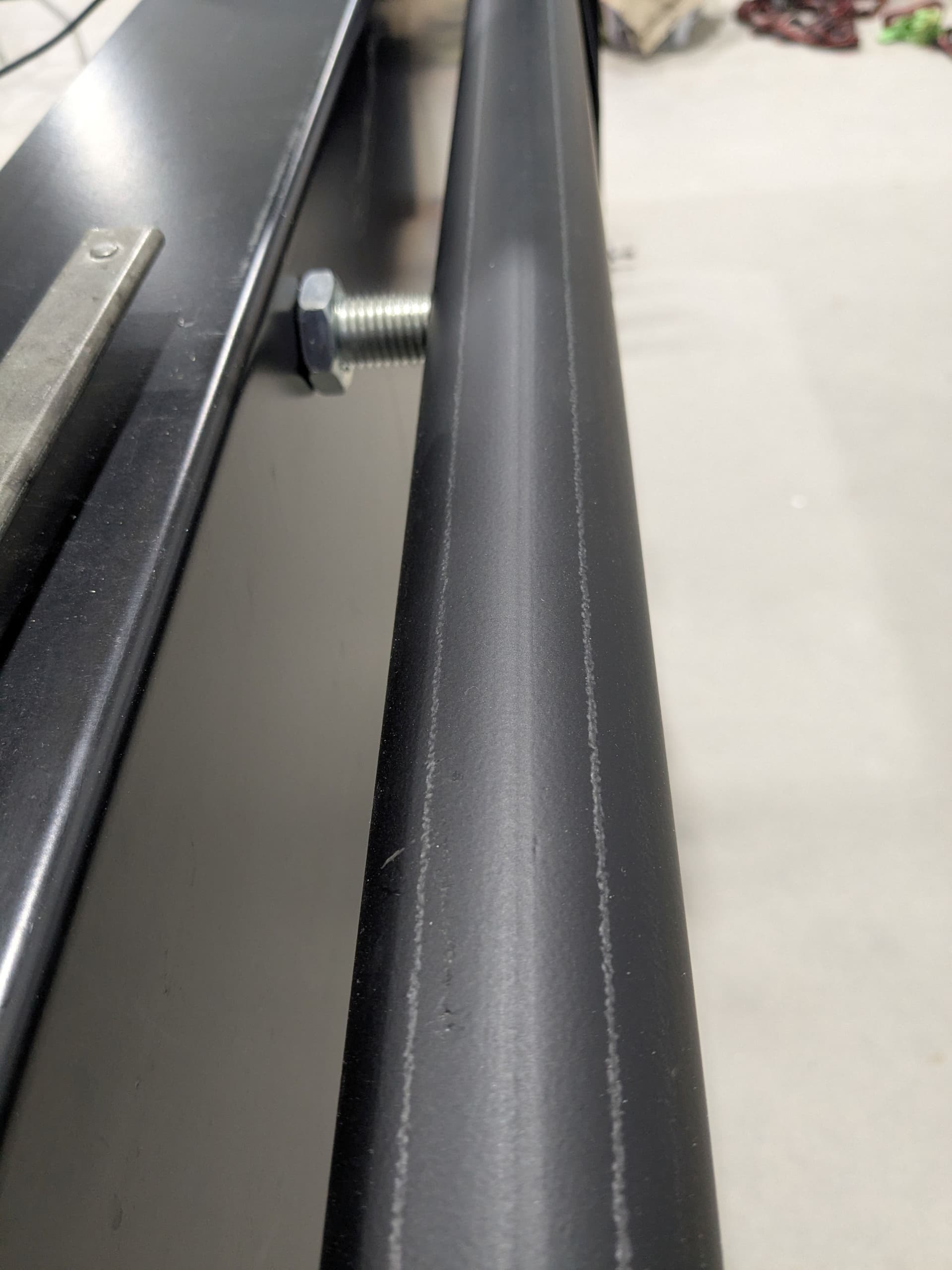

Note: these rails are seam welded tubes, one side will seam up and the other side seam down. On the seam up side note the location of the dial indicator here.
Once I had the ends dialed in of the first rail I set the other side up using the same method, I just carefully lift the angle iron over and flipped it over to the other side making sure that the height of the rail was the same.

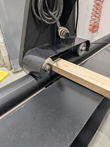

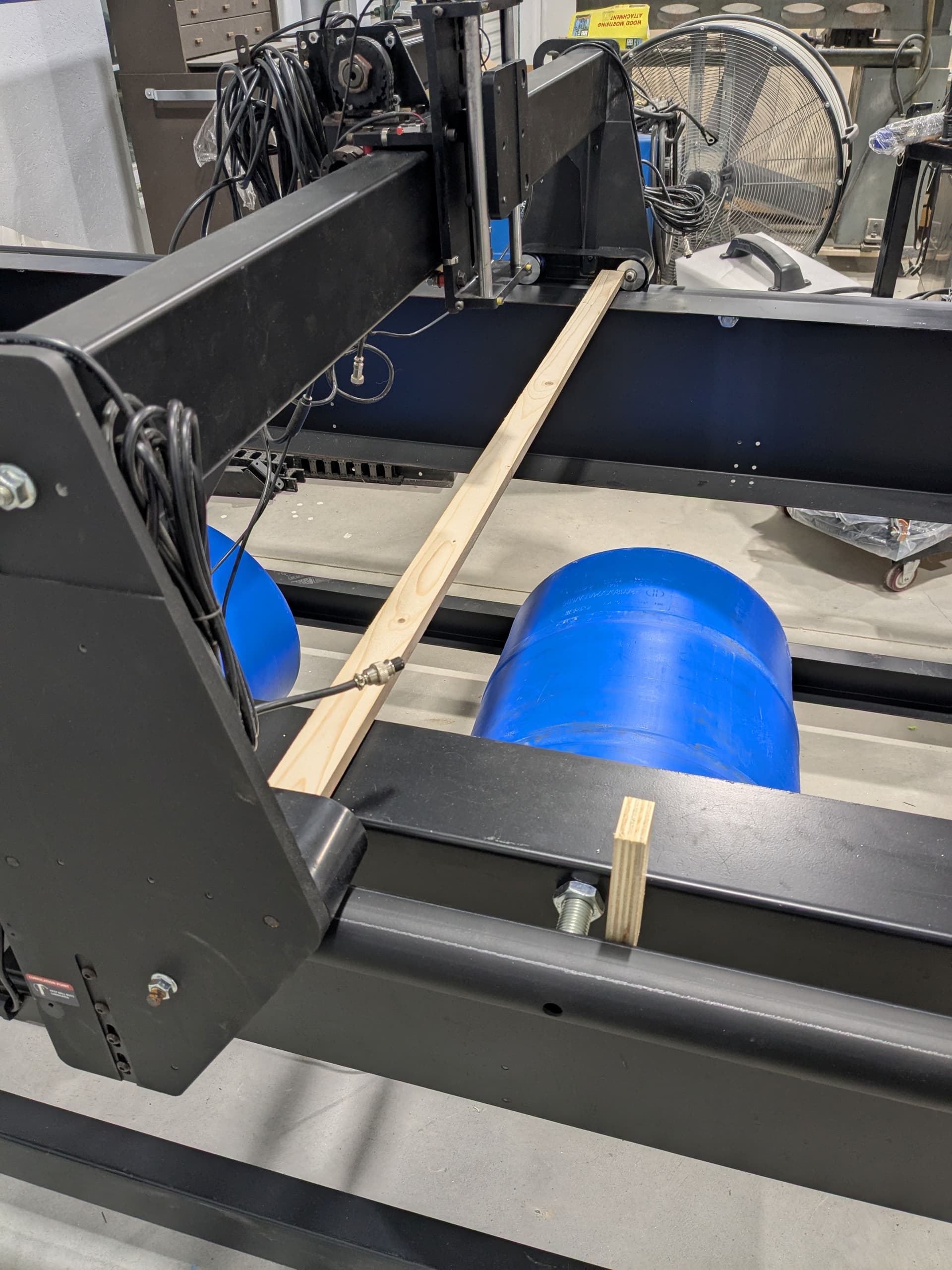

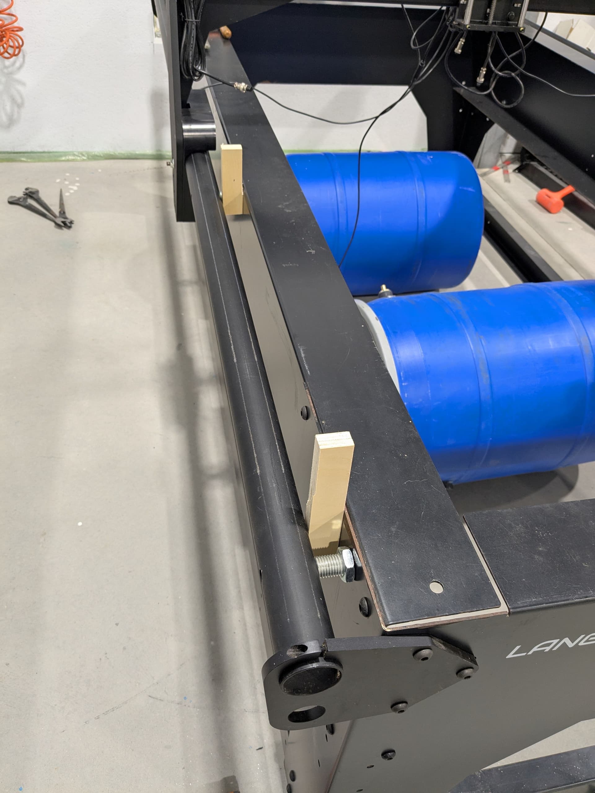

Measuring the inside of the wheels of Gantry I found to be rather difficult by myself so I made another gage and measured it then added the 1.75".
So, to set the middle 2 rail stabilizers I couldn’t just follow the directions as in my mind there is no way these tubes are straight. Made another gage for the left side adding the gage thickness of the frame to the 1.25", set the width and used the angle iron dial indicator setup to set the rail height. The gages made for the other side ended up being almost 1/32" less.

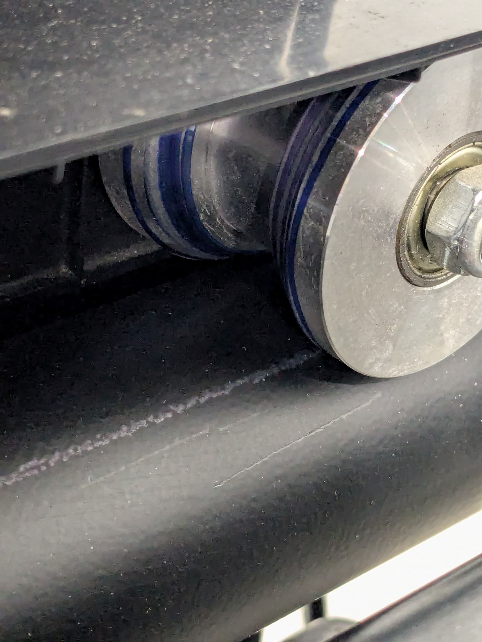

Once the Gantry was mounted I used a Blue Sharpie and painted the rollers moving the gantry back and forth so I could make sure everything was in full contact as seen here:
Checking the Gantry level acros the entire table lenght was very good:
