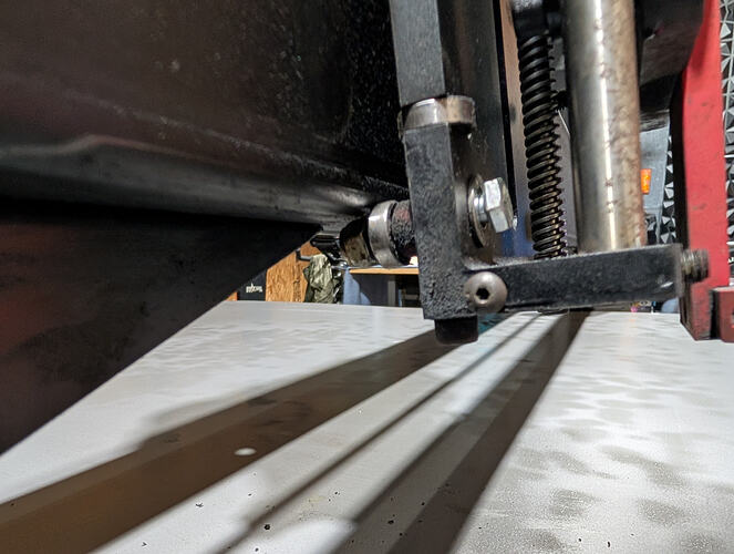

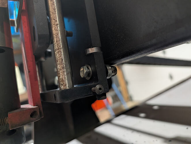

X-Z assembly partially off the gantry
First cut of the day sank into the water table with one end up just right for the torch assembly to catch and actually push the bottom V-rollers right off of the gantry. The top V-rollers seem to be right where they should be indicated by them still on the worn path but the bottoms are pushed out far enough that the nuts on the backside are where the rollers should be.
This part was pre-assembled in the box from what I remember, pretty sure I only had to slide it onto the gantry when I put the table together. What steps should I take to get this back into position?
You need to tram it.
There are set screws you go back and forth with as you add/remove preload for those bearings to get your Z-axis assembly perpendicular to your cutting surface.
I would simply remove the assembly and clean it all up before reinstalling it and tramming.
I’ve had tip ups knock mine off like that several times .
Do it quickfab said and use the Allen screws to back off the bearing tension enough to snap that back on to the gantry.
Then readjust it with enough tension that it glides back and forth without being too tight. Check for square and you should be good to go
As the others have said, but it also looked like the bearing bolts are loose and not even seated.
As others have already stated back out the grub screws to roller adjustment, but also them roller bolts are lose snug up bolt and nut but don’t over tighten bolt and nut. Because when you set bearing preloads by tightening the grub screw it pushes against bolt so bolt has to move, want some tension on bolt.

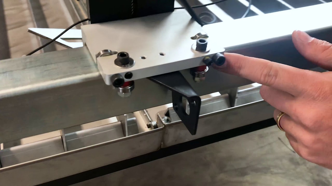

Go to assembly video shows how to tram those bearings.
Thanks for all the replies fellas, lots of good info here. I thought that this was going to be much more of a headache but loosening those set screws gave me the tolerance to simply set the assembly back into place. Gave everything a good cleaning and relubricating before aligning and tightening it all back up. My x-z assembly is trammed and now moving along both axes smoother than ever before.

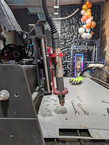

Just in case anyone else has this issue: I had some extra wiggle in the torch head that was driving me nuts until I realized that one (and only one) specific screw holding the torch head V-block to the z-axis slide has an area flattened to dial in how tight the torch is held. I tightened it too much at first and the torch wouldn’t go low enough to penetrate cuts but after backing off a little it’s doing fantastic.

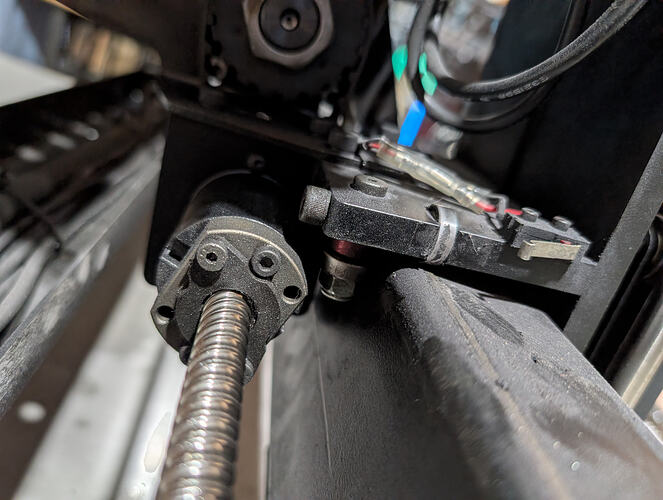

Look at the IHS switch tang, that tang cannot be touching or rubbing on the Z-axis lead screw.
I had to bend mine back into position, it was bent into lead screw during shipping?
