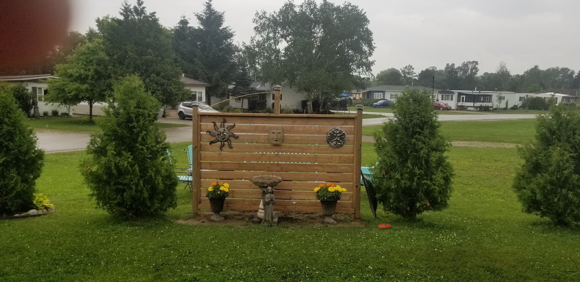

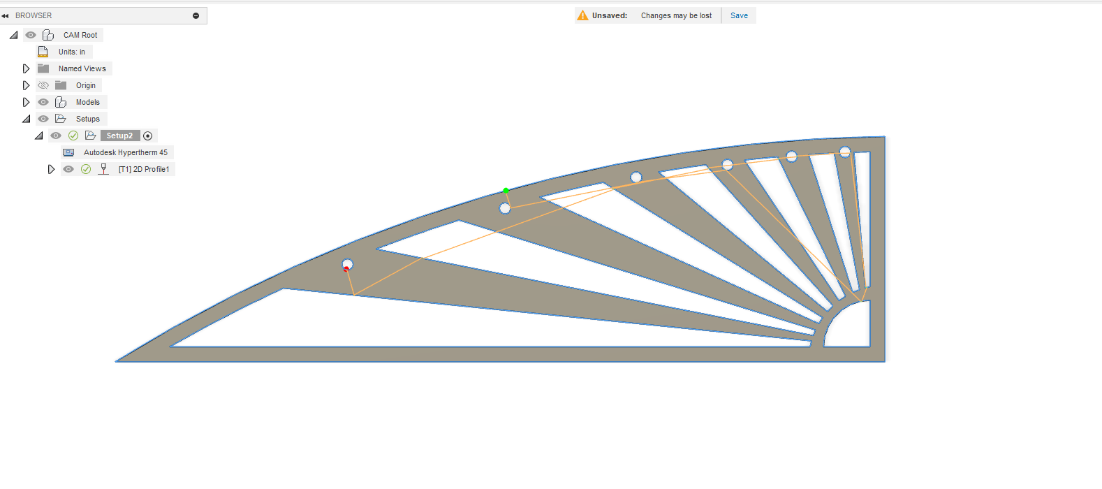

Hello, my plasma table is just for hobby use. And to try and teach my grandsons and anyone else that would want to learn. Have been away from the table for about 4 months due to health reasons. So this is my first project in a while. Trying to make a topper for our privacy fence. Its a sunburst panel. Photos and file attached. Seems i forgot a lot since the last project. Can’t figure out where I going wrong. Unable to generate the g code. Any assistance would be appreciated.

Thank you DonP. I will try again after viewing. I have made quite a few designs in the past. It just that Fusion 360 seems a little different this time.
I can generate toolpath without issue…
I have done some progam updating as you suggested. Will try again.

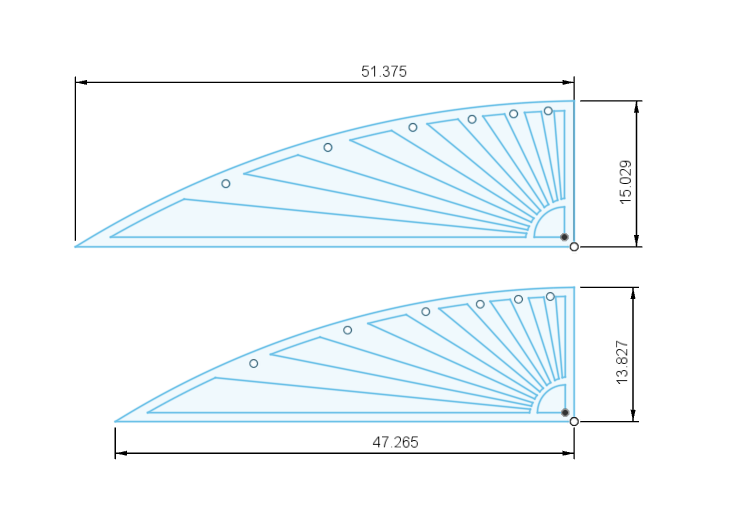

Just FYI…unless your index cutting which is tricky you’ll want to change the size of your fence top. It looks like it’s 51".
Thats correct I have never done indexing but was willing to try. Have been at this for 4 hours. Setup is good , But the Nc program is still coming up no operations.
Let me send you new DXF. do you want me to change size to 47" so you can cut it?
Thank you would appreciate. Yes you can adjust the size.
Your original is on top and new resized one in bottom. Look over measurement differences. Wverything was scaled down 7% in size so even the hole sizes have changed if those matter. See if this will work for you…

Thank you yes that worked no problem. I will compare your setting to see if i can figure out where I went wrong. This is is just a little added touch to the top of the fence for my wife of 56 years.
