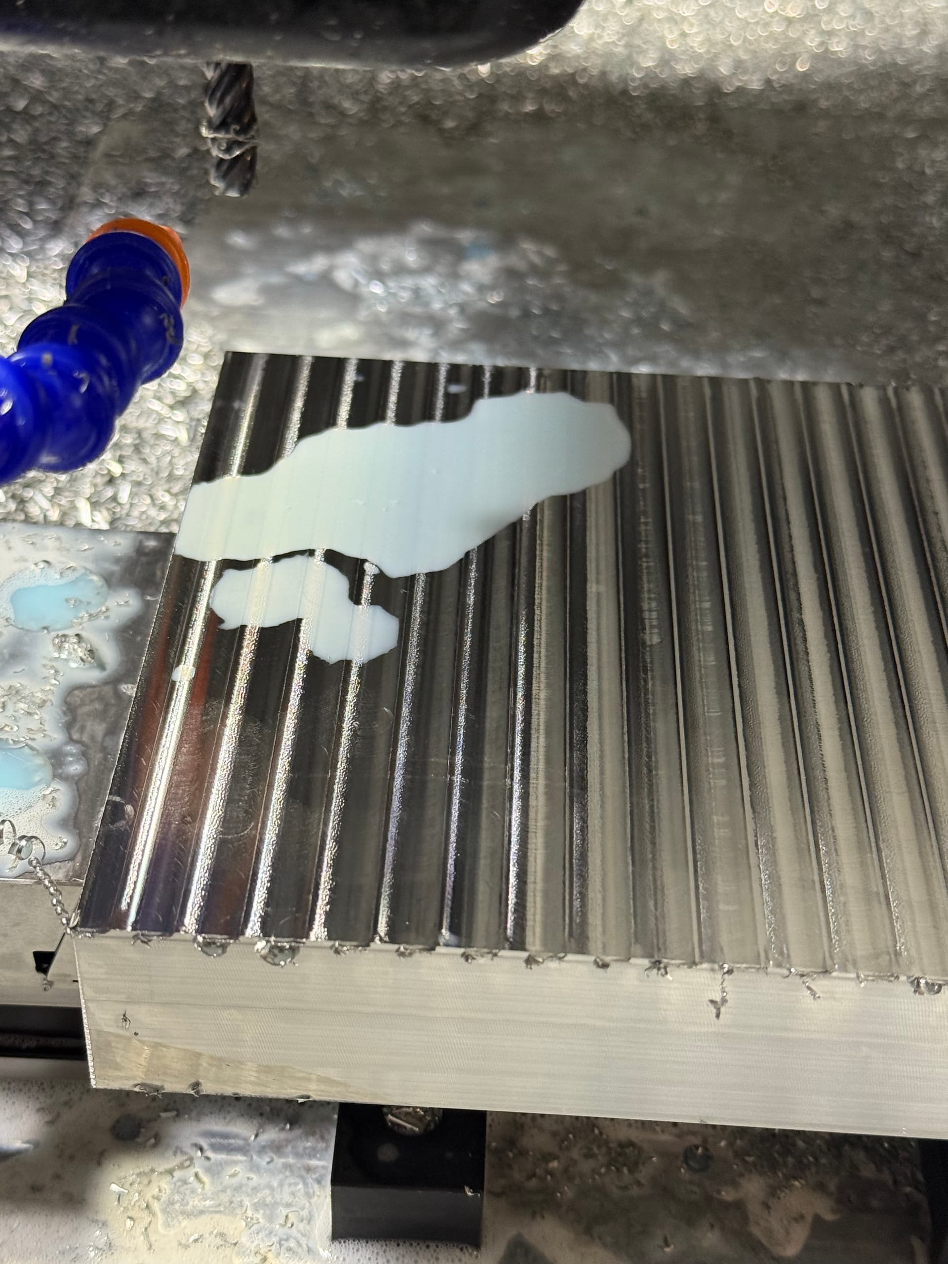

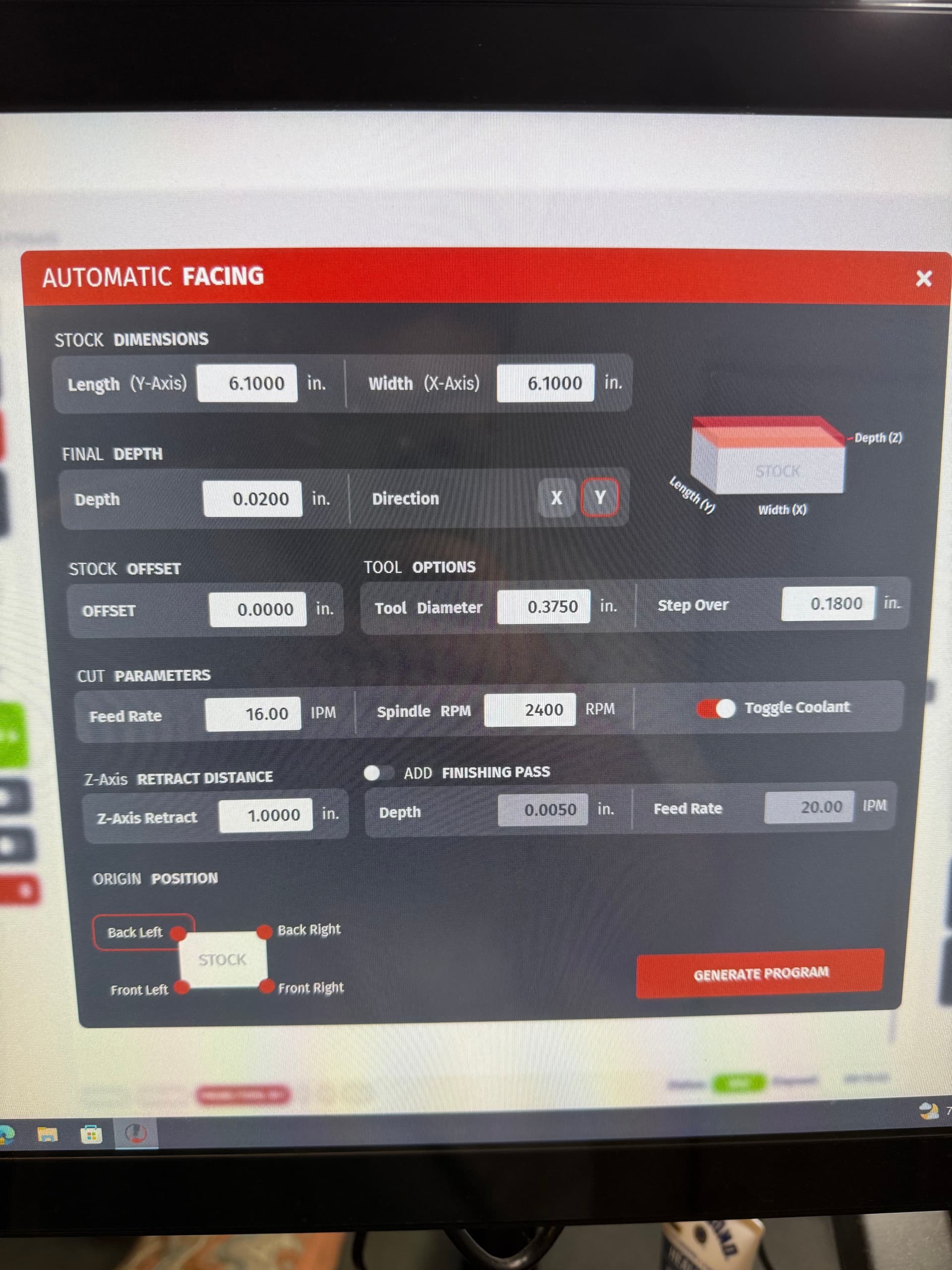

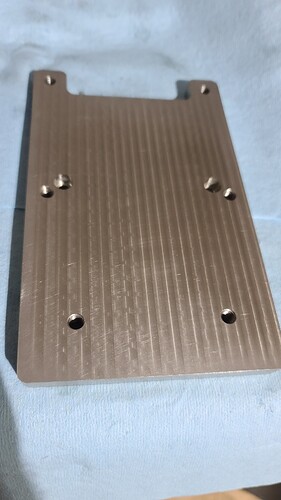

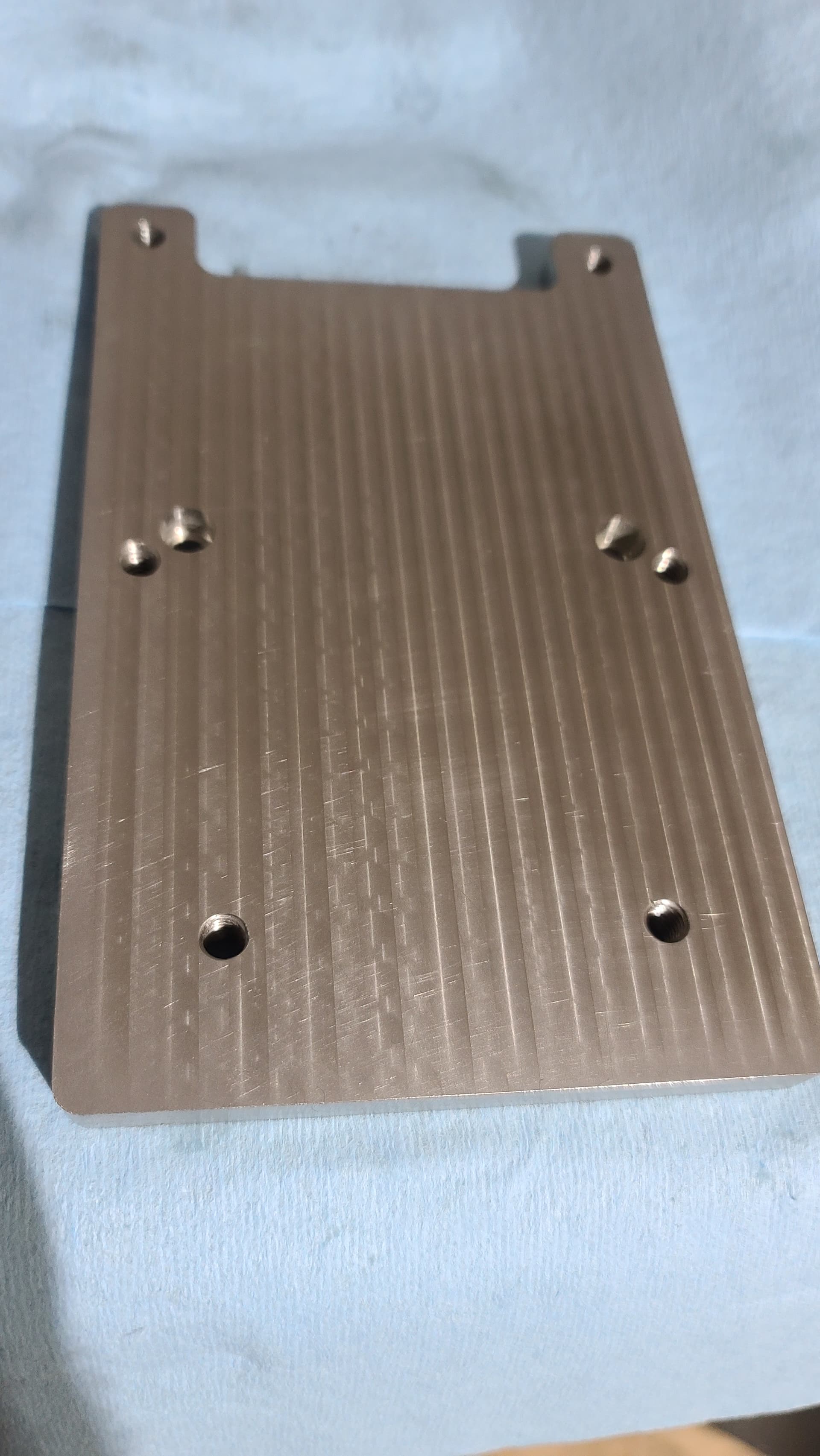

Hello guys, thank you all for your information. I decided to purchase a 3/8 "Carbide Endmill, 5-flute TiAlN Coated Square profile with a 38 Degree flute angle from Haas. It cut my stainless steel perfectly, and with no vibrations, it was awesome to see it work. I will leave the facing parameters and outcome below.
Well done. One of the more difficult materials to work with, and you’re well on your way!
Nice! Good to see you got it done! Thanks for sharing the results.
