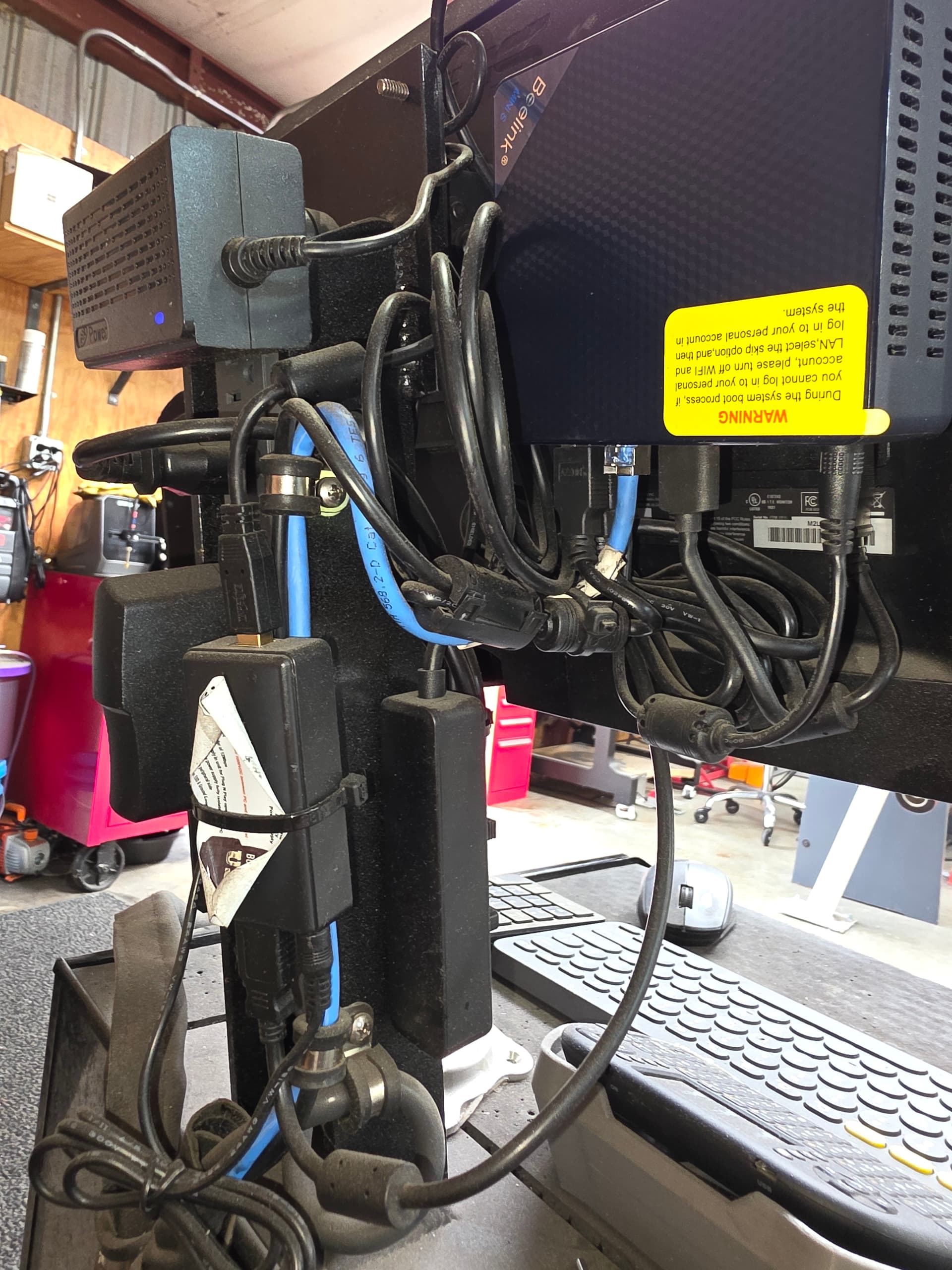

Buy a mini computer. These work fantastically for the table. They’re fast and have a 1TB hard drive. At $179, it’s a no-brainer.
Beelink Mini PC Amazon.com
If you decide to order it. Please buy this one. It is a non powersaver cpu chip that won’t screw with the USB power output to the control box. The upgrades look tempting, but they may have a chip that will control the power to the USB.

Any Intel N100, N150, or N95 computer is good for table control.
The one I posted is the perfect example of an excellent pc.
It will run the plasma table, the MR1, and almost any CNC control.
