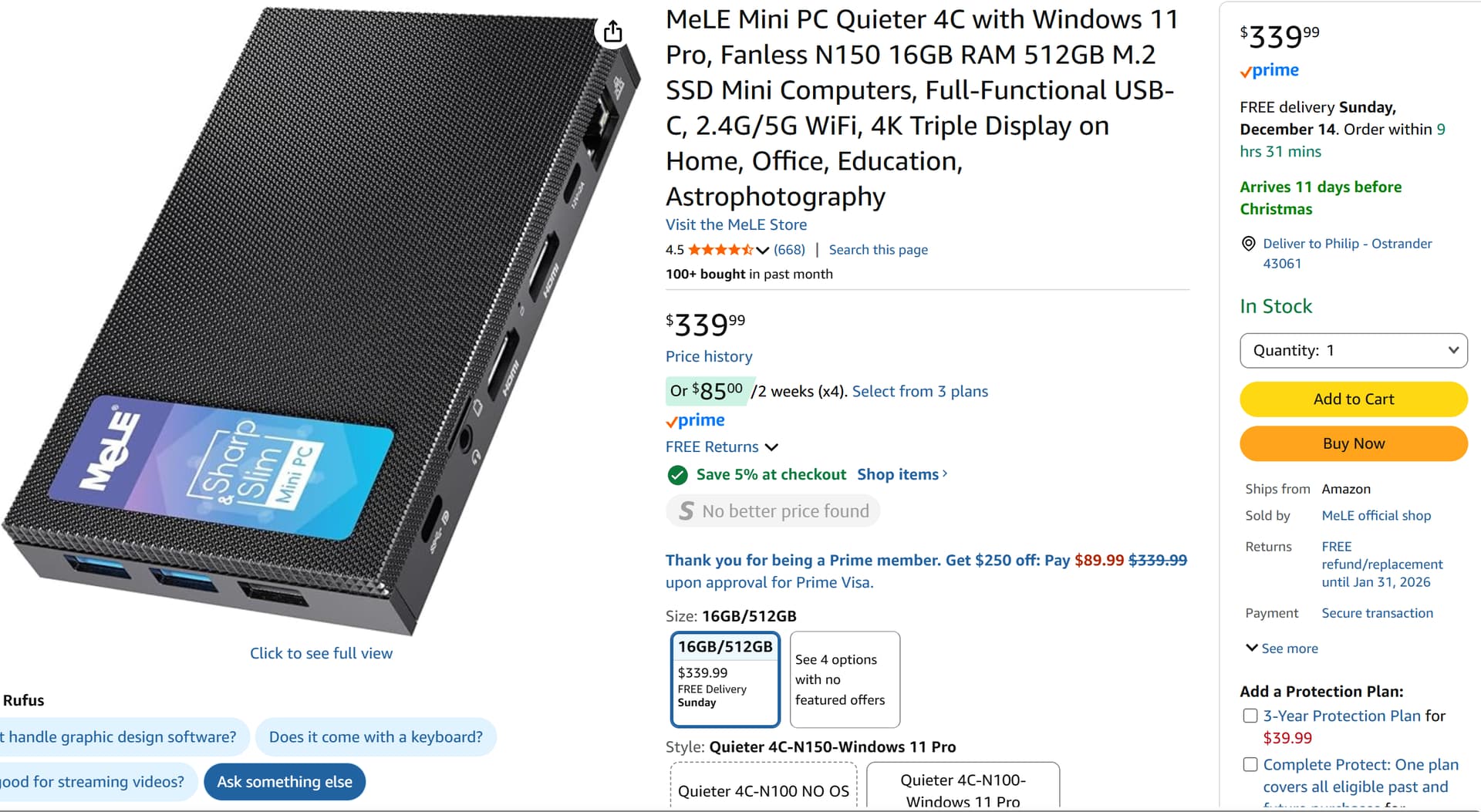

If you decide on the Beelink Mini. Only buy the version with the Intel N100 or 150 chip. No Ryzen or higher price version. The N150 chip has no power-saving features.Beelink mini PC with 12th Gen Intel, 16GB RAM, 500GB SSD for enhanced productivity and entertainment. It’s a popular product! Amazon.com

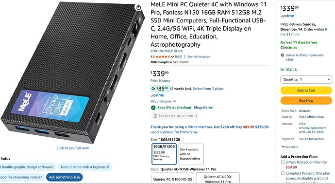

I went from my magnet-laden MS Surface Pro to one of the fanless mini-PC’s from MeLE. Didn’t want the fan sucking in all the airborne shop crud. Bought mine on Black Friday sale for $265 and paired it with a touch screen monitor and keyboard with a mouse pad. So far, working well.
