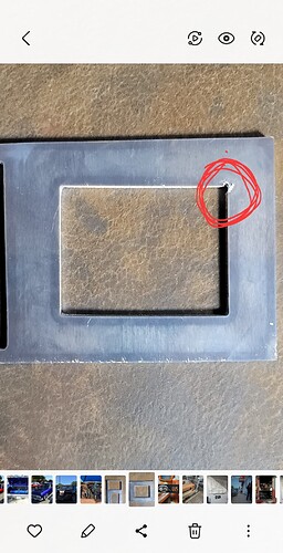

Will the kerf cause this?
What causes this and how can i prevent it?
That is the pierce. Looks like it’s on the wrong side of the line and/or to close to the cut path. What program are you using for cam?
I am using sheetcam
All my cuts have that pierce and it makes my cuts look like crap,lol.how can i fix it?
Select “outside offset” and use a lead-in.
I know it sounds wrong, but set up your cut as a single operation with outside offset. Sheetcam will assign the correct offsets to the inside, outside and open lines.
If you use inside offset, in a single operation, Sheetcam reverses all of the offsets.
Using a lead-in puts the pierce hole on the waste portion of the cut
Thanks, ds690 I will give it a shot.
