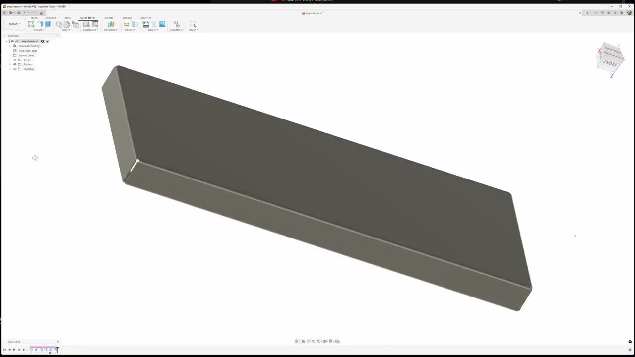

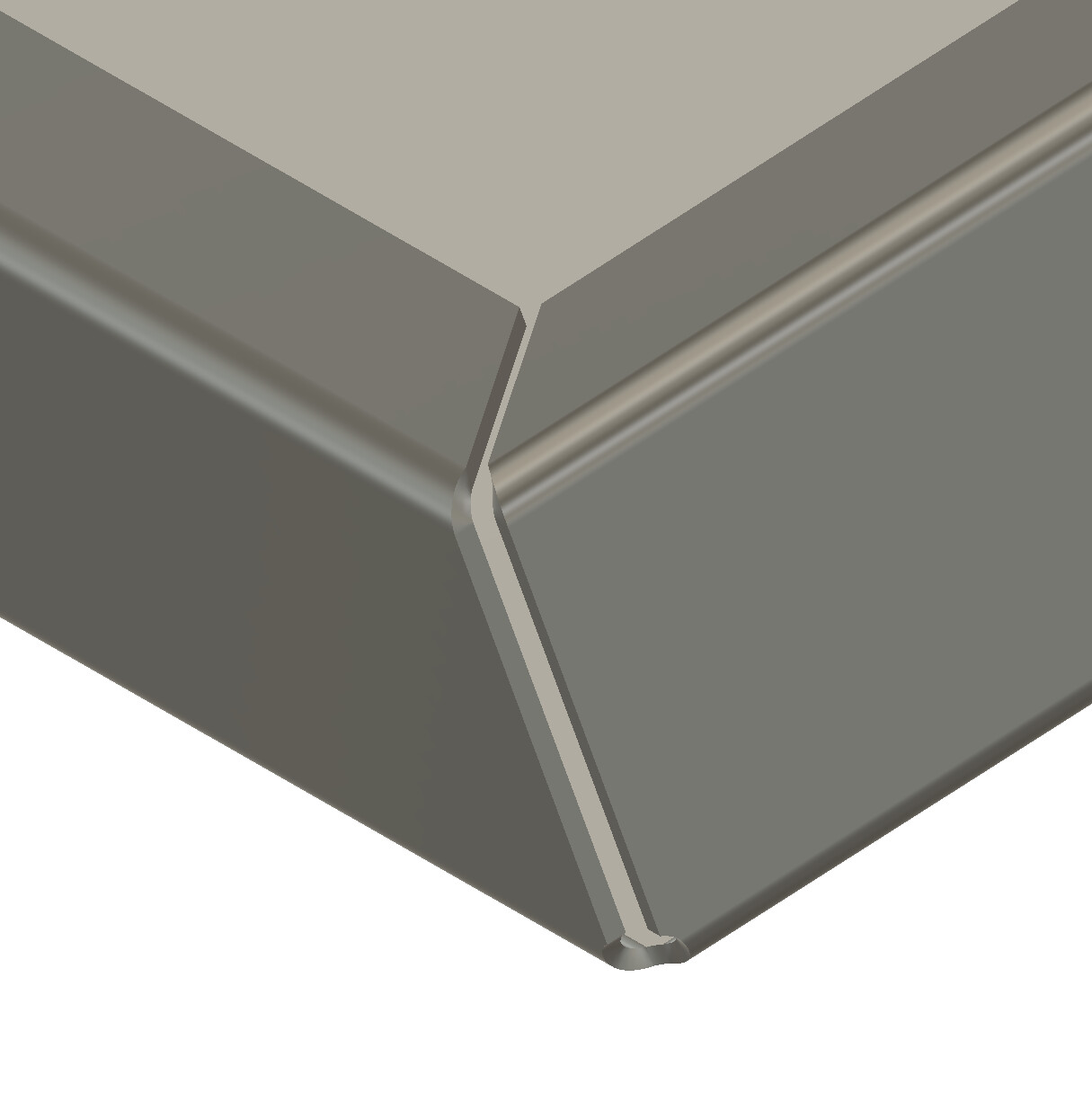

Here’s my concern and questions for the group.
Are you planning to make these corner types?
If so, you’re going to need the punch width for the second op to be as wide the opening to get in the corner. I’m tired of typing so I made a short video.
Doesn’t this solve your issue Craig, if I am understanding you concern?

Great video. I am saving that!
Special needs? You mean Like…:rofl:
Luckily none of my parts have that type of flange!
