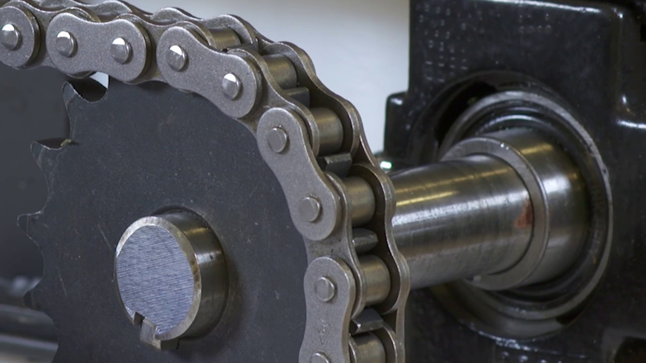

Who here knows how to model a chain sprocket?
See if this helps. I think I read on here at some point someone had a system for sprockets. I’ll look some more.
