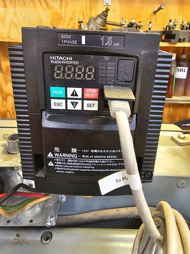

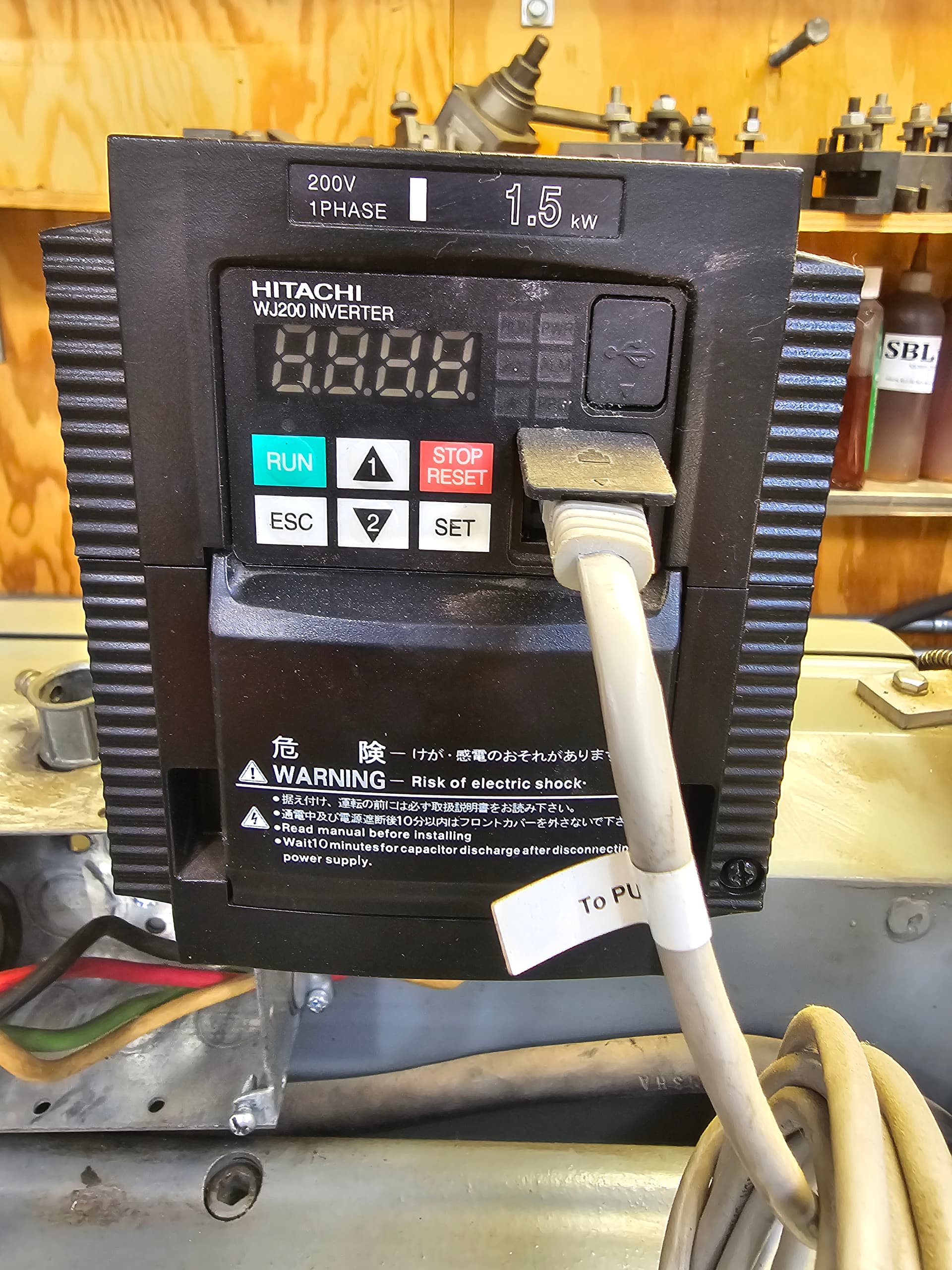

I use Hitachi WJ200 - 22 SF units. My lathe and Milling (Bridgeport) run 3 HP motors. They are easy to set up. You will need a 2.2 kw version.
I don’t use braking at all on either machine. I opted for the remote touchpad on both. I can go from 20 rpms to 1750 on both. Just turn the dial to the speed you want.

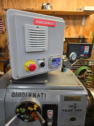

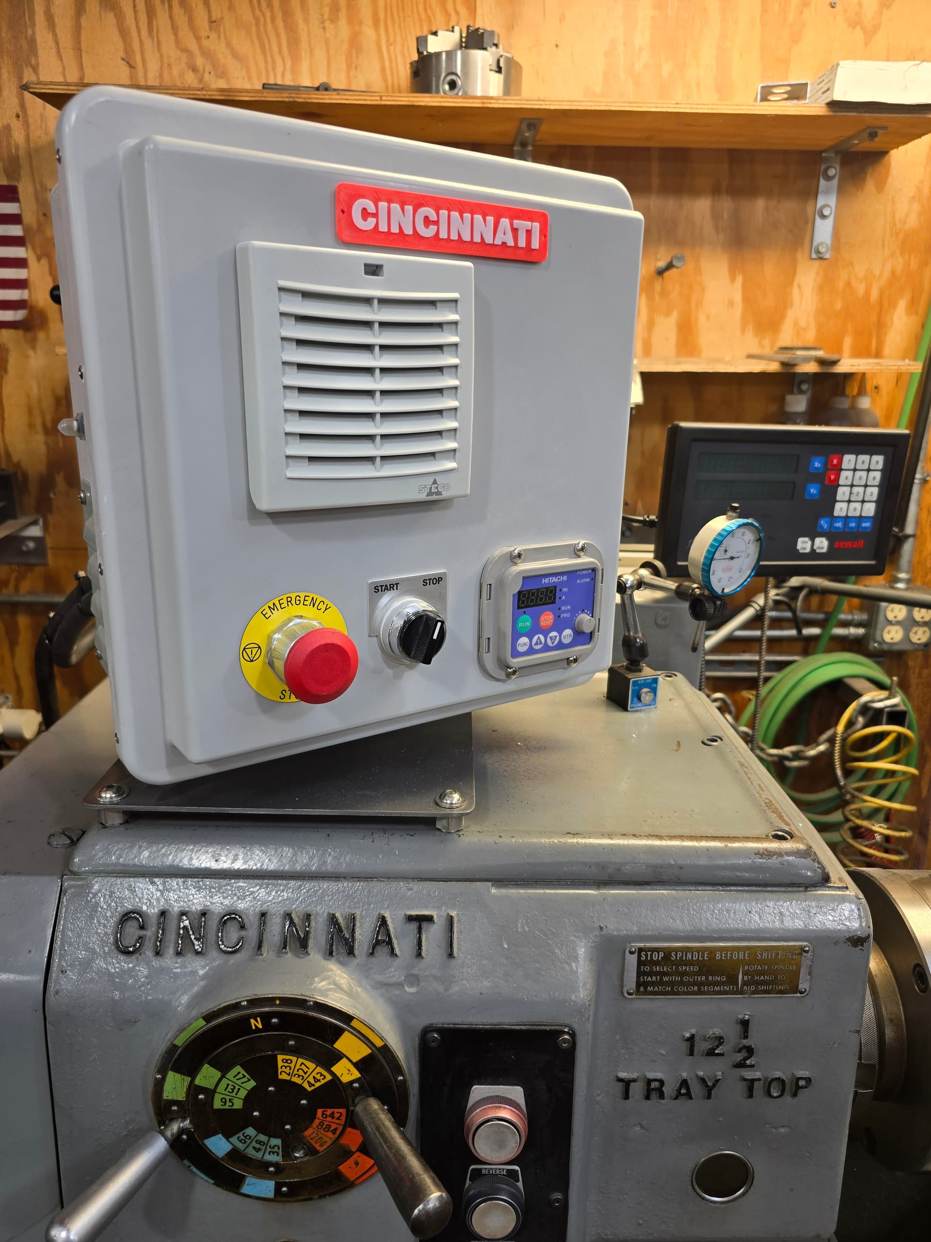

I opted to put it inside a NEMA enclosure like this.
This one came on the lathe when it had a 2 HP motor. I upgraded to a 3hp motor and unit.
It will eat metal. I can take almost a 1/4-inch pass on aluminum. Just stand back and get out of the way of the ribbon of hot aluminum coming off. You would need a WJ200-37 version for a 5 HP motor.
