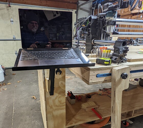

I have a OneFinity Journeyman (33"x48" but the 33" dimension is open so I can slide full 4x8 sheets of plywood in it - just need to tile my project which Vectric VCarve handles for me).
For your purposes I’d go with their Elite Foreman which is 4x4 and would require only 1 tile operation to cut an 8ft sheet of plywood. It also has their upgraded motors and Zaxis setup to handle the additional weight of a real spindle (vs a Makita palm router).
Spindle options (besides roll your own) include a complete package from PWNCNC, water or air cooled. Laser head options come from JTech (diode laser) and are available in 7W, 14W, 24W and 44W options.
Lasering operations will be slower than a dedicated laser but since you won’t find an affordable 4x4 bed laser, it’s not a bad option. I use my CO2 laser for small stuff and the OneFinity for engraving on large projects (or cutting large thin material but I don’t do much of that).
The OneFinity can mill some metals - mostly aluminum or brass but isn’t a true metal mill.
BTW, I put mine on a flip-top table so I can flip it vertically for storage (or flip it 180 and get a nice flat work table). It takes up 22"x7’ of floor space when flipped. Otherwise it’s easy to run out of room in the shop :slightly_smiling_face:

Jim, that sounds amazing. Any chance we could see some pictures?
Crap part is, once I get the laser module, the One Finity table, VFD spindle, and other (platform, accessories…) I am in it for $8.5, and I have more need for a 14" x 40" engine lathe, and that will run me $10k ($19K for the one I really want, but is way out of my budget).
Arrrgh
Here are some of the table. The top rotates 180 degrees each direction but stores 90 degrees from horizontal. There are a half dozen drawers on one end to store bits, tools, etc. The top is a sandwich of 2 sheets of 3/4" ply with a 1x4 honeycomb in between (torsion box construction).
That would be the part that worried me during construction. Nice job. Thank you for sharing.
Nice.
I was pondering a wall mount for storage that would double as mounting for horizontal work (I did see the wall mount kit and am not convinced)
