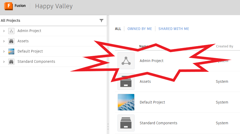

Third: It brings you to this screen. All of my files are under Admin Project, so I click on that.

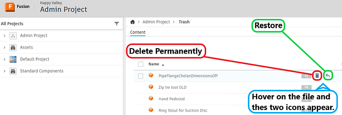

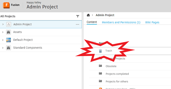

That will open your file folder and you will see “Trash” folder at the top:

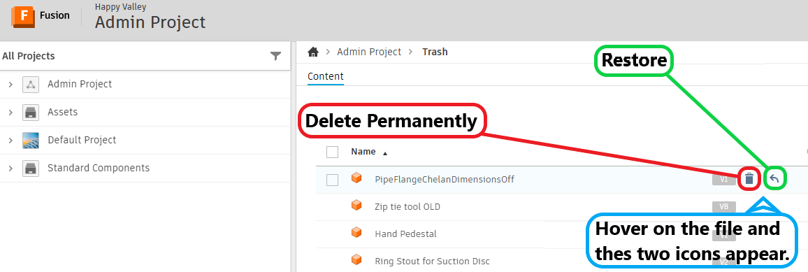

Open the Trash folder and you will see the files that you have moved to the Trash Bin. Now you can choose to permanently delete or to restore the file. Hover over the file you are interested in:
