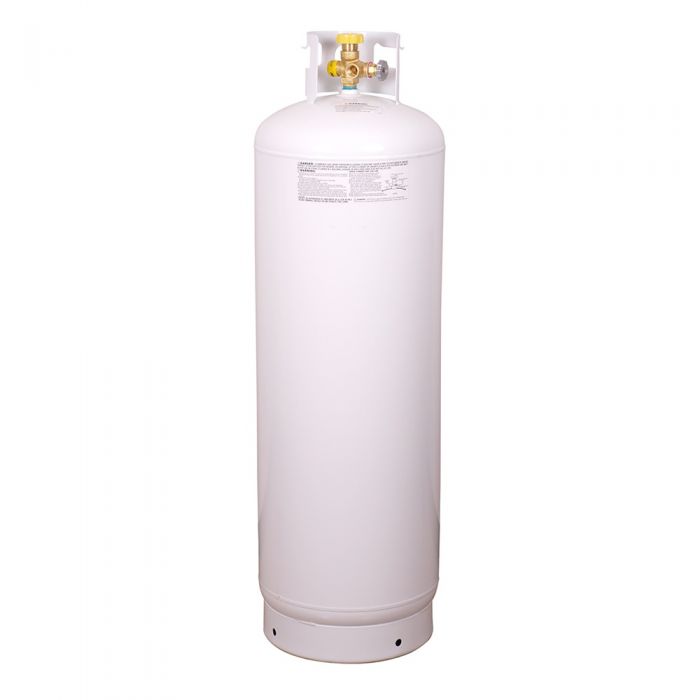

If you allready have that compressor you could get something like this for more
storage. Just take a bit to fill up but would help on the volume issue. ( no propane in it of course )
Oh, come on, run it with propane just once, with video camera running. lol
A tank with a bottom drain might be a better choice.
Those propane tanks are ideal, just have to drill the bottom and weld a fitting on for the petcock. You can line up 2 or 3 in a row and give your air out of the compressor a chance to cool and condense before it get to whatever dryer you are using.
Out of date propane tanks are cheap as heck at the scrape yard.

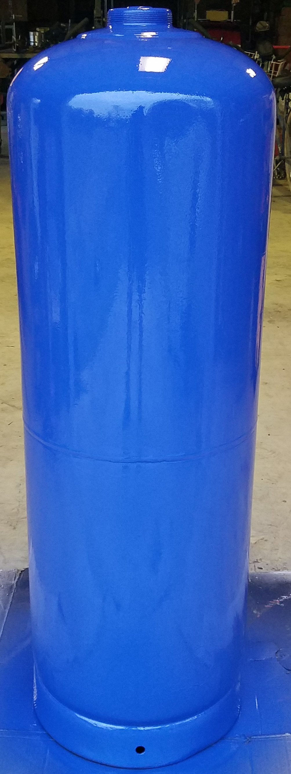

My 26 gallon is only a one stage compressor. When the torch fires and the tank pressure gets below (I think) 90 lbs the compressor kicks on and won’t turn off. Then the tank pressure will continue to drop too low then the torch cuts off. That’s cutting on 1/2" plate. I then added the add-on tank, cut 2 bigger parts using the same 1/2" plate with no issues whatsoever. So yup it was a volume issue.
sure sounds like it.
Can I see a picture of your aux tank setup? Im in a similar situation.
Here is a picture from an old tank that I sanded down and applied 2 coats of paint onto it. I’m currently out-of-state at this time but as soon as I get back home sometime Saturday I’ll take a picture of the plumbing to show you how I connected everything.
Click on the photo to view the full picture.
nice thanks that looks pretty big. I picked ip a 20 gal im hoping that is enough to argument my current compressor though based on the specs it should be able to keep up. Im only cutting 3/16 at most though. Though I think I have an idea I would also like to see how did your piping is routed thanks.

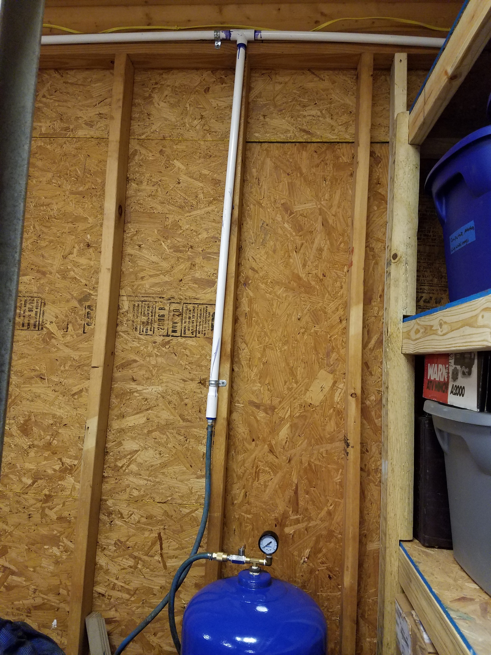

Okay I was able to get back home sooner than expected. On the 1st photo at the top right hand side is the pipe (3/4" PVC sch 40) coming from my main compressor tank which is located in a
small shed outside of my shop. I want to also mention that I ran a dedicated electrical line from the shop breaker box with a red light (on & off indicator) connected to a switch out to my compressor shed so that if a pipe would happen to bust while off working it would be turned off so that it would not burn up the compressor. Then it T’s off and runs down to the auxiliary tank.
Then on the left hand side of the T-connection it runs out to 3 different quick connects in various spots of my shop including 1 that runs out to my
carport for airing up auto tires. The quick connect that I have for the plasma cutter has a regulator there for controlling the air pressure on the cutter or air tools that I may use instead of going back and forth from the compressor shed.

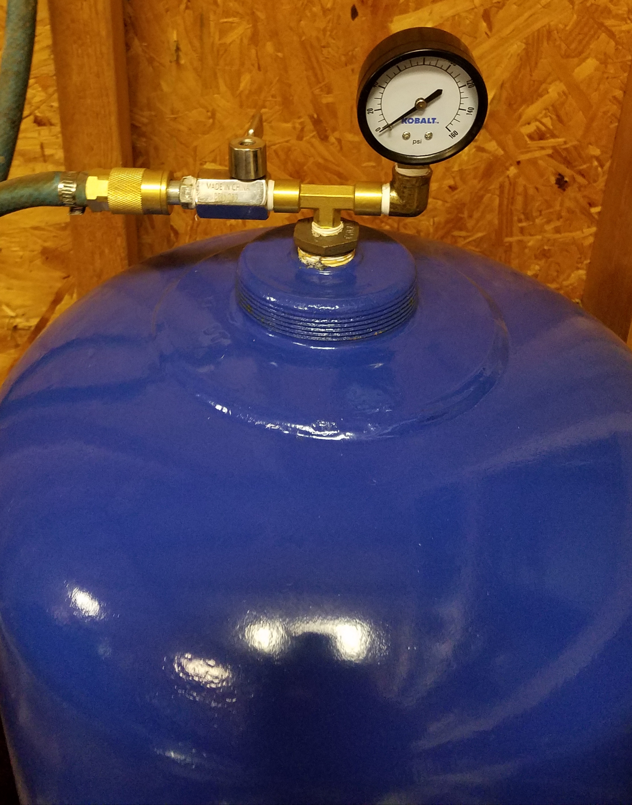

On the 2nd photo is how I plumbed my tank. I purchased all of the connections at my local Lowe’s store. There’s no air in it now because I have to change the 90° connection at the gauge that I bent when installing. Also I did mess up and should have put the quick connect on the tank itself instead of the hose that way I could have used the tank as a portable tank. I will change that over at a later date. Very easy & simple. Hopefully this will help you.
nice thanks I think im going to setup something similar
