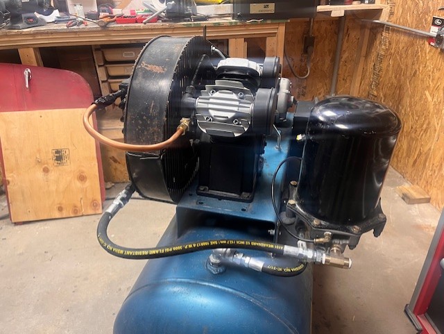

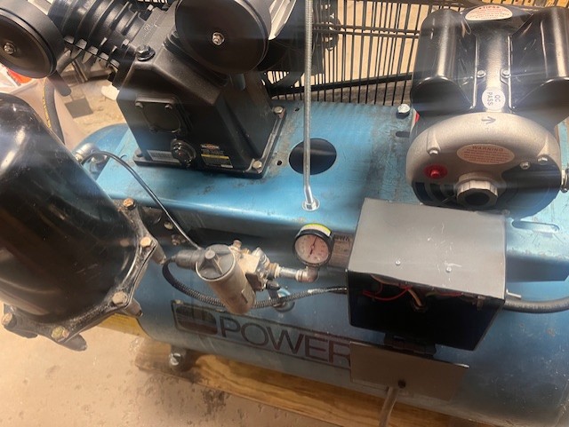

FWIW I use a passive radiator that I put in between my pump and the tank and it attaches to the protective cage of the belt drive. I put a water separater in line as well and it has never captured water. I have an auto drain on the tank and when it goes off there is no moisture from the tank. I do powder coating and the sand blast cabinet uses are at way higher capacity than the plasma table with two 60 gallon tanks spread across my air system and I never get moisture at the blast cabinet. I went with the radiator just because it uses no additional maintenance or service other than blowing a little dust that has settled on the fins over time. I used softer copper tubing to go in between the connetions and fittings along with some compression adapters.
