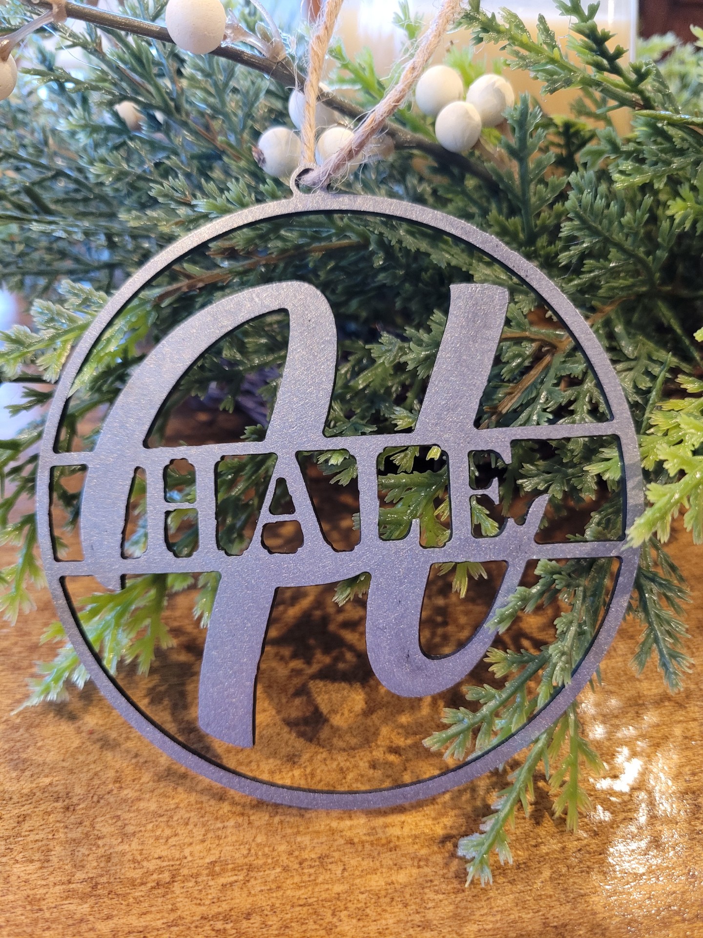

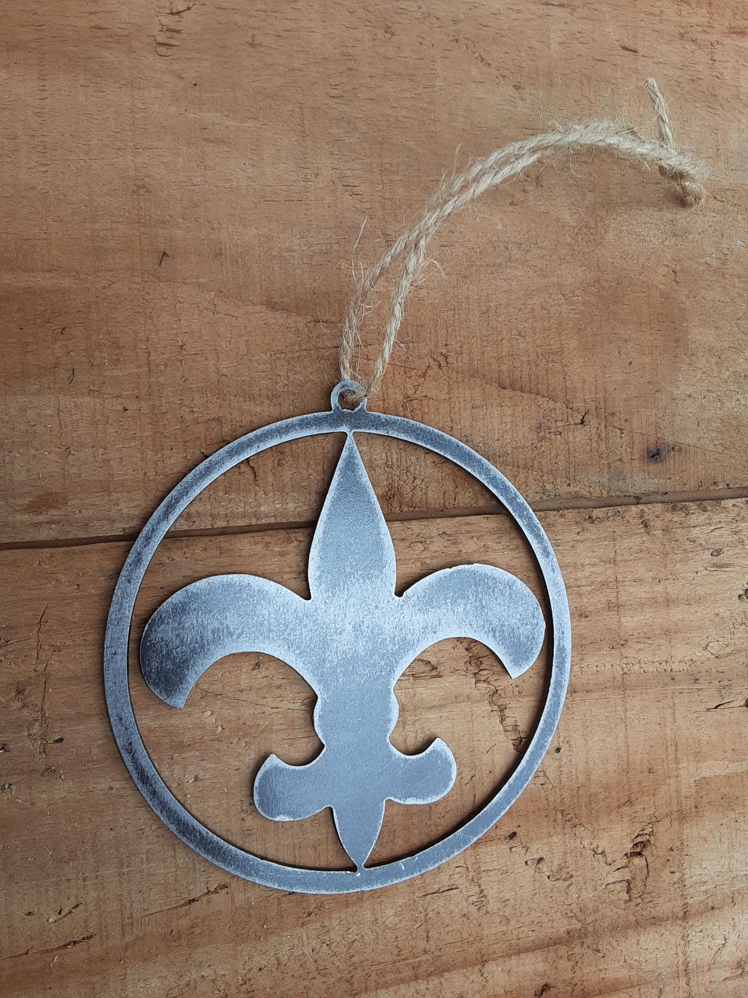

I cut lots of smaller ornament style pieces. Painting these things can be a little challenging to keep from sticking to most surfaces. My one issue that I found while trying to just hang them from a hook to paint, was that they weigh so little, they blew around quite a bit. Hole is 0.13”. Any ideas or pics of something that would work? Usually paint 50 pcs at a time. Thanks!

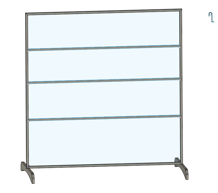

It appears that your items are small and light-weight. I like making my utility racks out of 1/2" rebar. It is relatively inexpensive and durable. (And my welding and grinding skills are legendary :roll_eyes: :rofl:)

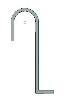

This rack would allow lots of items to be hung with wire that you would want to fit the size of the 1/2" rebar close enough to stop too much sideways motion. I made the radius to be about 0.30" inches for my mocked up hanger:
(You could decide to point the tail either way depending on how heavy your items are)
Here is a sample rack idea: about 36" tall and 36" wide.
