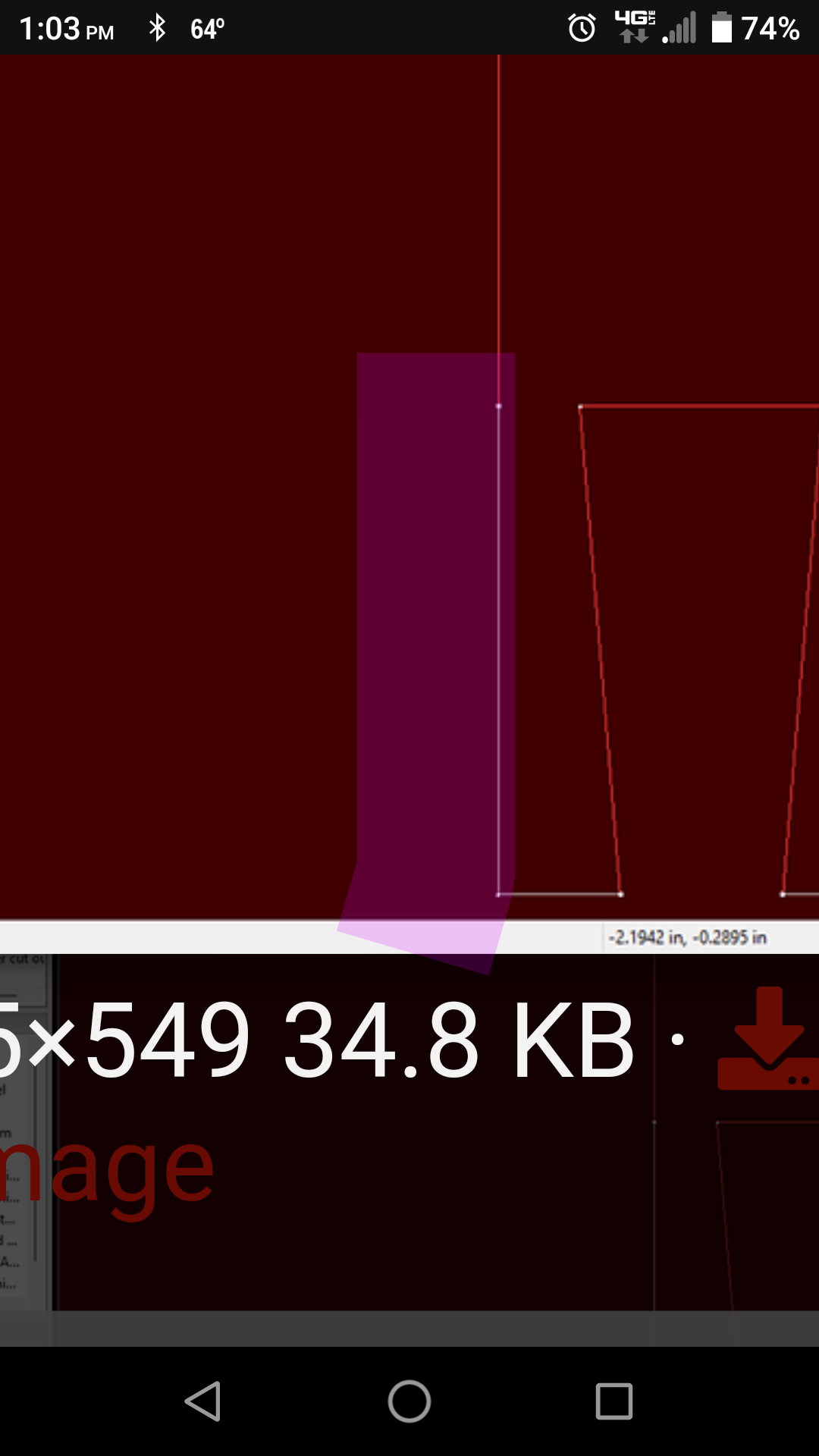

It’s a band aid solution, so you need to figure out what is going wrong with your exports from Fusion.

Could it be a problem with how I am drawing them in Fusion?
I don’t use Fusion, so I don’t know what the problem is.
If you post your f3d file from Fusion, maybe one if the Fusion users can see where you went wrong.
I use Freecad and just save my sketch as a DXF and have never had a problem with construction lines showing up.
fixed it you had 2 short lines laying on top of the long lines

I will have to try and see where I made my mistake in Fusion.
The white dots on the outside edges those are short lines. . I guess you drew short lines then longer ones?

I use a 2d cad program mostly it was easy to spot. Sheetcam will accept that file fine. I am not for sure how f360 will accept it I don’t see it would be a problem.
