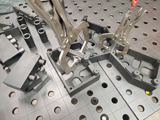

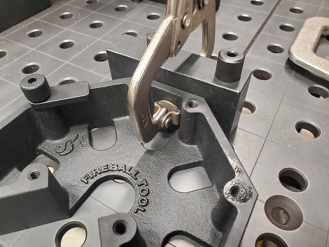

@Kwikfab Do you know if the minions will work with the 11 inch clamps?
I think I have 6" tall minions and they work well with any clamps.
It’s only with the 6" mega square, where if you use their positioning tab, can force you to use say a Milwaukee 6" c-clamp. But for everything else, I use 11" clamps without issue.
Correction -
You will need 6" c-clamps if you wish to use the 6" squares (mega or minion) to clamp something to the top.
The opening is only wide enough to accommodate the small clamp, but anywhere else accepts the 11" c-clamp easily.
6" up top
11" on the side/corner
6" up top again

Here’s one more pic to show that you can use large clamps everywhere except the tops.
