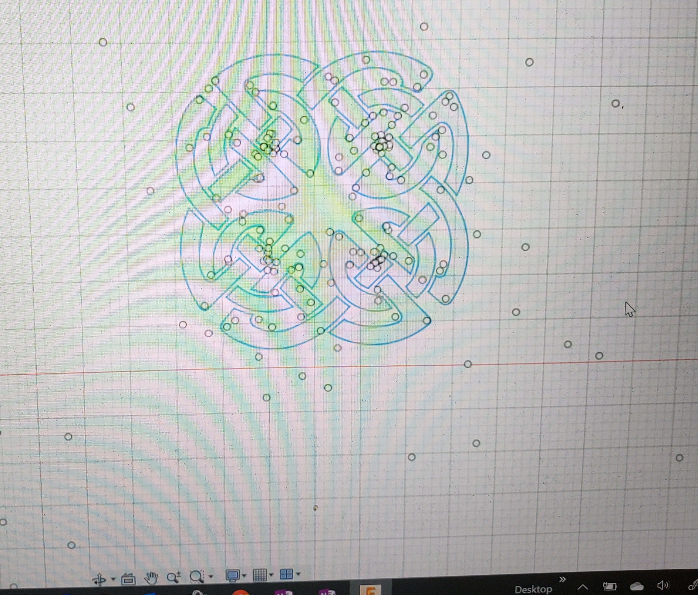

What are these dots?
I hate to sound like a complete idiot, but what are these dots? When I download designs, sometimes these tons of them everywhere like this. When someone says they had to clean up a file, is this what they are talking about? Sorry if this is a stupid question.
Looks like chicken pox to me, lol but really, I have never seen that on anything that I’ve downloaded. When I’ve heard some talking about cleaning up, it is usually reducing the number of nodes and duplicate overlaying lines that would have the cutter pass over a second time.
are you using a conversion tool to get the dxf that you imported into Fusion? I’ve seen those on a few of my designs that I converted. Importing a plain sag that I designed does not produce the extra dots.
Nope…its just a downloaded dxf from plasma spider. Just opened in 360. It happens with a lot of them I download

I had dots like those showing up when I used convertio to make some of my svgs into dxf.
They’re reference points for arcs or circles. All those curves have an arc radius and the white dot is the center of the radius. These vector files are typically either splines which are a series of nodes that are connected by lines. Like connect the dots. Or polygons which are geometric shapes put together to form whatever we’re drawing.
So just ignore them, I’m guessing.
Yeah, they won’t show when you generate tool code in Fusion or Sheetcam

I’m not blaming anyone… just curious. It extruded fine…cut fine…I guess I just ignore them. Lol
yeah I wasn’t trying to say you were. I just thought my comments sounded a little bit negative toward Fusion. Yup you can ignore them if they don’t interfere with your tool paths.
