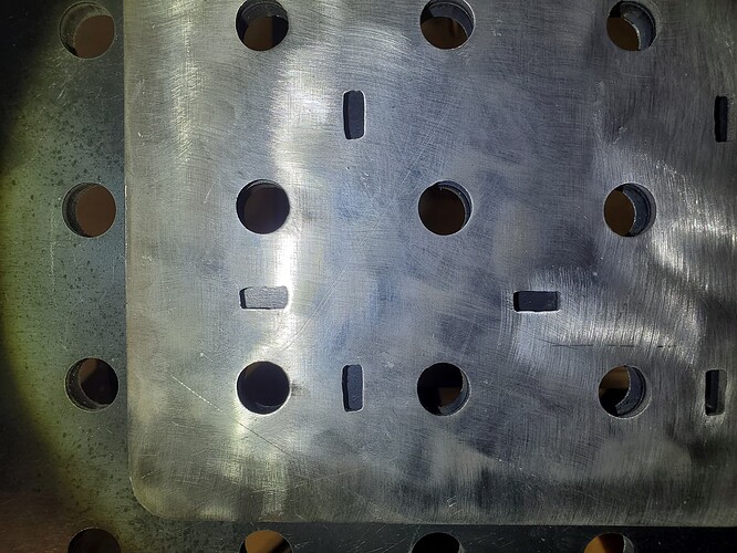

So, a member in the Facebook group asked a question about cutting out their own table on CNC plasma.
Those that cut enough on plasma realize what expectations should be. With that said, since I have both a CNC plasma cut and CNC laser cut table, it’s only fitting I add a little comparison.
Earlier in the thread, you’ll see my need for reaming out the holes for a true 5/8" size. This is expected especially if you go with a thicker table top due to slight beveling that naturally occurs.
Thought I’d take pictures of each corner of my small 21" x 21", 3/16" thick top placed on top of my 2’ x 3’, 3/8" thick top -
Bottom left corner, light from underneath
Same corner, light from above
Bottom right corner, light from underneath
Top left corner, light from underneath
Top right corner, light from underneath
I do feel like once all the holes on the 3/16" plate are reamed out, they would be a closer match but not as accurate as I would’ve wanted it to be. Seems over the span of almost 20" across there’s a deviation of 1/32". Again, not bad at all considering the very issue I had throughout the entire cut.
And if you missed what that issue was, my Z axis was binding and it cut 99% of the table at nearly 1/2" cut height :rofl:
so a very nice comparison…

A dialed-in table would most likely make up for that 1/32"…easily doable on a Pro as it won’t have the deflection that a non-Pro has.
For everyone else -
  1. If you want real accuracy, with minimal work, go local and get it laser cut ($158 which included labor and material)
  2. If you want DIY, with some work for as little as possible, go plasma and do it at home (free since I sold tabs off that remaining metal)
  3. If you want guaranteed flatness, and minimal work on your part, go Certiflat or other similar offerings
