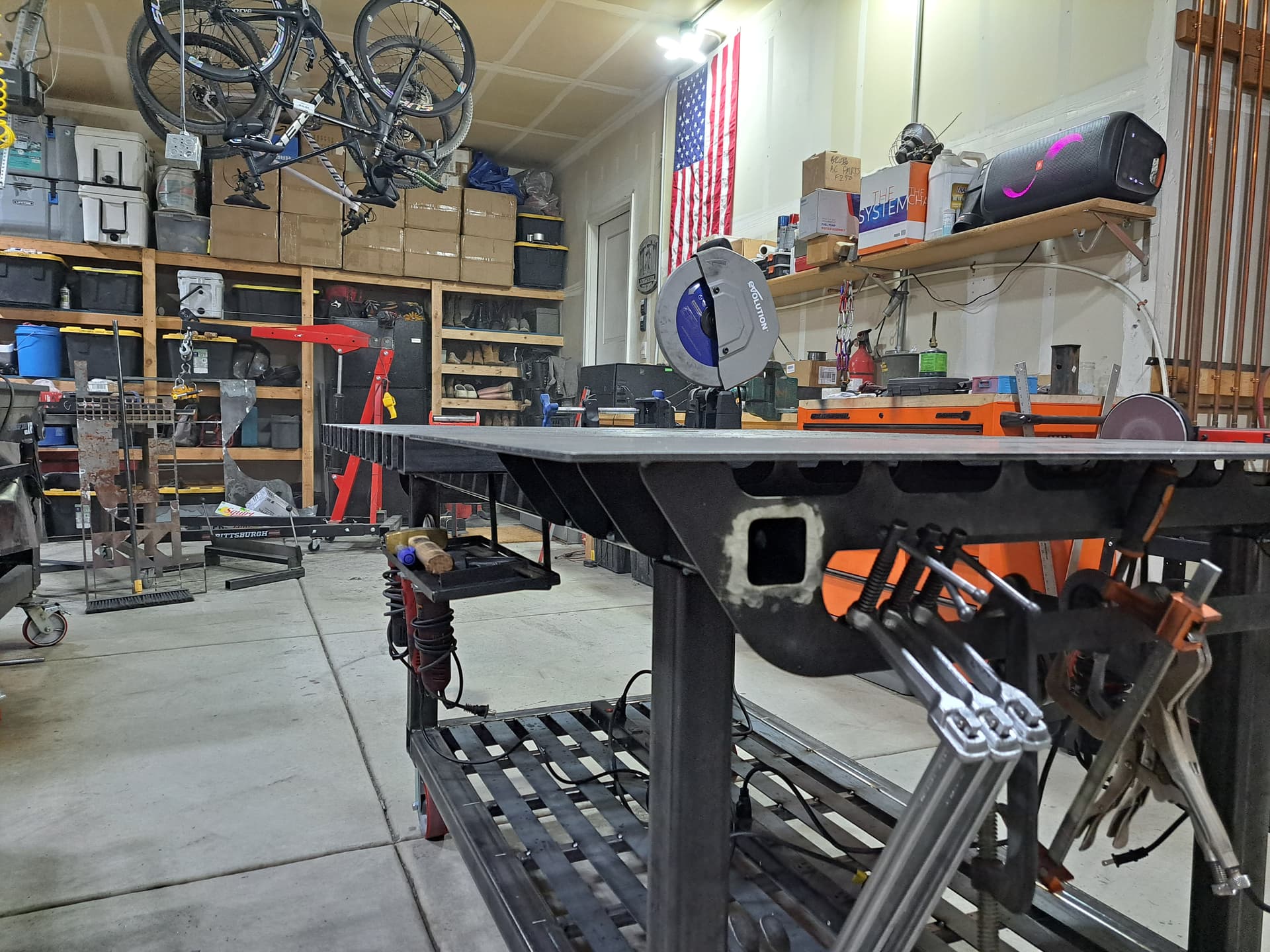

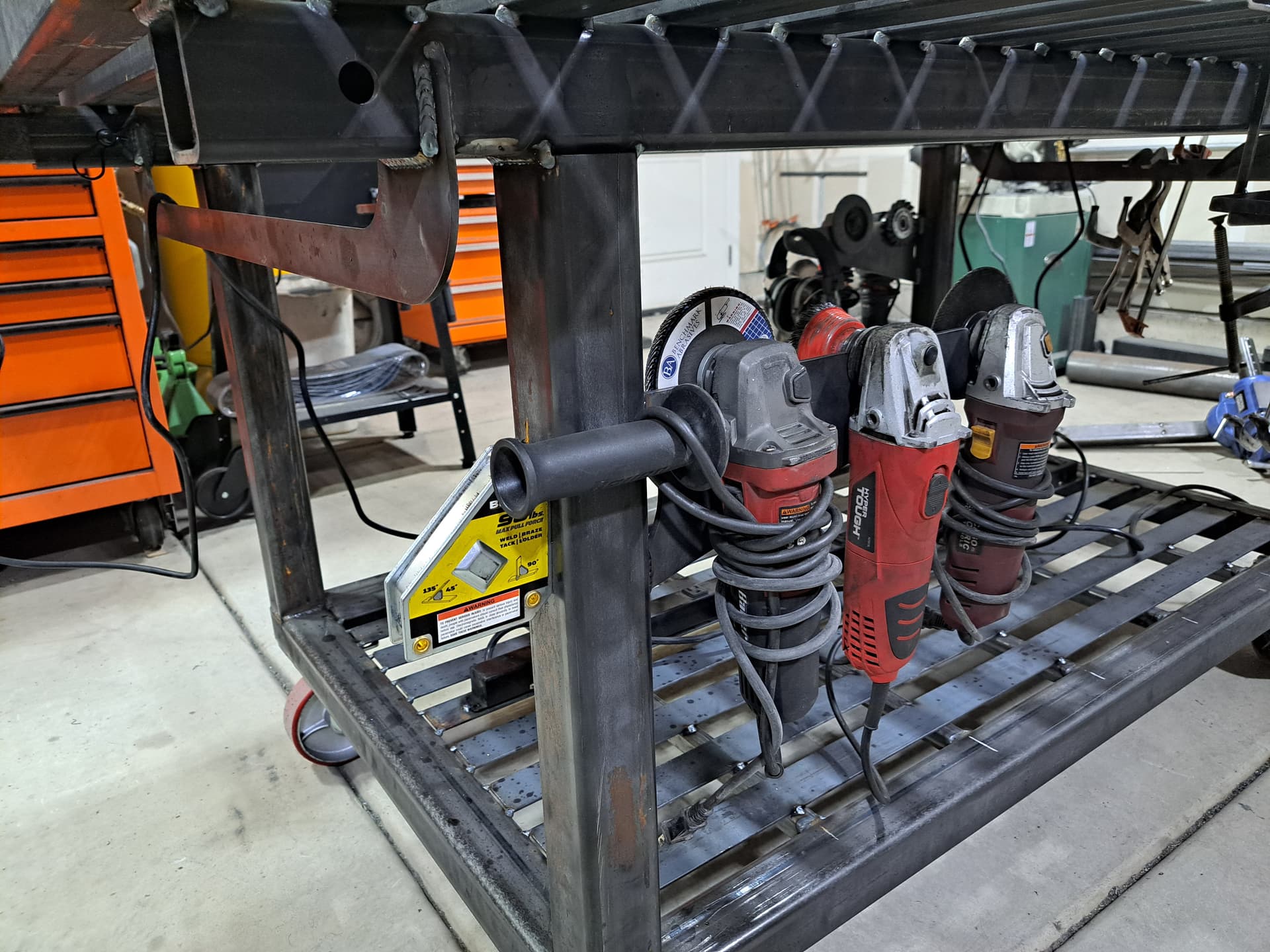

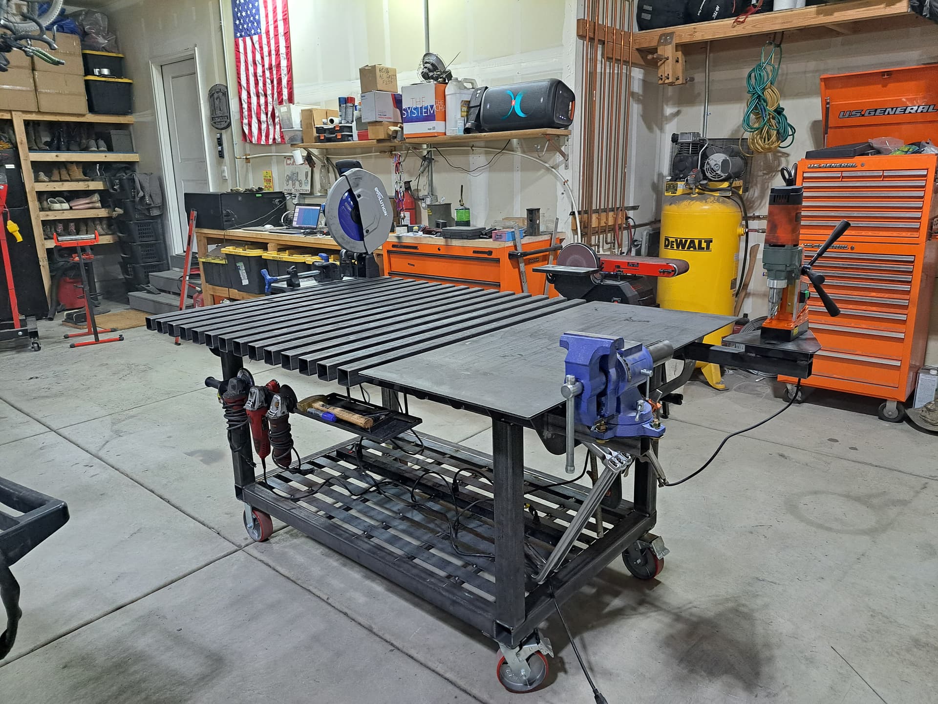

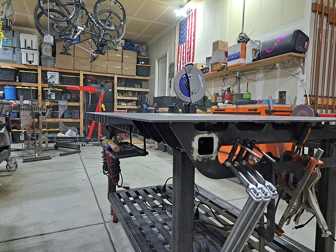

got the new table done. put in some long hours today so i could get back to my paying jobs. had more Monster beverages than the usual and the frequent trips to the john made me realize that the basement shop toilet now lives rent free in my head.
anyways, here it is.

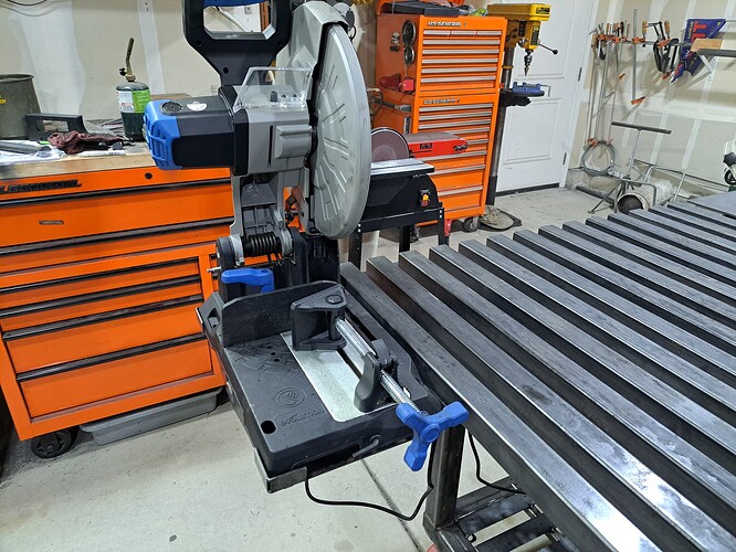

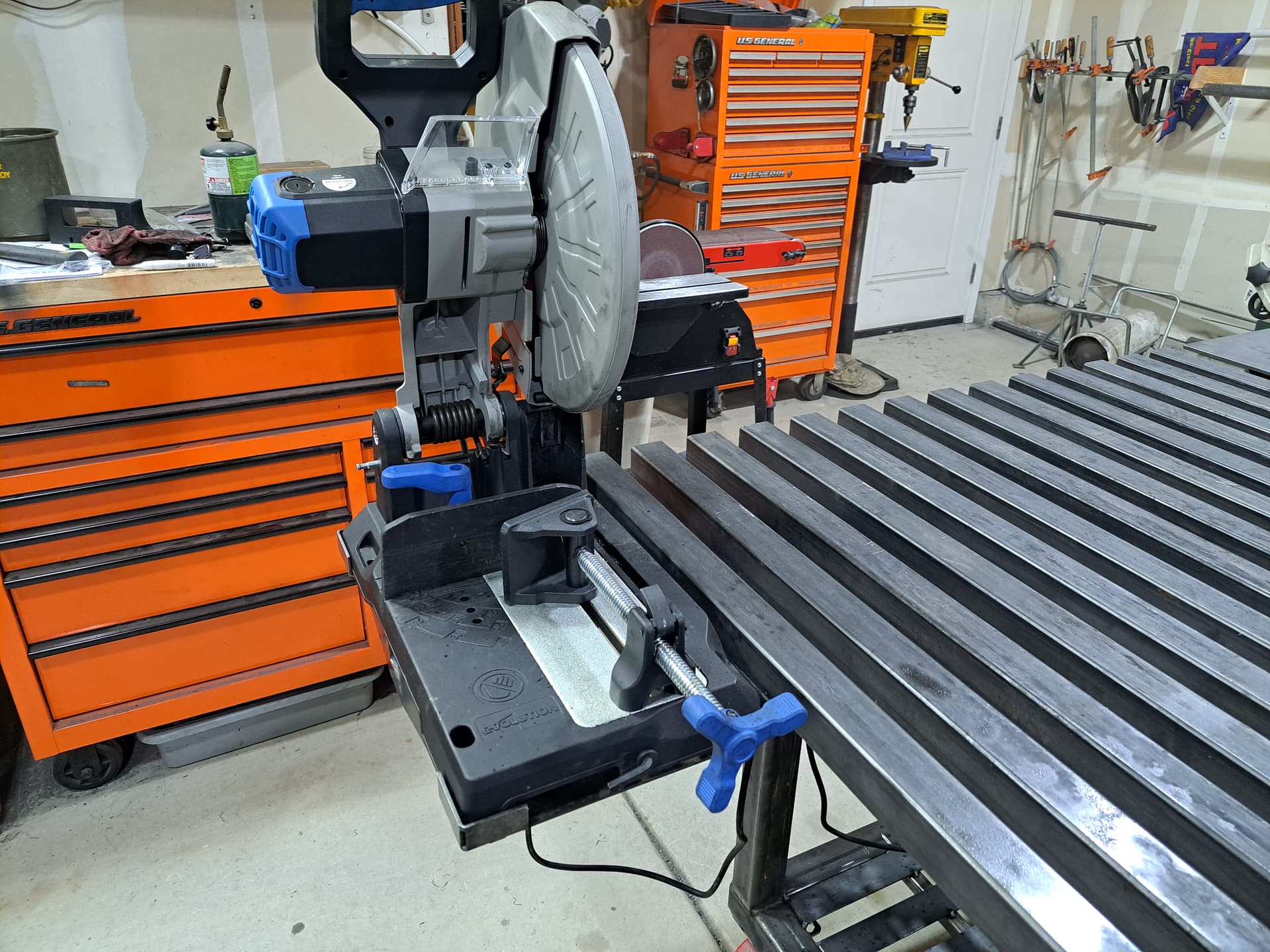

used trailer hitch tubing for the frame just so i could attach tools at all the corners as needed. never had such a versatile work station.
also wanted to mention the Evolution saw is new. never even tried a carbide saw before this weekend. Cutting with that saw is such a pleasure, the first cut i had a private little cry in the garage it made me so happy.
Looks great. Well thought out too. :clap:
What happened to Daniel’s Photos?
He must have decided to take them down. God knows he has the ability to control the forum page. It was a nice setup, though.
That’s awesome. Looks really good.
What mag drill is that? I’ve been wanting to get an evolution one for a while. I have one of their saws, yeah they are great for sure.
