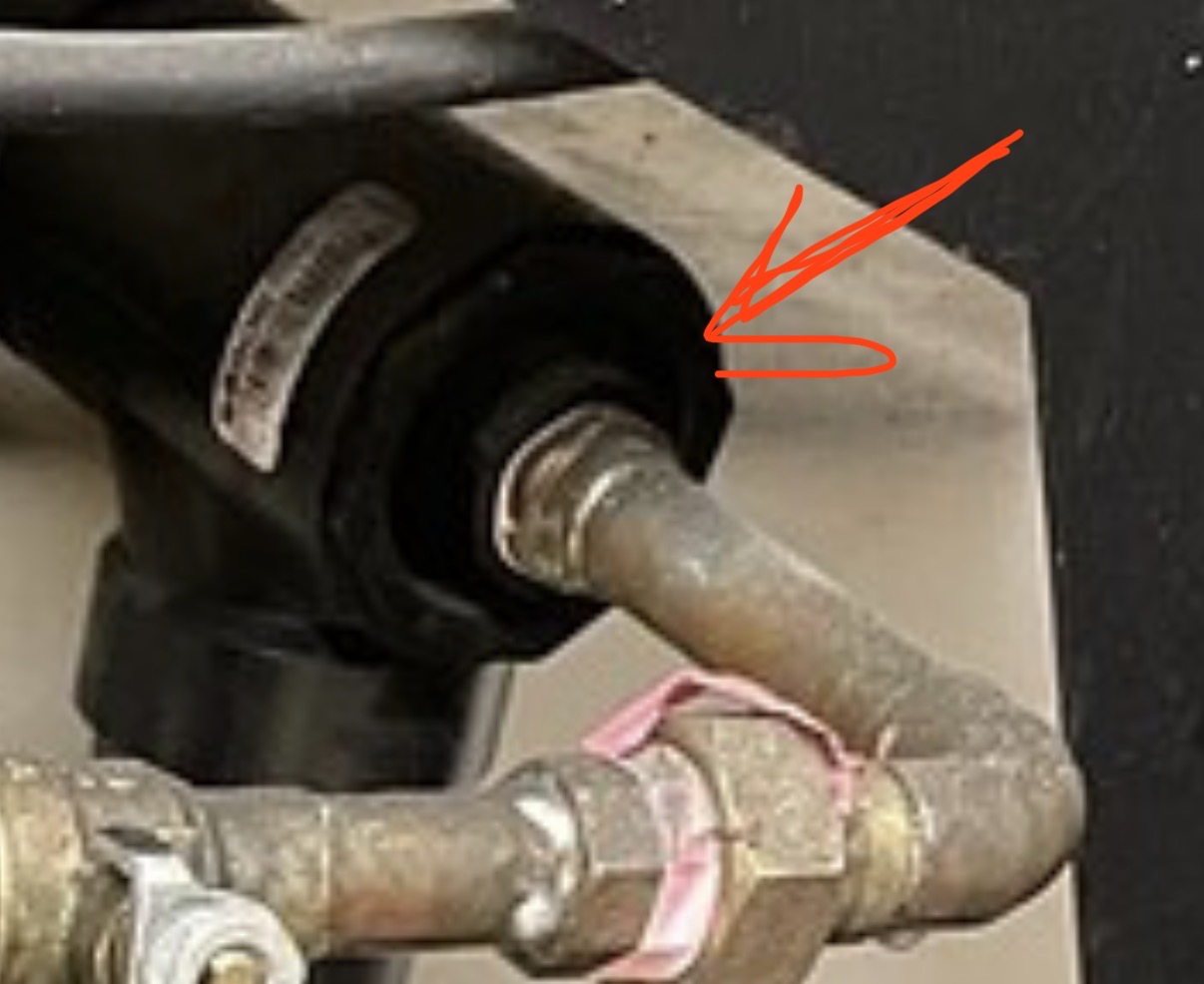

Toolboy, what fitting did you use rate end of the ABS? I cannot locate it at any hardware store. I mean it looks like a 1-1/2” to 3/4” or 1/2” female threaded plug?
If you’re talking about what comes off The RV water tank, I had to order the fittings for mine. Or are you talking about the barb to standard garden hose fitting? Those are easy to find.
Dis right here
I cannot find one to save my life

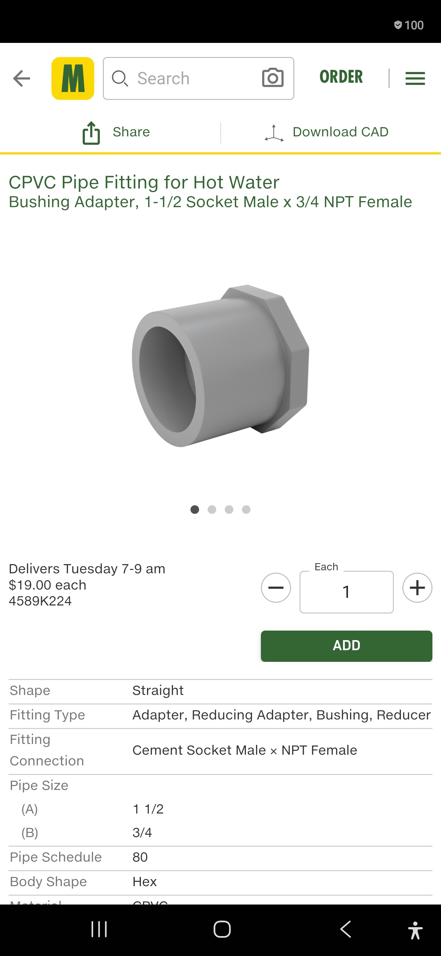

McMaster Carr, they are not the cheapest, but they have what you need. That’s a standard plumbing supply item. Not sure where you’re located. Looks like 2 inch slip to 3/4 NPT female. 1 1/2 is my example
IMO (and others), Metal pipe fitting male into a PVC/ABS female fitting is a really bad idea. The metal doesn’t give, the plastic does and cracks. The reverse is better, Plastic Male into Metal Female works just fine. Seems the plastic is willing to stretch… :thinking:

This is a inch and a half abs spt (spigot ) bushing by half inch female pipe thread fitting.
CANPLAS 1-1/2" Spigot x 1/2" FPT Socket ABS Flush Fitting Bushing | Home Hardware https://share.google/P6NOwukesAgj8dROB
Even though Toolboy’s description above says it’s 2 inch it really does look like inch and a half ABS pipe work.
The reason big Daddy’s example is so expensive is because it’s CPVC which is chlorinated polyvinyl chloride. Where you could use a fitting like this to ABS you would have to use transition cement to join the different types of plastic together.
