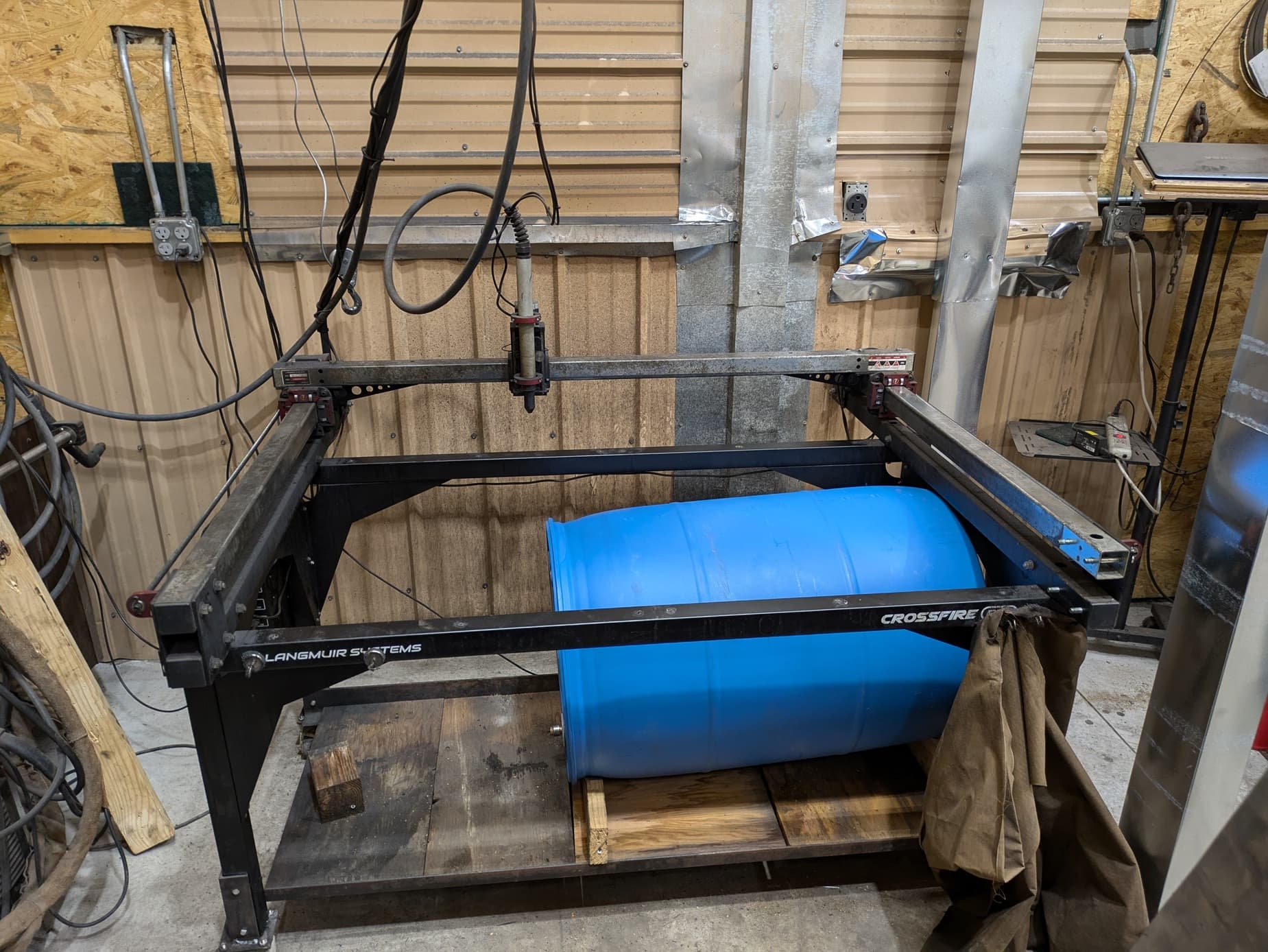

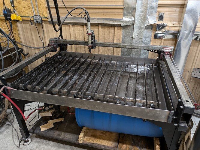

I used a 55 gallon plastic drum, which I found locally for $23. It’s big enough to fill my 4" deep single piece table.

I run a barrel system as well for my CFP, but doubt that this 35gal will hold enough for that size of a table…

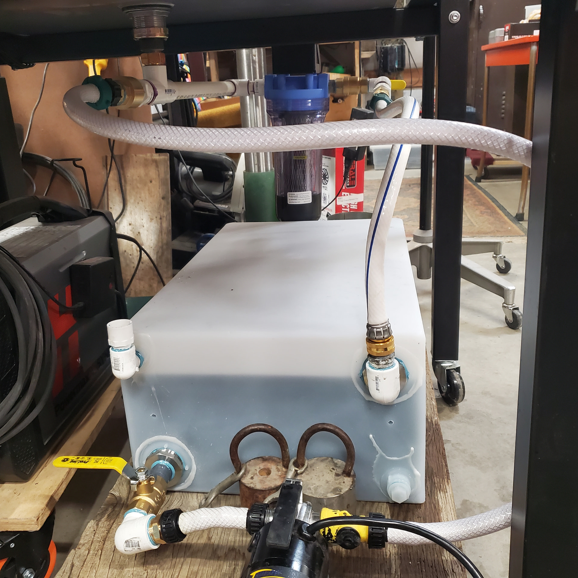

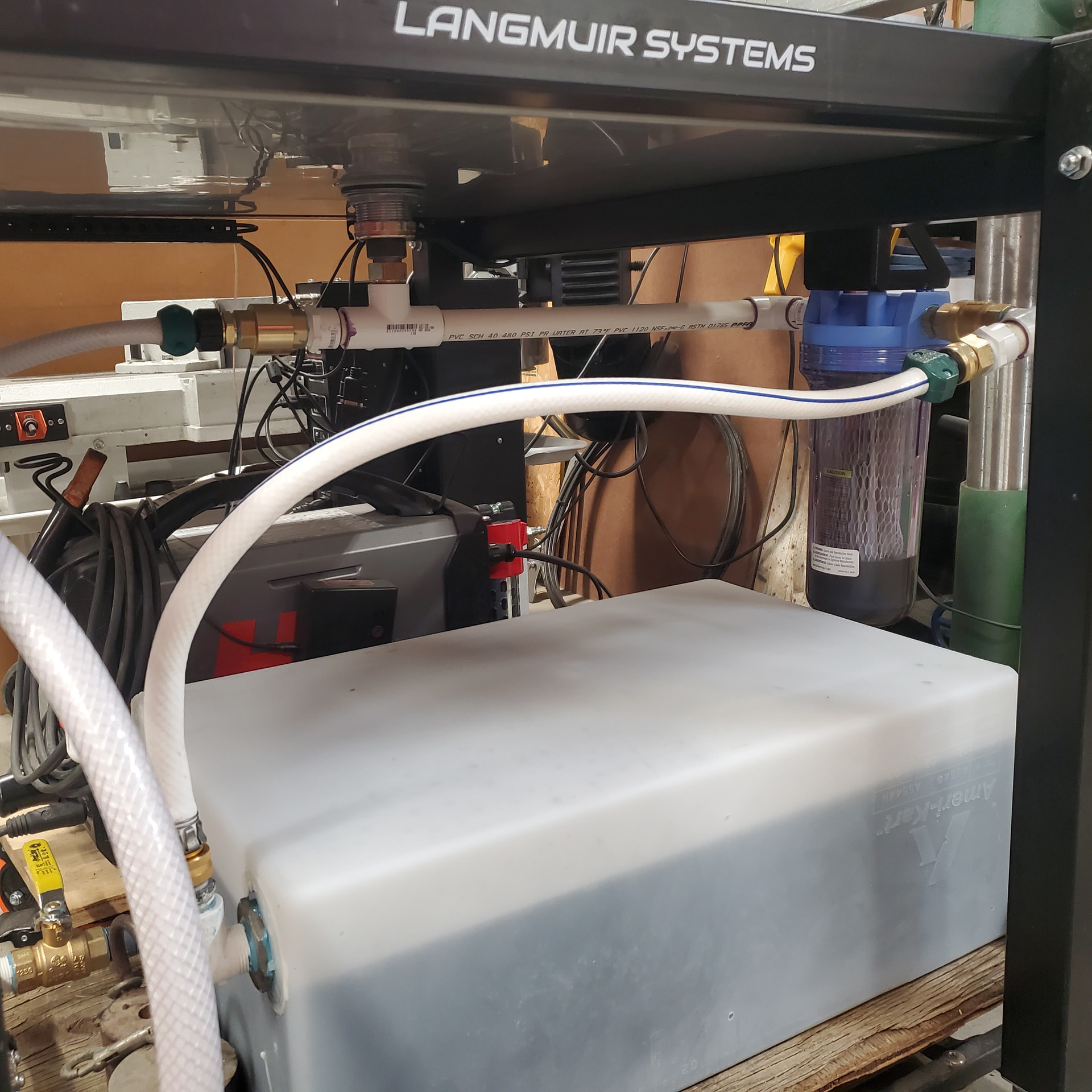

Yes have been using rv tank for 3 years ,also used table drains as fills , and put in drains in the center of each drain pan .used 3/4 pex fordrains and fills ans a 110 rv water pump to fill

So you guys using the enclosed RV water tanks, do you have them vented? Seems like when draining the water or air would bubble back up in the table other wise.

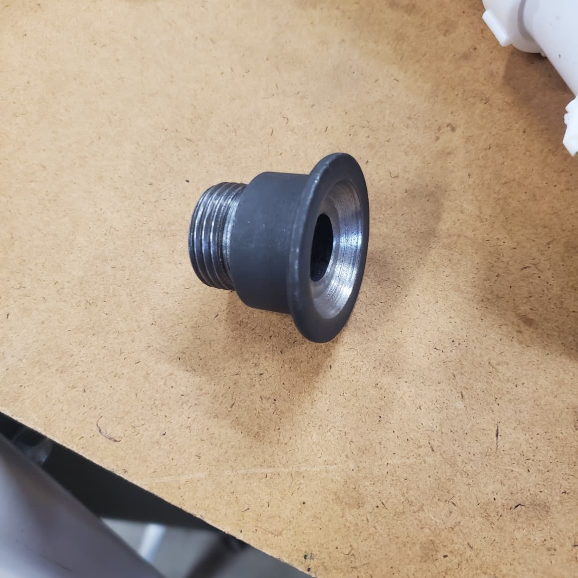

I’m am also trying to figure out how you guys are going from the sink drain to smaller PVC pipe or pipe fittings? Maybe I need to look at a different brand of sink drain.

I have a vent pipe on my tank.
I’m not running a sink drain. I had a custom water pan cut and bent up then I welded the corner seams. I have a centralized single drain that uses a brass bulkhead fitting meant for boat hulls ( Amazon.com ), that was turned down to minimize the flange height, and sealed with marine sealant against the table.
As for venting, the return hose hole into the tank is ragged / large enough that air can vent out as the coolant returns, but if memory serves, I also drilled a small hole above the bung to allow venting.
Use whatever size tank you want, just make sure you allow for enough space that you don’t overflow / leak out of whatever return you use. Also, since this picture was taken, I have added an extra 20 micron woven filter as a “polishing” filter just before the coolant returns to the tank to remove any fine particulate that was collecting in the bottom of my reservoir tank.

I made an adapter for my sink drain, and since I can’t make pipe thread I made it for garden hose thread. From there I can go to 1” pipe thread and PVC.
A straight pipe thread will work, just make sure you use a hardening sealer. Loctite’s 577 is good stuff for filling those gaps on low pressure applications..

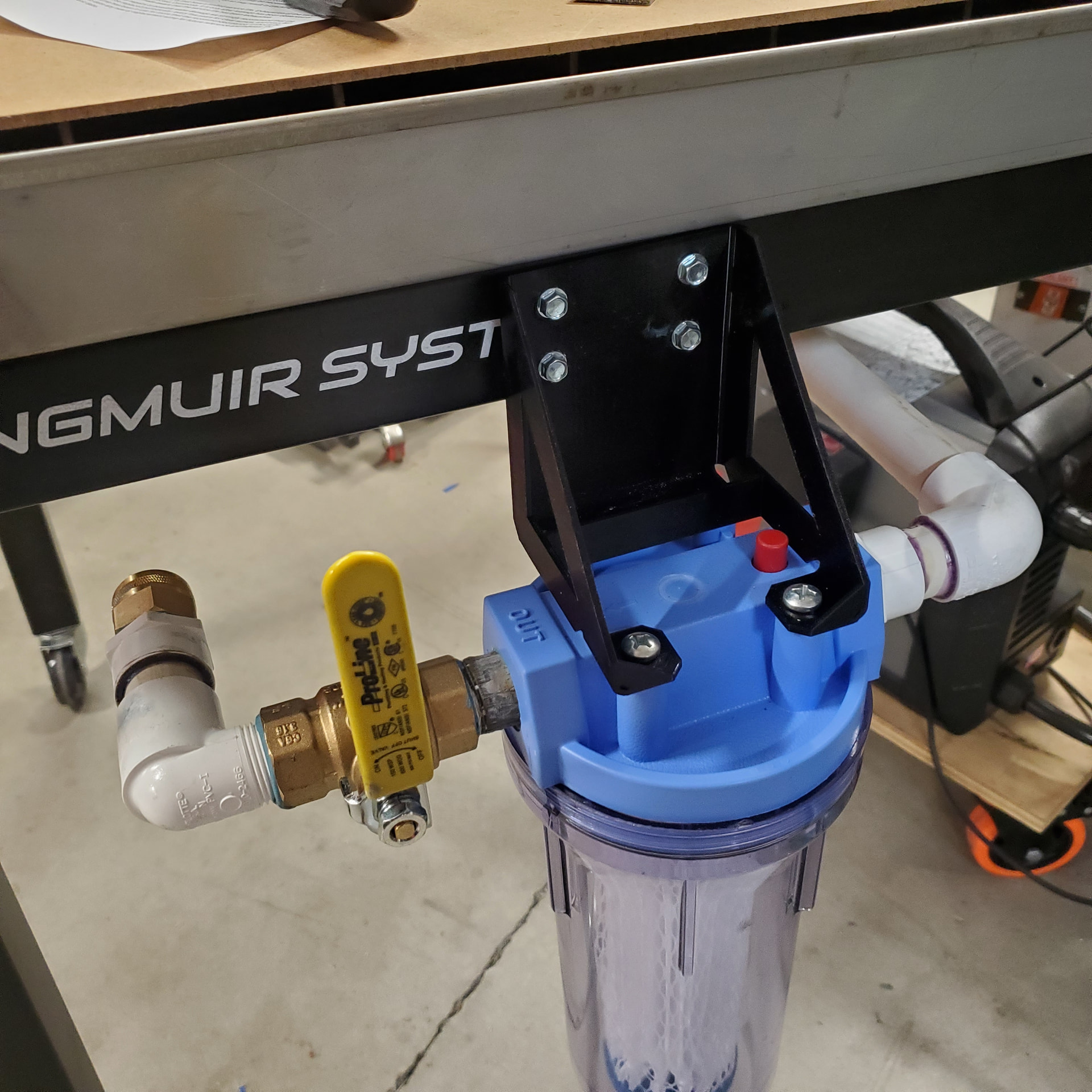

I have my storage tank installed and working. Until I build a platform / shelf under the table I have the tank and plasma cutter on little carts, and everything is working great! I probably could have used a smaller filter, but it’s fine. I 3D printed a bracket to hang it.
