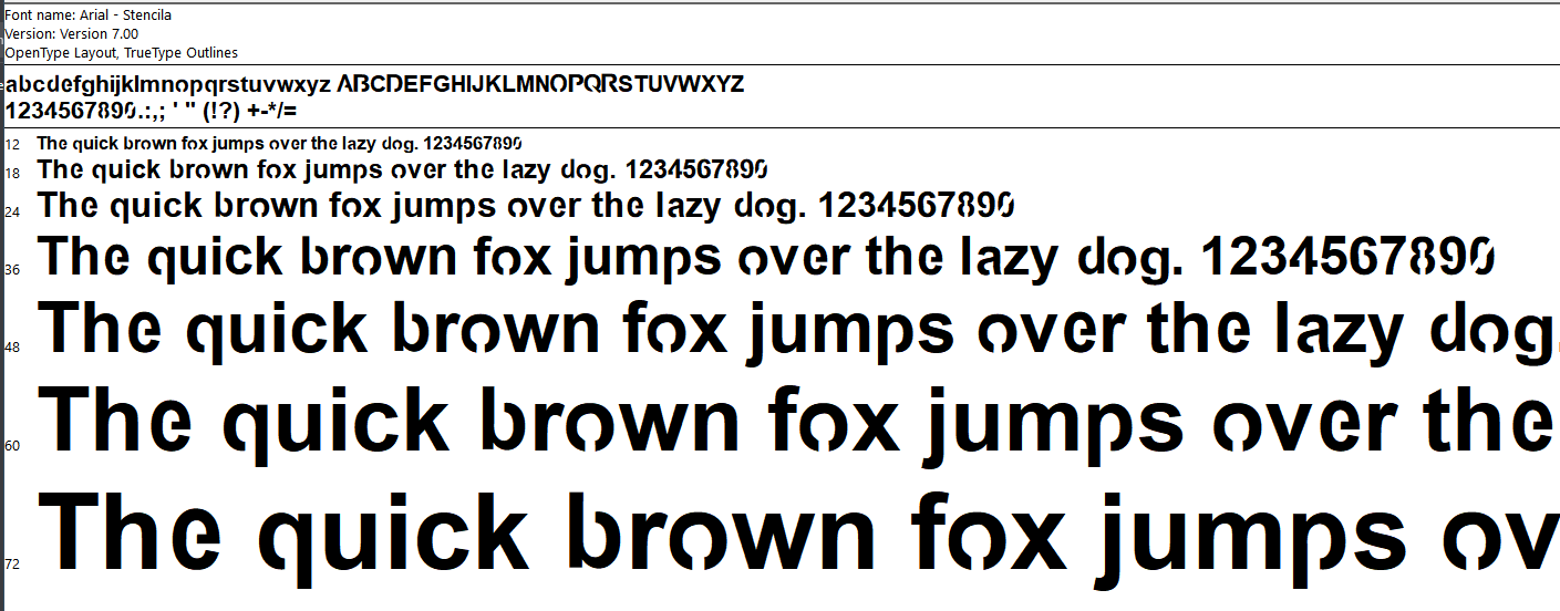

Here is a stencil font of Arial that I did.
Remove the “.pdf” from the file name to use:
Arial-BoldStencila.ttf.pdf (906.9 KB)
Note: the gaps/bridges were made the size they are so that even at 1 inch height, the bridges will be strong. Not ideal for large text on signs because the bridges will be quite noticeable.

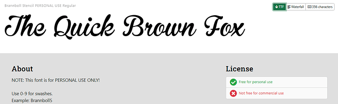

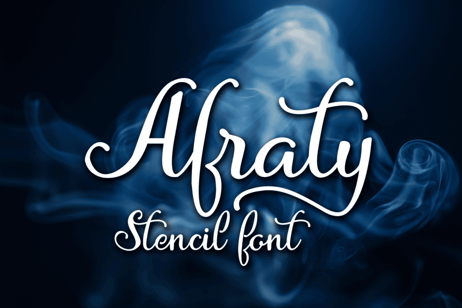

Thanks Craig. I found this interesting one that does not look like a stencil (similar to the Alfraty that you showed):
A person could get lost in all the options. Still not finding any other rotated text than what Tin shared.

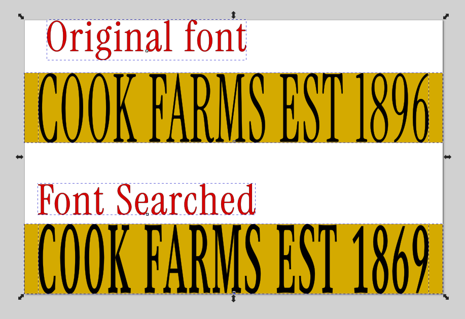

This is a Great tool. I had a font a customer choose for a sign. It was kind of narrow and and did not offer a bold options. I used inkscape to make a white background with black letters and then did a simple screen shot of the found the customer choose. I used the link above and found a found that was practically identical but thicker. Cool Tool
Original found was Instrument Serif
New font was Generis Serif W04 - Bold
Then I had to stretch the font in the size needed 28”x5”
I hope you fixed the date on the final design! :grimacing:

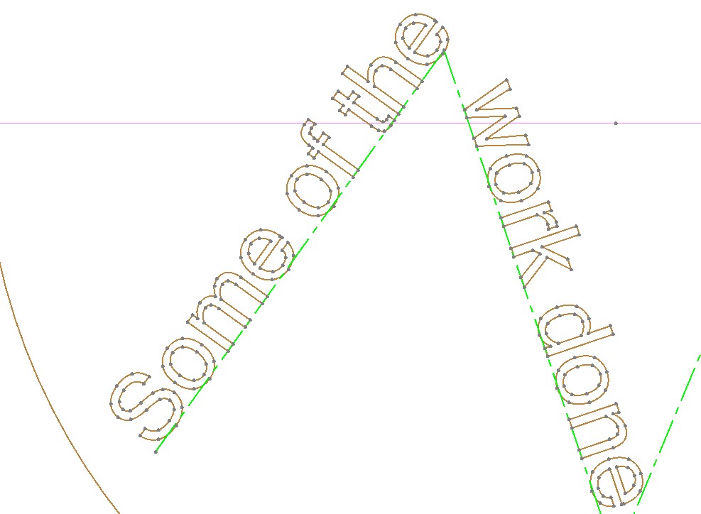

Follow up on my recent cutting of First Font in this thread, called Arial something or other. This did fairly well for me. The Capital R came out one size bigger than it should have. My tip might need to be changed to sharpen up my work. The project is “just” for me, so I am not too worried about it. It could use just teeny bit more space in the inch tall cuts for best results. It is the best font I have found so far. What I cut was, “SCREW DRIVERS” for a little rack I made for the set of 10 Milwaukee screw drivers that is currently on sale. If I can get a little chance I will post it. I was cutting 16ga aluminum. Not pretty like Craig’s laser project.
I think that I have to go so slow to make round holes round that puts a lot of dross on the back side. The cuts I make going full speed look really good. I just cant go full speed with Letters and small technical details.
I just noticed that you can see the slightly oversized “R” in the caps pic below. I copied it from up above.

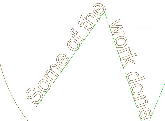

I also noticed that some CAD programs allow for exploding the text that is made…
While in an exploded view, one can alter any text given. Although time consuming, you can actually write your own fonts and change things to suite your needs a little more than grabbing some already made fonts that may have licenses on them.
Seth
P.S. For instance, in alibre, I use exploded view to handle font and other ideas:
See. Now the text is not relying on the already-given font(s) and I can alter them from that point forward.

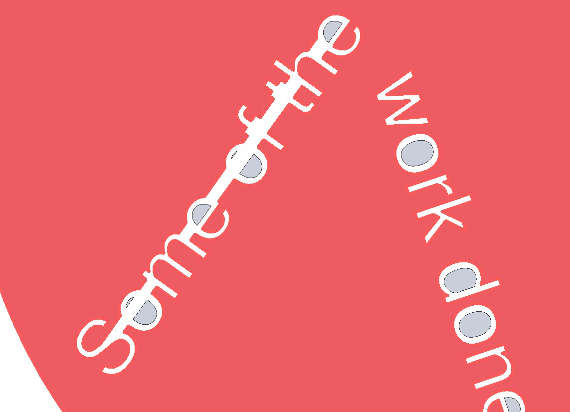

I am back to doing as you are pointing out. The problem I found with the bridged/stenciled fonts: they might be either too small if you use a small pt. size (or whatever it is called) or the become larger than necessary when the letters are enlarged.
The stenciled fonts work really well when there is an entire page of letters or when you are in a hurry. Or when you have a project that is bound to use the same font on everything.
Also, I saw where some people just put two lines or a rectangle in the center of all the letterings.
Then, trimming is possible around the rest of the numerical values or letters. As an example, I did I quickie of a CAD to show the strike through the lettering… Of course, it could be better.
