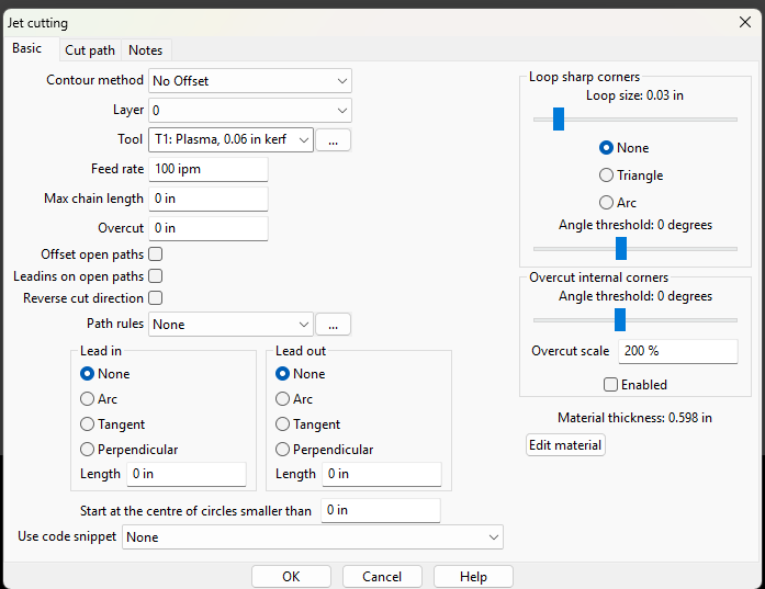

I assume this is what you are talking about
good assumption, and it looks complete enough to make a cut. Reverse cut direction is preferred for plasma process, yields more square edge on the save part. Leadins are usually preferred also, makes for less ugly start of cut as pierce holes will be larger than the kerf width.
I see you’ve been a member for nearly 2 years, are you just now switching your workflow process to use sheetcam ? I’m trying to understand your plasma CNC experience level as some of these questions and observations of missing detail seem very fundamental. We all here to help, just need to know where to onboard your experience level.
The most common reason for that error is not creating a Jet Cutting operation before hitting the post process button. Sheetcam will not warn you that you missed a step in the process. It will just post process and output a file with only the basic information that the post processor includes.

Yes that was the step I was missing. I don’t know if it is documented someplace and I missed it, but I appear to have a file that will cut now. It worked on dry run, I’ll try for real tomorrow
