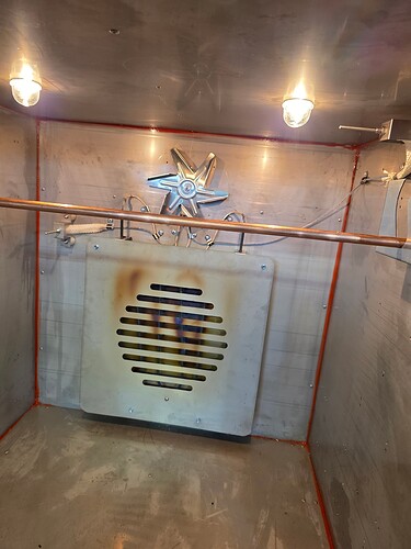

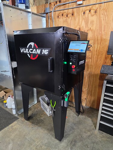

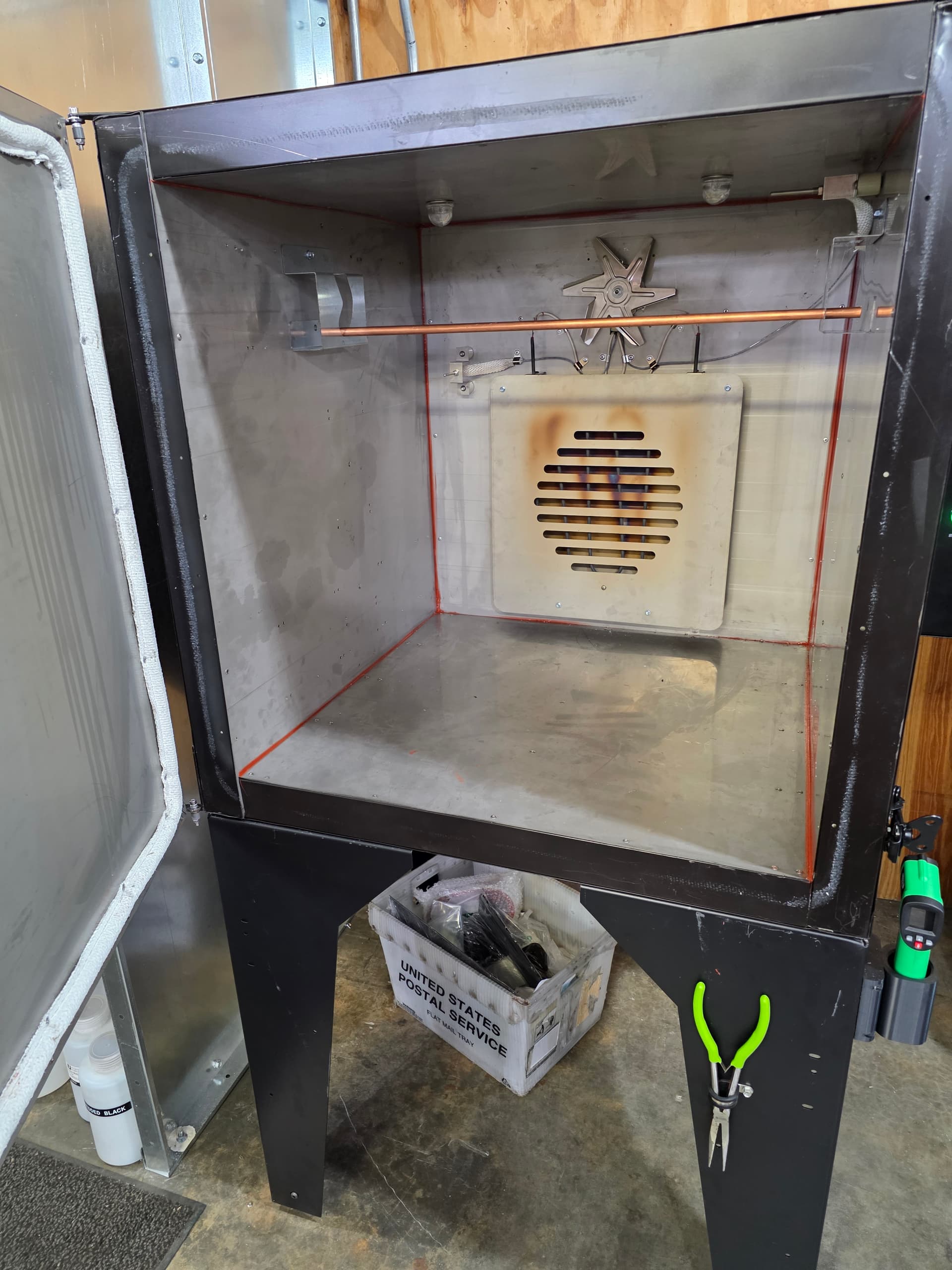

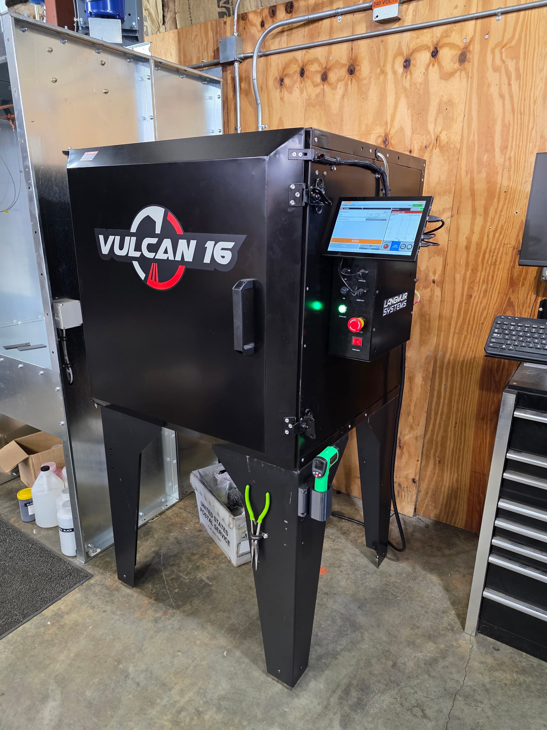

Well, I was allowed to test the new Vulcan16 oven pre-release. I have had it for over a month now. I was sworn to secrecy till the official release with a non-disclosure agreement. We worked out production and software bugs, including shipping packages. It will come in three boxes, each weighing about 100 lbs. FedEx delivered mine. Ugh… This may change as they evaluate the best shipping method. It took about 3 hours to assemble the housing. The electronics kit, lights, and fan, which took about 2 hours. It will run off a laptop or computer with CureControl installed if you opt out of the Pro electronic kit, which uses an Orange PI board with a 10-inch touch screen.
I have to say it is now working perfectly—almost no heat escapes from the housing due to the rock wool insulation inside the oven panels. Even at a 15-minute cure cycle @ 450 degrees, the outside was only warm to the touch. Here are some pictures of the oven. The inside dimensions are 30 x 30 x 28 deep.

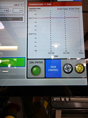

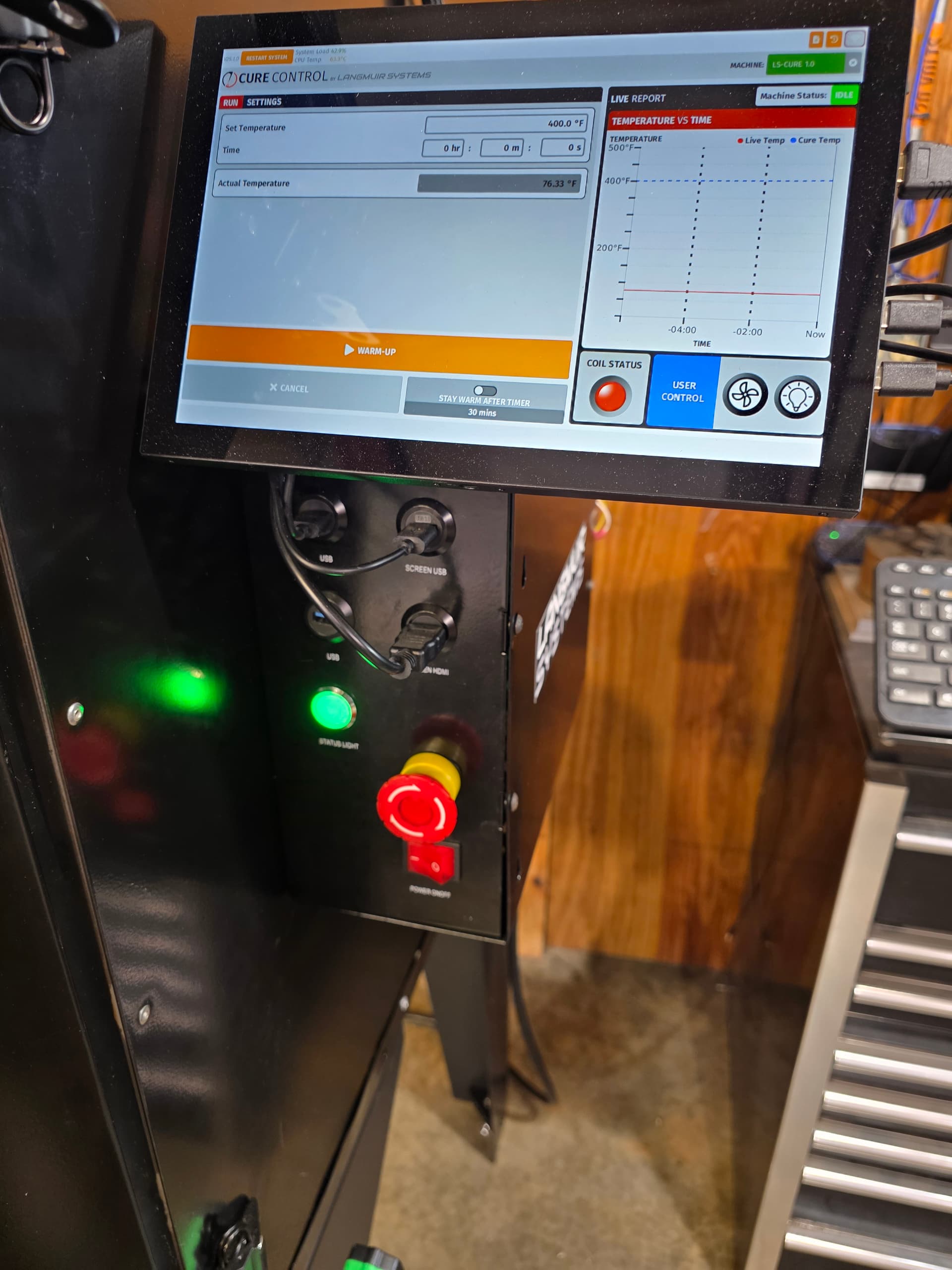

As you can see in the picture of the CureControl screen, it tracked at 400 degrees within 2 degrees up and down. The lights and fan speed can be set and turned on via CureControl.
At the $1200 price tag. This oven is a no-brainer.
My recommendations are the light kit, leg kit, and fan kit.

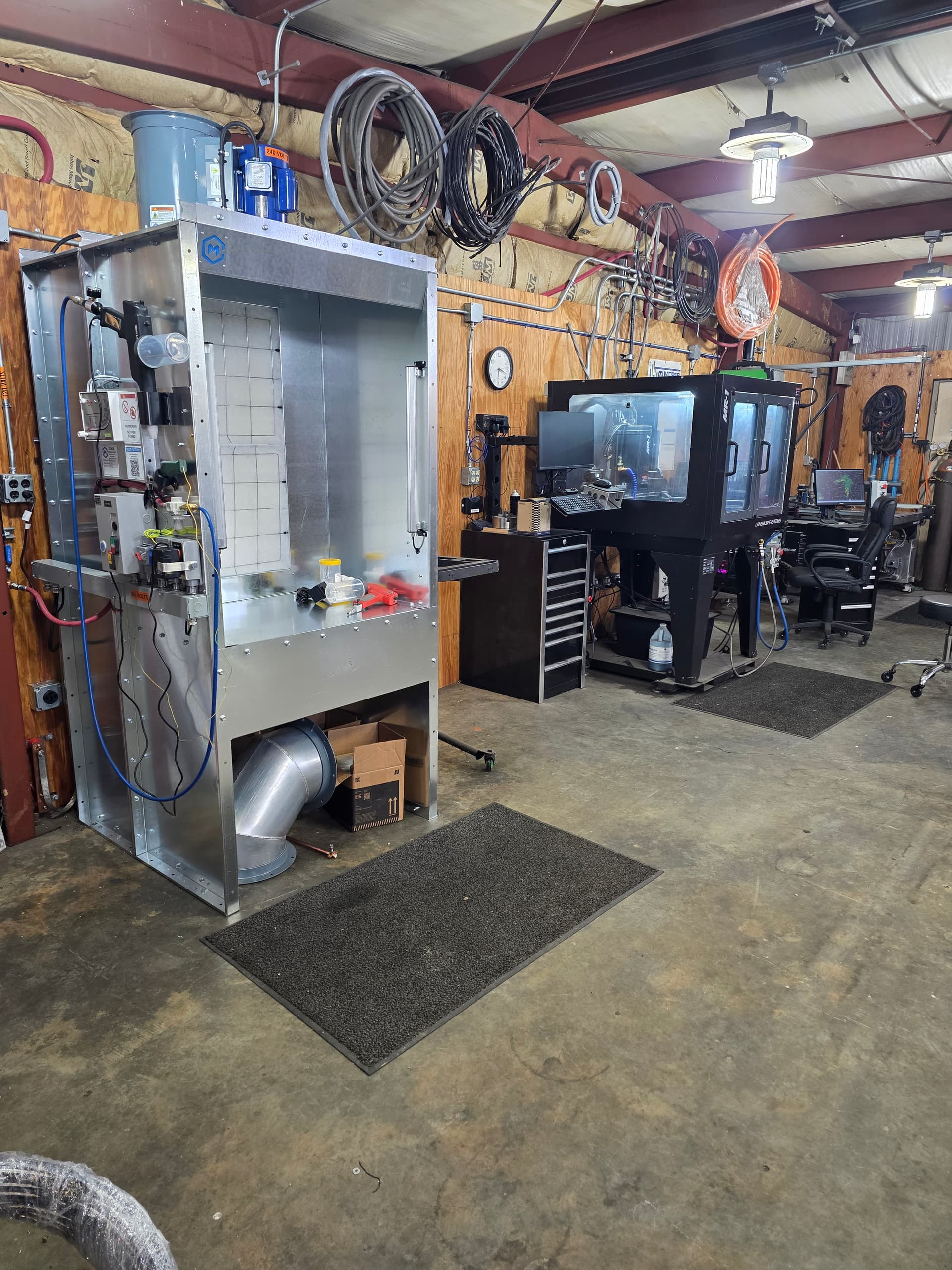

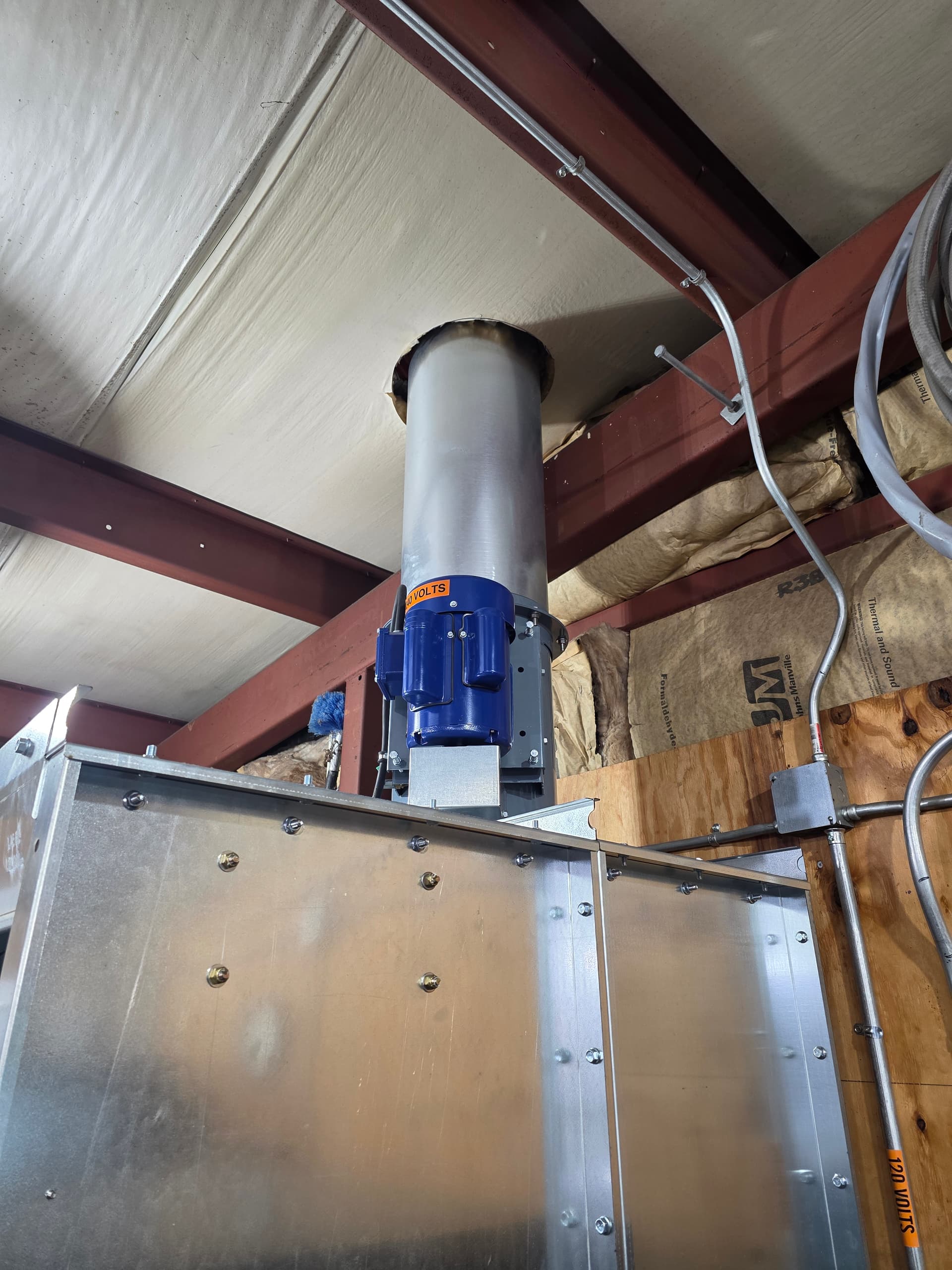

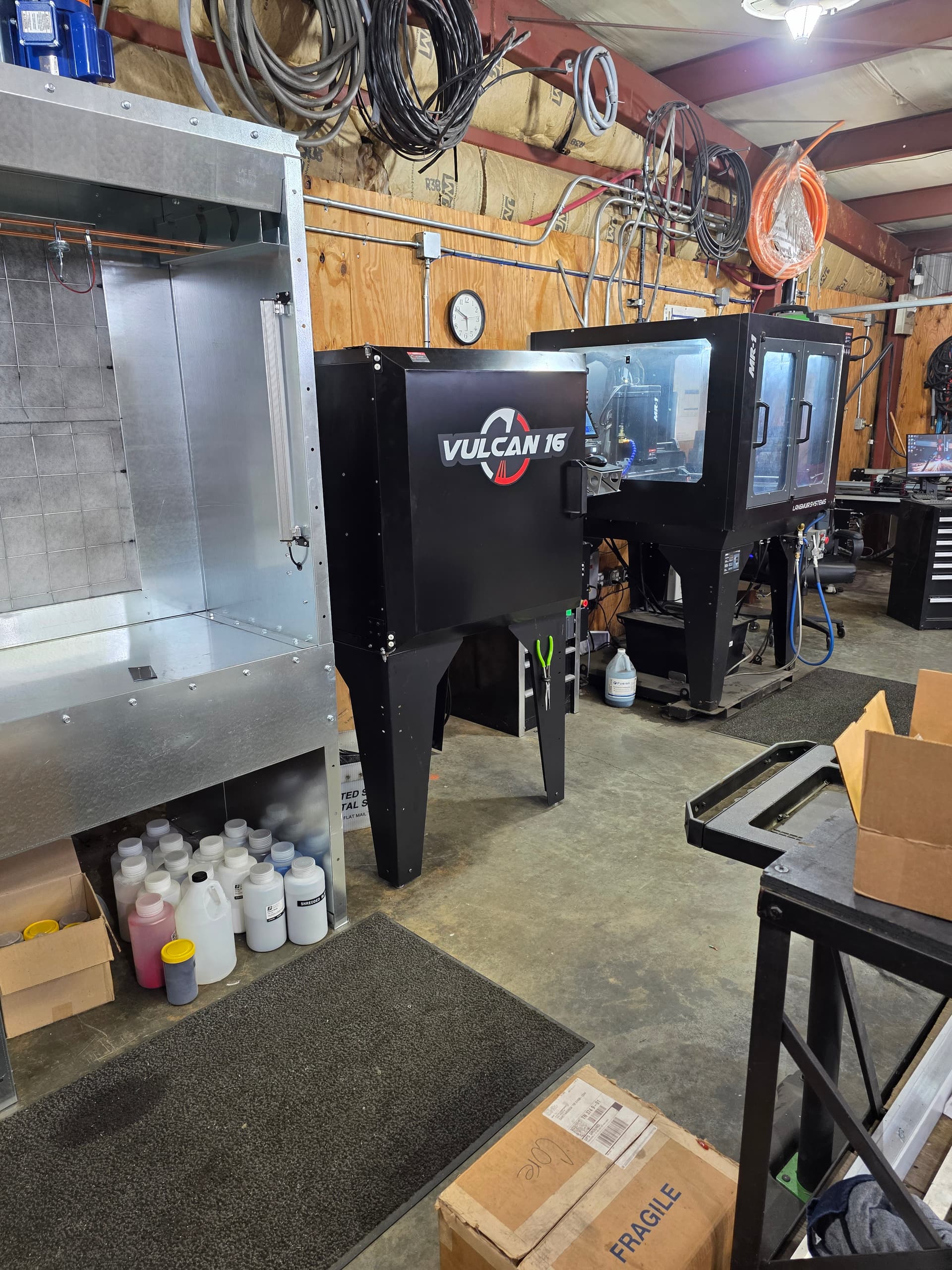

What are you using for spray booth, looking to be able to do power in house vs sending every small part out, this oven will be perfect for that, now to figure out the rest of the setup.
Cook manufacturing 3x5 booth. I just got this new booth several weeks ago. $2600

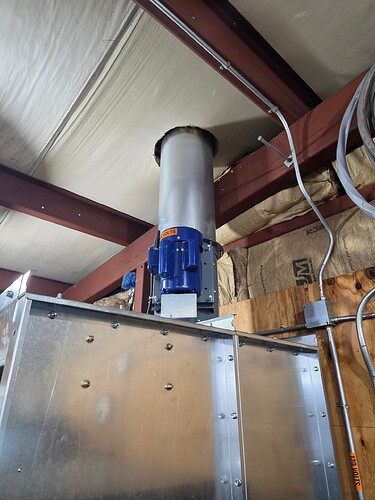

Does that exhaust outside? Can you clean the filters?

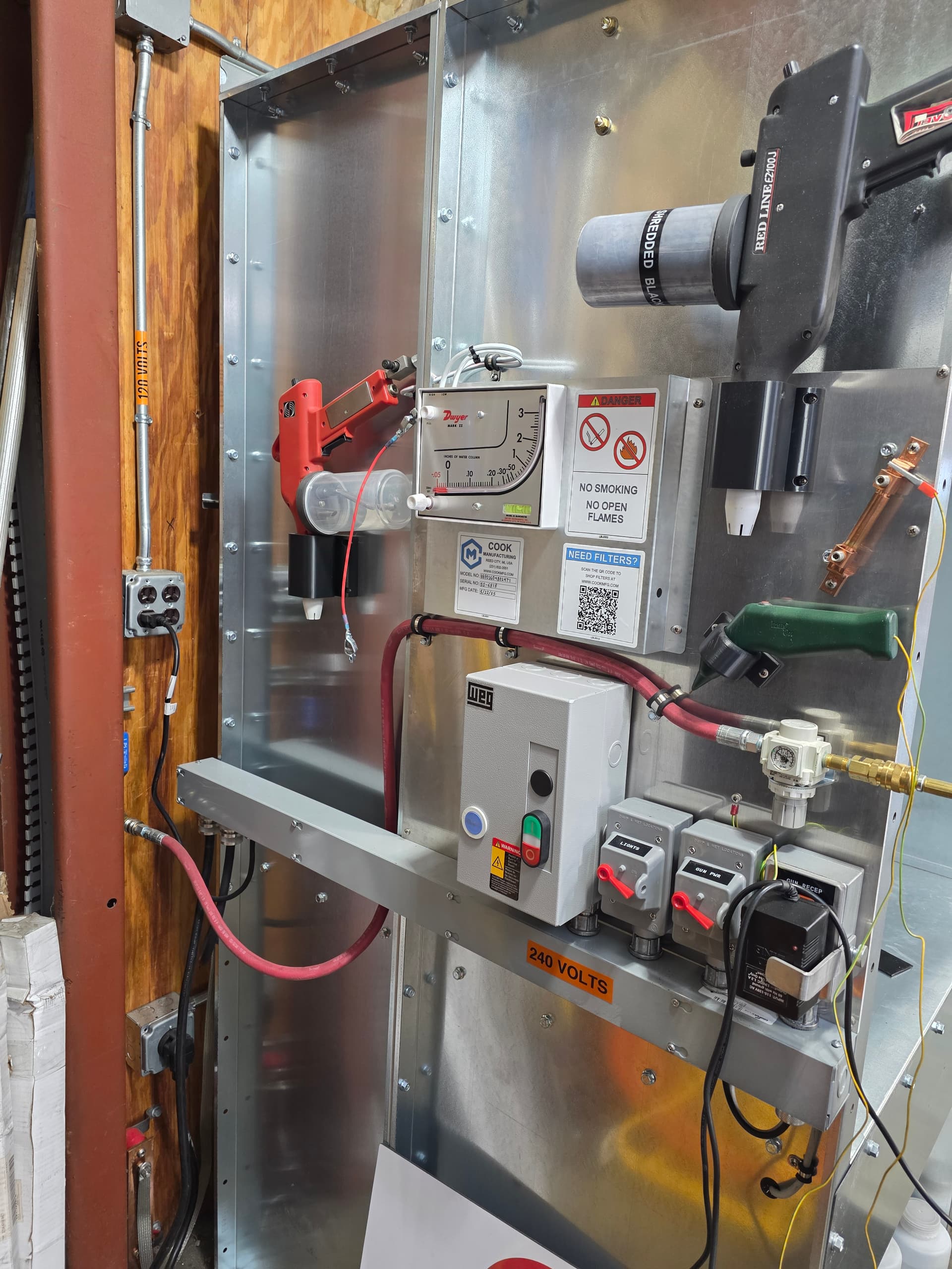

Yes, 12" exhaust fan. And yes, the filter can be changed when the differential pressure gets too high.
Can you clean the filters or do you have to replace?
I buy new ones. But you could clean them, I guess.
I used to use round Dwyer manometer gauges at work before we had digital units. A great brand for that kind of SP (Static Pressure) measuring.
