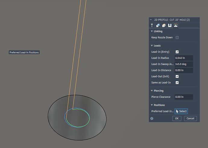

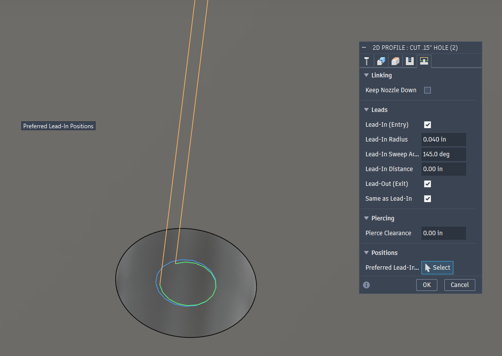

If you cut the holes out in a separate operation. Pick the center and then turn off the lead-in and lead-out boxes. I cut .150 holes on occasion. Here is the issue. The plasma arc will case harden the steel around the holes. They will eat the best drill bit up like butter.
After the holes are cut, your next operation will start with the outside edge.
Pierce clearance should be .12 at least, that has worked for me.

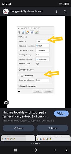

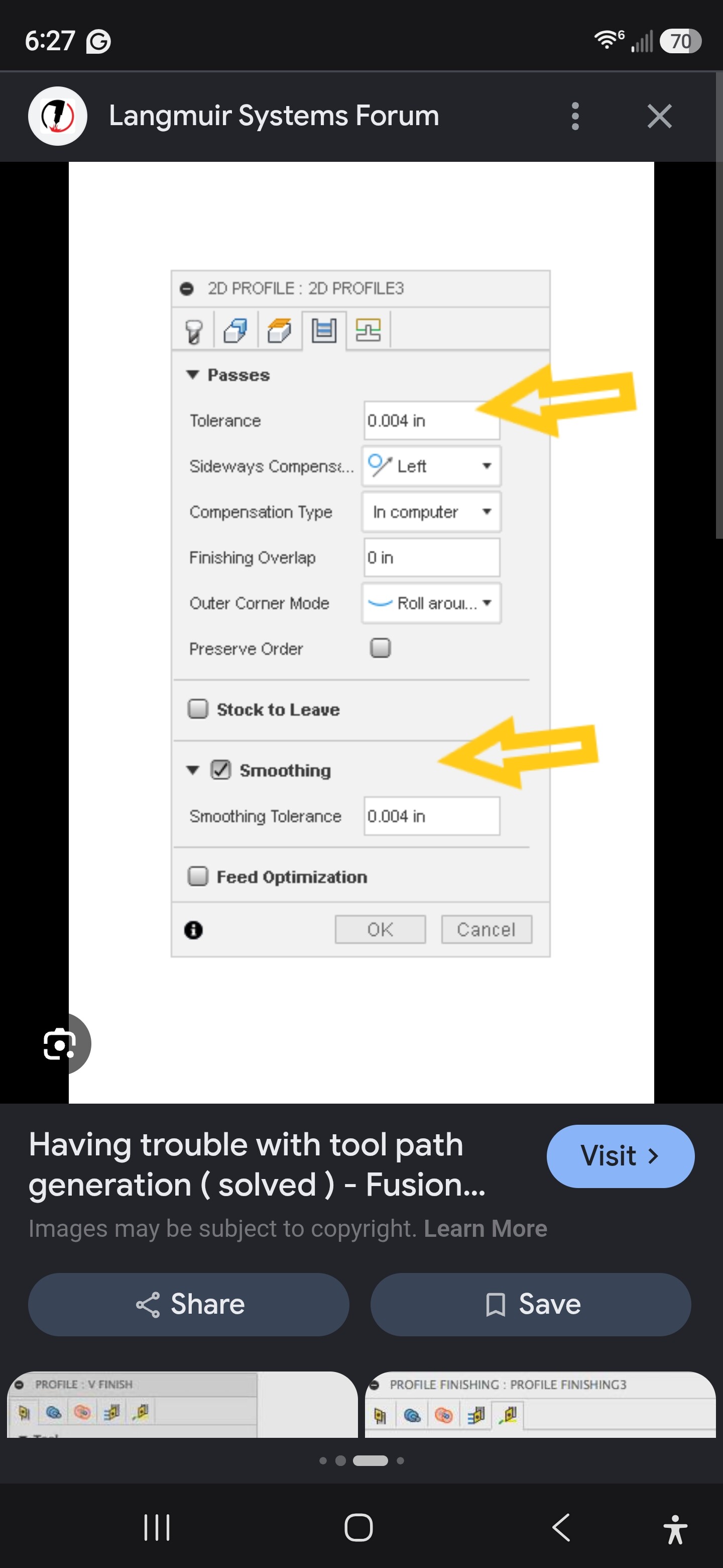

See the sideways compensation. Change it to CENTER. Just for the hole operation. Disregard the arrows. It’s the only picture I had on my phone.
Watch this video. It has nothing to do with holes but it explains the multiple operations scenario.
It will explain the using the center compensation tool.

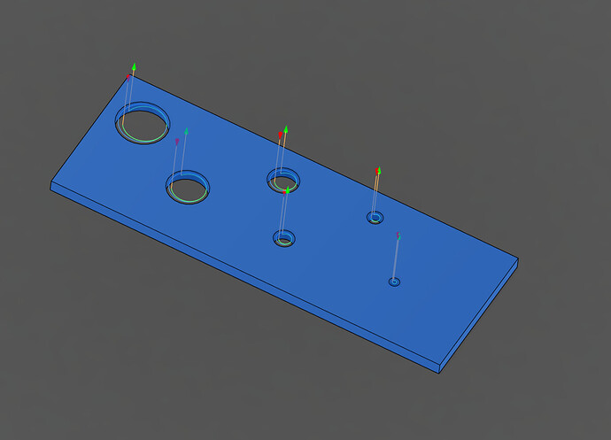

I have a template in fusion set to cut holes of .5, .4, .3, .2, .15, and .1 Those are in inches sorry international friends
They cut well and I have very little hardening (most of the time) if I need to ream them more.
I use a long curved lead in and out as you can see.
Here is just one example for a .15 “ hole

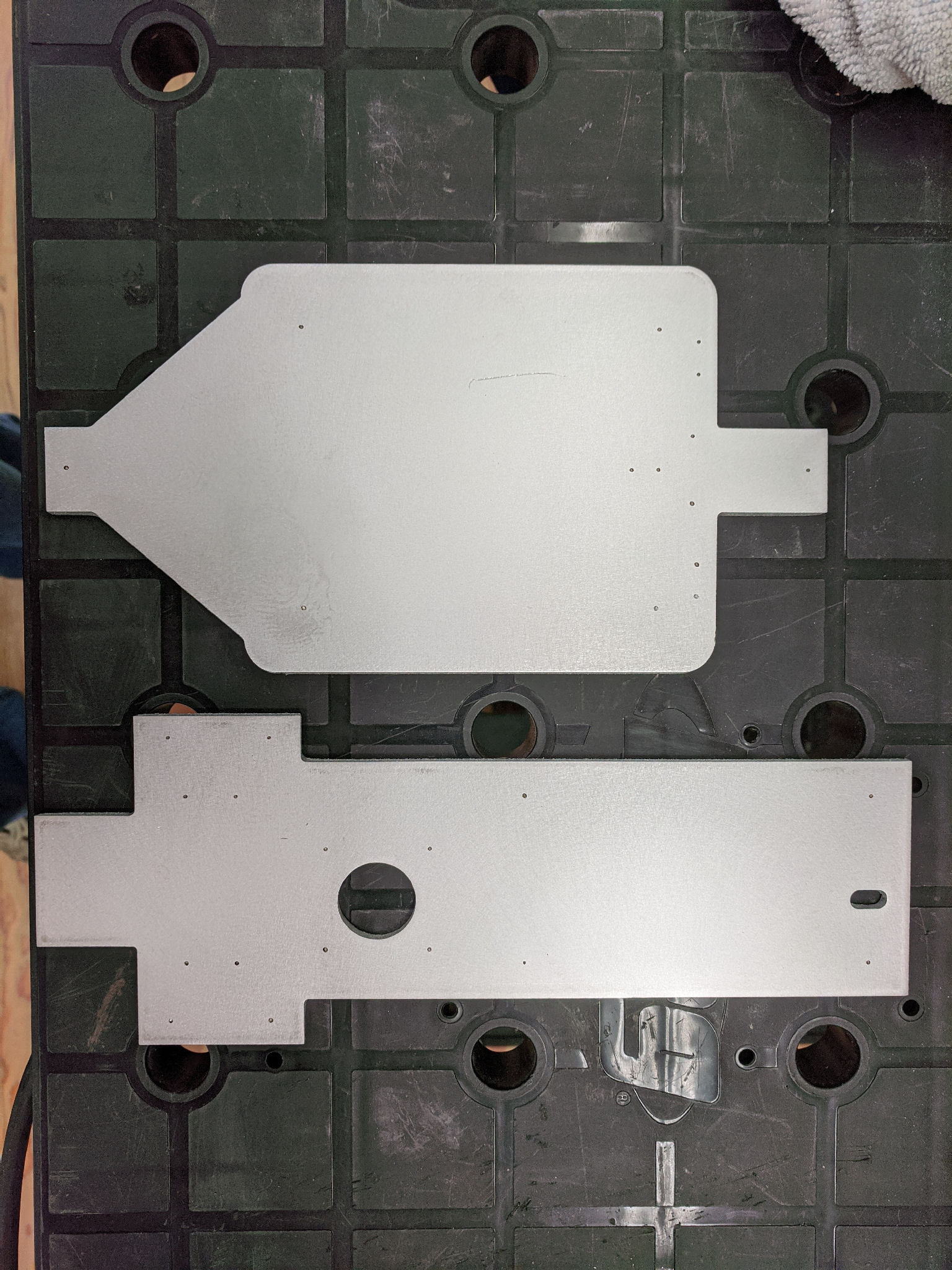

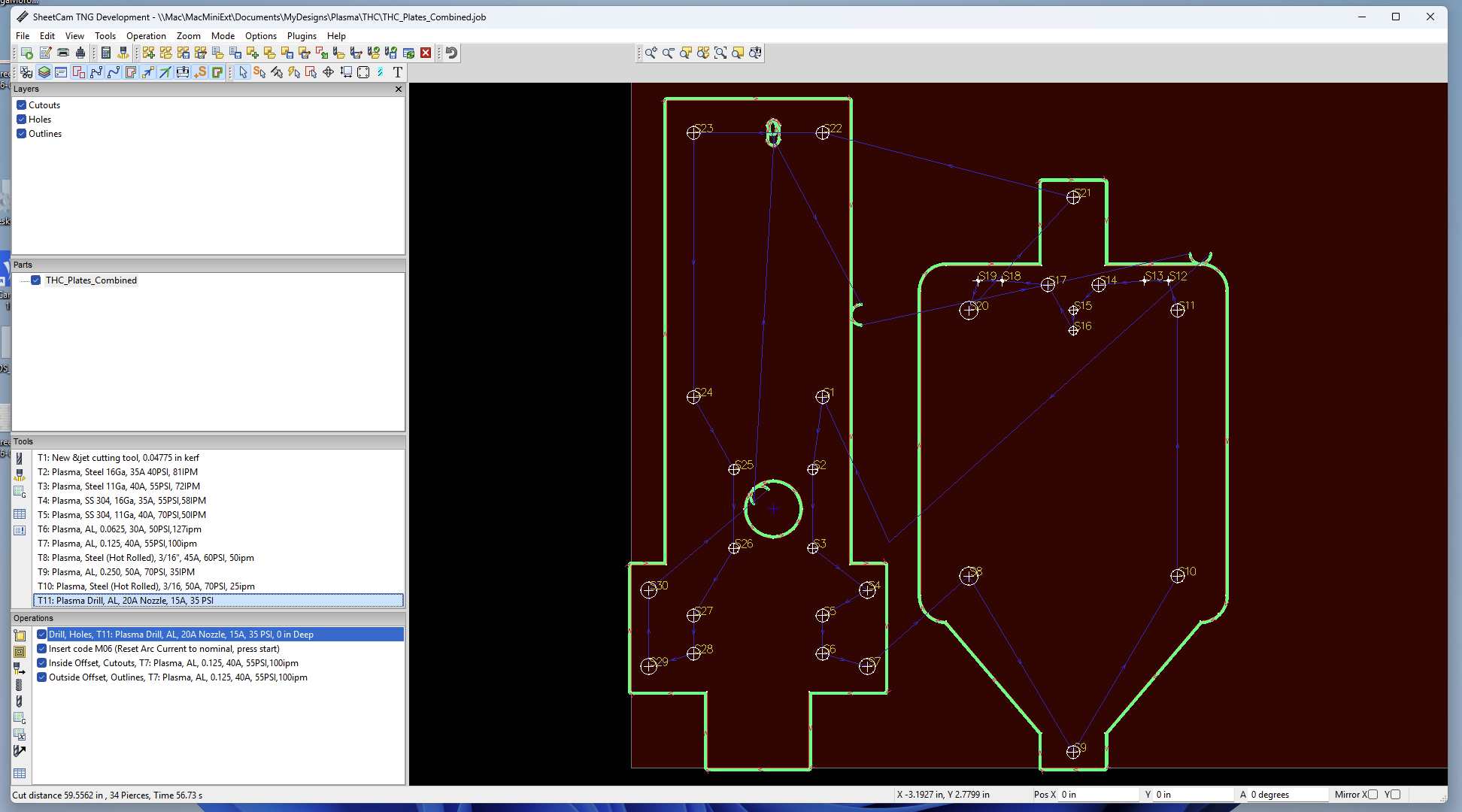

Here is the Sheetcam setup for the operation.
Settings are in the description:
20A Nozzle, 15A setting, 35 PSI
Pierce Delay: 150mS,
Pierce Height: 0.093”
No Cut: Drill Operation
And here is an example:
For example, the two holes on the top right of the top plate were then drilled and tapped for M2 screws to mount a limit switch where the holes HAD to be 9.0mm apart. No problem.
So you actually do a jet tool operation? What diameter hole do you use in cad? Seems like I can remember a conversation where someone use the drill operation as well.
This looks friendlier for plasma CNC compared to Fusion. I’m assuming SheetCam is specific to 2D cutting operations? I may switch and give it a try, I like that result you have.

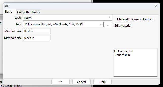

I do do a drill operation and, in this example, it uses the T11 Tool.
Here is the whole setup for this job.
The drill operation, applies to ALL holes of a certain size (between 0.025” and 0.625” in this case) as in:
So you can see in this job, I ‘drill’ all the relevant holes, insert a ‘pause’ so I can change the Plasma Cutter Cut Current, and then it goes and cuts all the pieces out of the stock.
