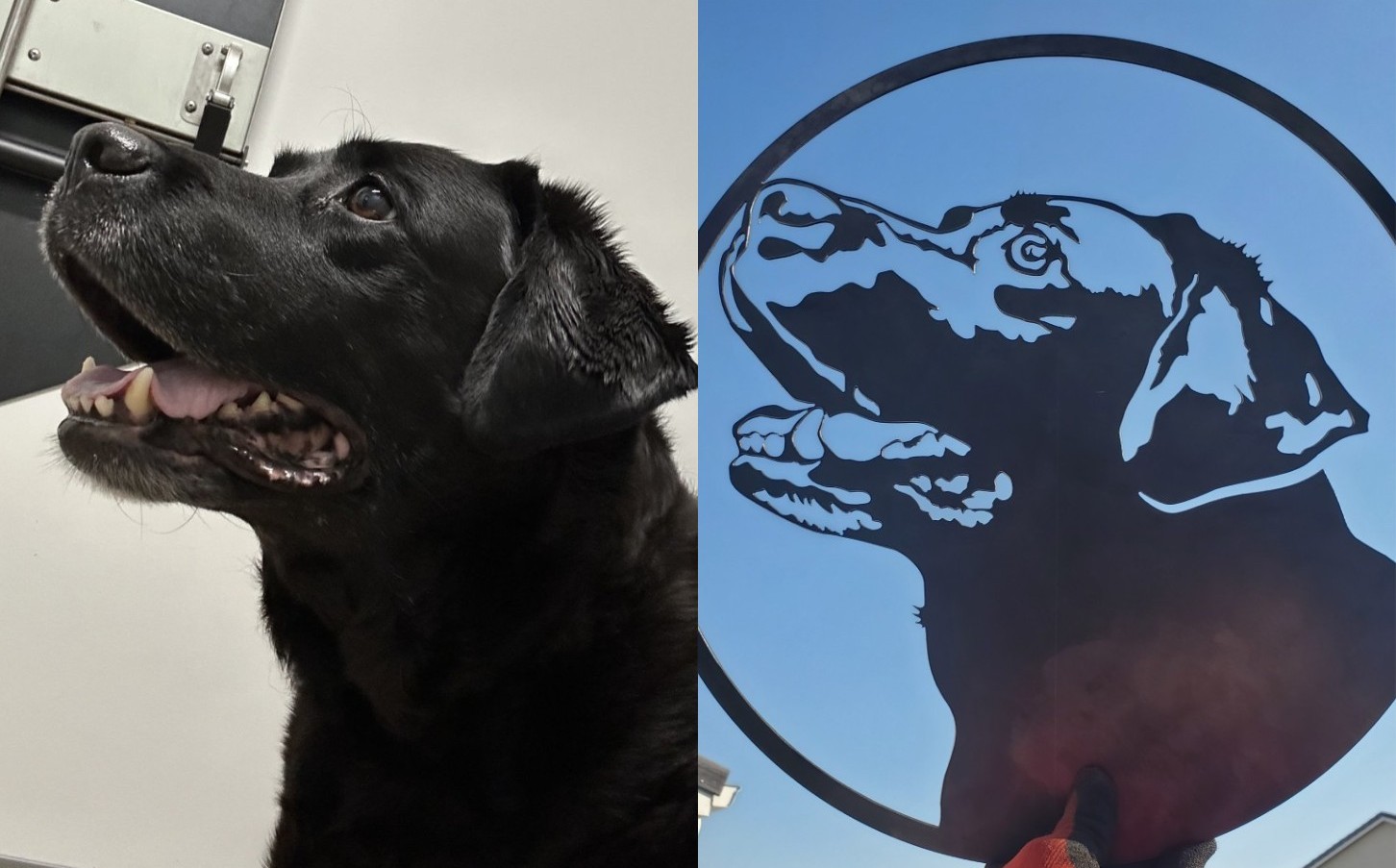

Here’s one example of something “unique” or intricate.
Can you share what issues “show” on Firecontrol that aren’t shown in Sheetcam? I’m guessing something like a lead-in for example where you may not have the tab enabled to Display, or something similar.
Screenshots would be a huge plus.
Wow, that was quick response from gallery.
The tool path does show in Sheetcam but it doesn’t show correctly in FC. I’d have to get a screen cap of the FC screen to show it. I’m done dinking around in the garage for the day so I’ll have to get it tomorrow.
Question for you Kwik, what software are you using to convert the jpg to a line drawing? That looks real good!

Adobe photoshop, and illustrator.
I edit the image itself, then finally use illustrator once it’s in a “basic” format, and bring it over to Fusion as an SVG for processing.
It’s all done manually pretty much.

Thanks for the response Kwik, you do pretty much the same process as I do except with different “tools”. There are some pretty good online utilities for converting a jpg picture to a line drawing. They always need clean up though. They usually leave some artifacts that sometimes are hard to see. I also used an cloud based AI type editor to remove some background stuff. Worked pretty good to be honest. I use Inkscape to do the final editing on the SVG file. Then off to SheetCAM.

I’ve seen a few tools online, but in my experience the results were terrible.
I also don’t use Inkscape at all so I don’t even know how to do anything on it as I don’t make signs. I figure anyone that does artistic stuff could knock out actual photos much better/faster.
