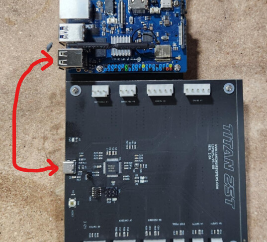

The connection causing that empty LIVE REPORT display is this one:
I would double check that that is plugged in. If that does not work, then I would swap which of the four USB-A ports the cord is plugged into on the upper CPU. If that does not work, then let me know and I can get you sent out a replacement control board. The contact email for that is support@langmuirsystems.com
I appreciate the response however I can’t troubleshoot this issue until I get a working SD card back in my machine. any thought on my last post about flashing a new SD card?
I also sent an email to support. If that’s you getting the support emails, I’m sorry to attack you from two directions. I am just desperate to get a solution. Thanks
Some brands of SD card don’t work that well. I will get you out some replacement parts right away. Thanks for sending that support email so I could find your account.

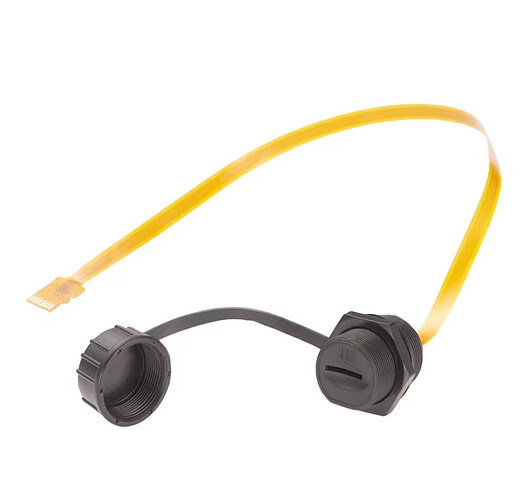

I wonder if someone could retroactively install something like this to have a remote exterior location for the SD card.
https://a.co/d/4mASPlH
I have, and it works great. I had to mount it on the side because the cable is only 12 inches long. Mine is just like that, but made of aluminum. Ensure you purchase the model with a 12-inch cable.
I ordered one. My frustration over this and the subsequent delays made me want to burn my garage to the ground and walk away. I am better now and thanks to help from my software engineer father and the responsiveness of @langmuir-sam I’m back in business and the machine is functioning well but if I had another incident where I could not recover a dropped SD card I would resolve the issue with a plasma torch and a hammer.
It’s a really good idea. Though from the start we never intended for the customer to have to take the SD card in and out. It was only the requirement to overhaul the memory system of the machine that put us in that position. Hopefully we won’t need to request customers to do this again and future updates will all be USB drive updates.
