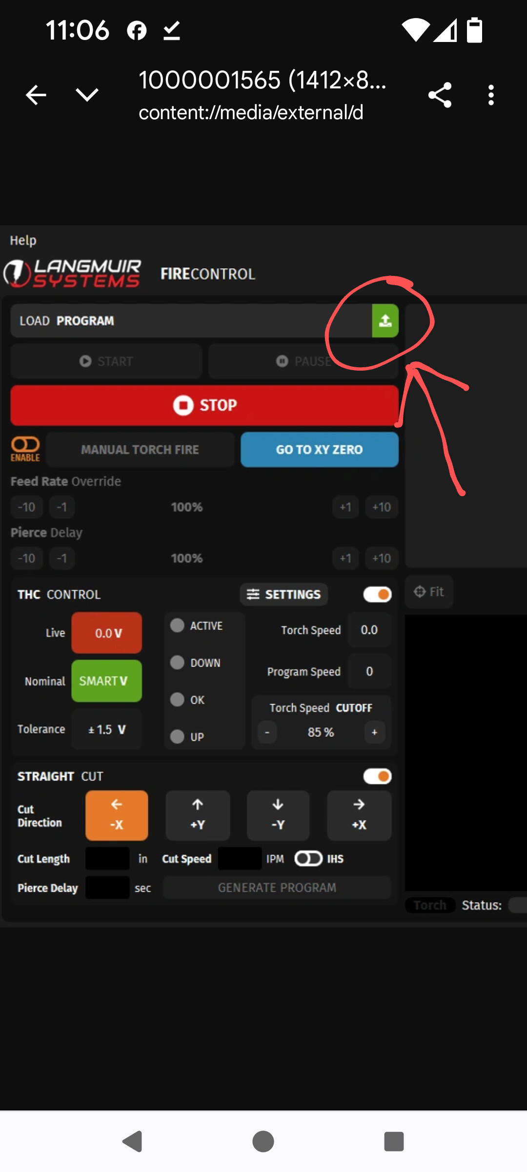

Hey everyone. I just got my first corssfire xr. I have been used to Lincoln Torchmate system, so this is a new animal for me. I can’t figure out how to upload a g-code to the firecontrol. When I download the file I want to cut it wont download to the firecontrol. I cant even open up my folders and drag the g-code to the firecotnrol folders. I have been trying to find any helpful videos.
In the upper left of the Firecontrol screen, there is an up arrow button. Click that and it will open a file manager window. Navigate to the folder where your cut file is located and select it

I have found that interface to be a bit confusing. They had enough room that the could have made a button the size of the words “LOAD Program” and it would have been self explanatory. (Similar to what they did with “STOP”.
