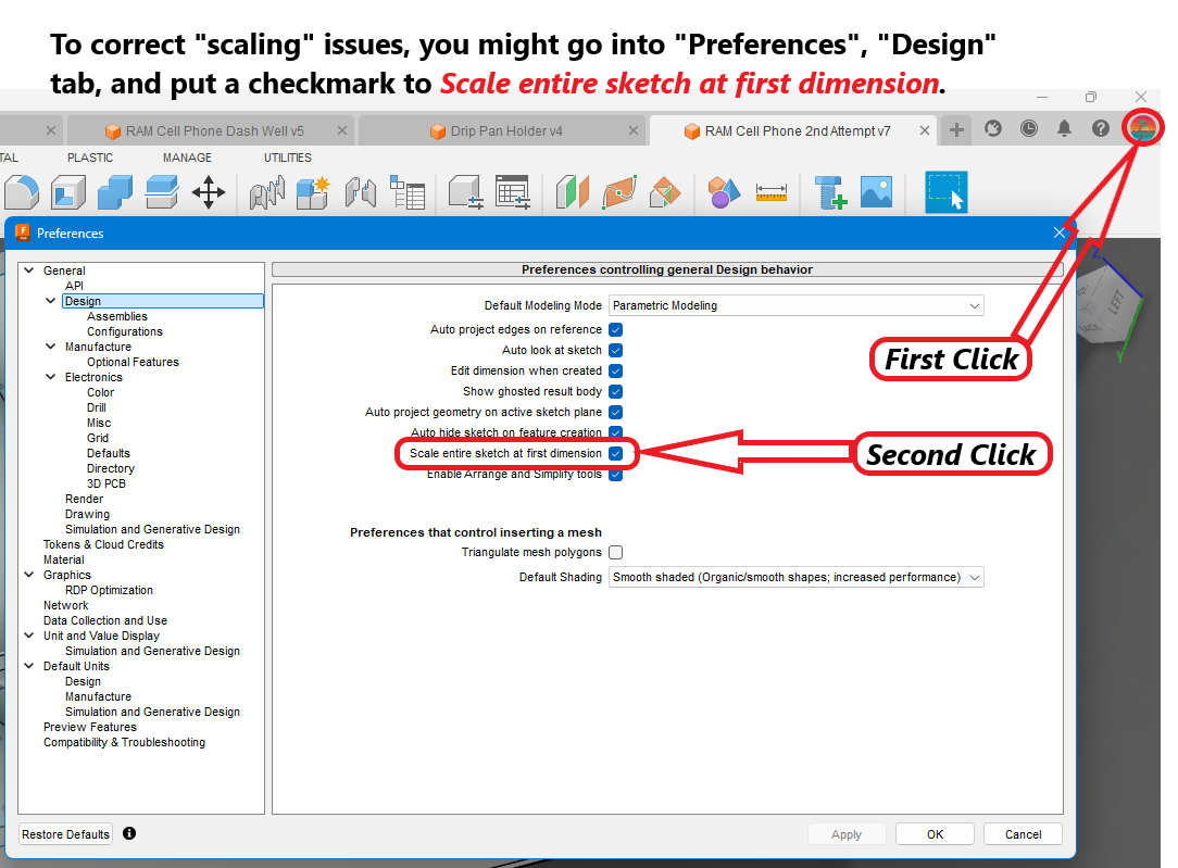

When I open the file which is in inches, it show up on the screen as mm. I have changed to inches in dimensions, but it doesn’t seem to take on all parts.

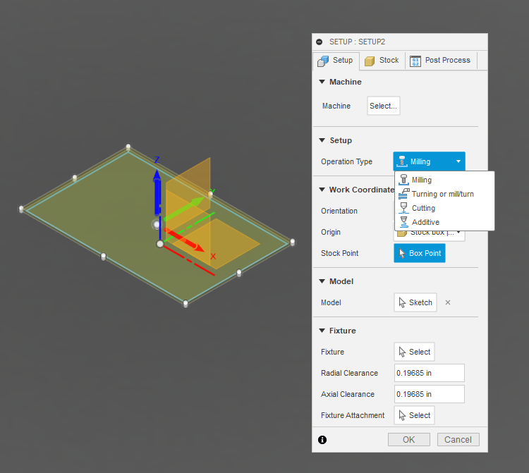

Problem #2 is when the image shows on the screen there are no grid lines or origin dot. I got one part into inches and got it extruded, went to set up cutting but fusion wouldn’t recognize my plasma cutter. I have never had that happen before.

For scaling issues, you might try this:

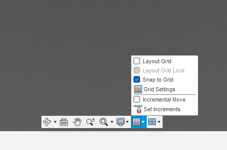

Turn grid lines on/off with the bottom menu:

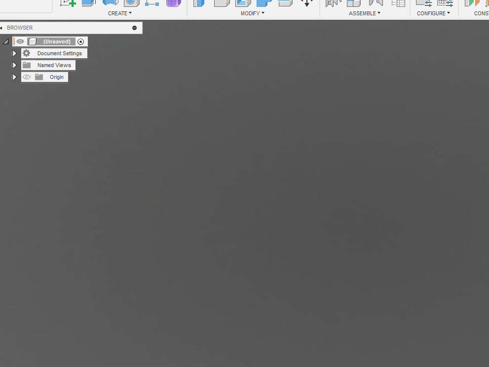

Turn “Origin” on/off with visibility eyeball on the browser.
Visibility off:

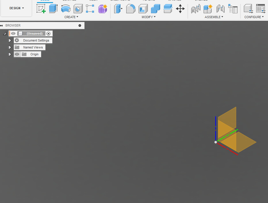

Visibility on:
You might just need to point Fusion in the right direction. If you are talking about the Setup screen in Manufacture, you really don’t need your machine in that screen but you want to make sure that you are in “Cutting.” After an update, Fusion 360, sometimes, defaults back to Milling operation. You need to change that you “Cutting” and then you will be okay.

@Erle It opens for me. Make sure you expand the file in Windows before you try to bring it to Fusion. The file is compressed… Then go to the import file on the top left. Pick your file from the download list. A screen will pop up to change it to inches from millimeters. The file will pop up as a small circle. VERY SMALL almost a dot. Roll the mouse wheel until it is the size you want. For example, the bottom plate is 28.5 inches across. Good luck
Can confirm it opened for me as well, just way beyond the horizon.
I think they are opening for you, but they are so far away from the origin and so small you are not seeing them.

To build on this the OP you can use the fit command to bring everything visible into frame. Myself I use double click on the mouse wheel to make this happen but F6 is also the hotkey.
