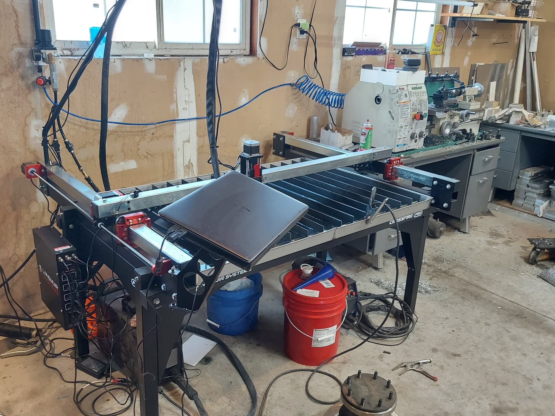

Hey all, I’ve had an ArcDroid for a few years and I’m about over it. I’m trying to figure out if the Langmuir PRO product would be an appropriate upgrade. I’m curious of the Langmuir user experience and to hopefully hear from others who has gone down the same ArcDroid to Langmuir path.
Here are my reasons to change:
  • Numerous annoyances such as: calibration never seems to hold (circles become ovals, squares no longer square), calibration sliding thing slipping and having to redo the entire process, lost accuracy the farther from the bot, Z height not properly being detected (generally happens mid part resulting in scorched metal instead of a cut at that feature), dxf importing path problems, and crappy pendant you have to use for everything.
  • 95% of what I cut is generated with CAD. Nearly removing the need for the “Simple Trace” software - the software that allows someone to trace out and cut, say a cardboard cutout.
  • The ArcDroid offers a compact package, but not when you actually want a stationary table. Once mounted (see attached on 36x31" table), it’s not much smaller than a Langmuir table but with a tiny work area.
  • Improved dimensional accuracy of parts
Ultimately I want a tool for my projects, not a toy that seems to generate just as much metal waste as parts.
My question to you guys: Are Langmuir products more reliable? Anything frustrating about them? Are there tracing tools? Any previous ArcDroid users here that have made the change?
Thanks!

ArcDroid to Langmuir update.
TLDR: I like the Langmuir more. No problems. Recommended this over an ArcDroid if you have a shop.
I got the CrossFire Pro with limit switch and THC add-ons. I run it with the LOTOS LTP7500CNC and Eaton 7.5HP 80 Gal compressor. Note: the LOTOS has a 0.6s trigger to fire delay you need to account for. The assembly is my only complaint as some items were not labeled, objects hidden in exploded view, instructions sometimes out of order. However, once running - is awesome. Haven’t had any trouble with SheetCAM too. A big difference is with the water table the amount of smoke and junk stirred up is significantly less. I burn-up less consumables as well with the better pathing and THC. The only reason someone should get the ArcDroid is if you need sometime portable. Otherwise, take more room up in the garage for a better product.
