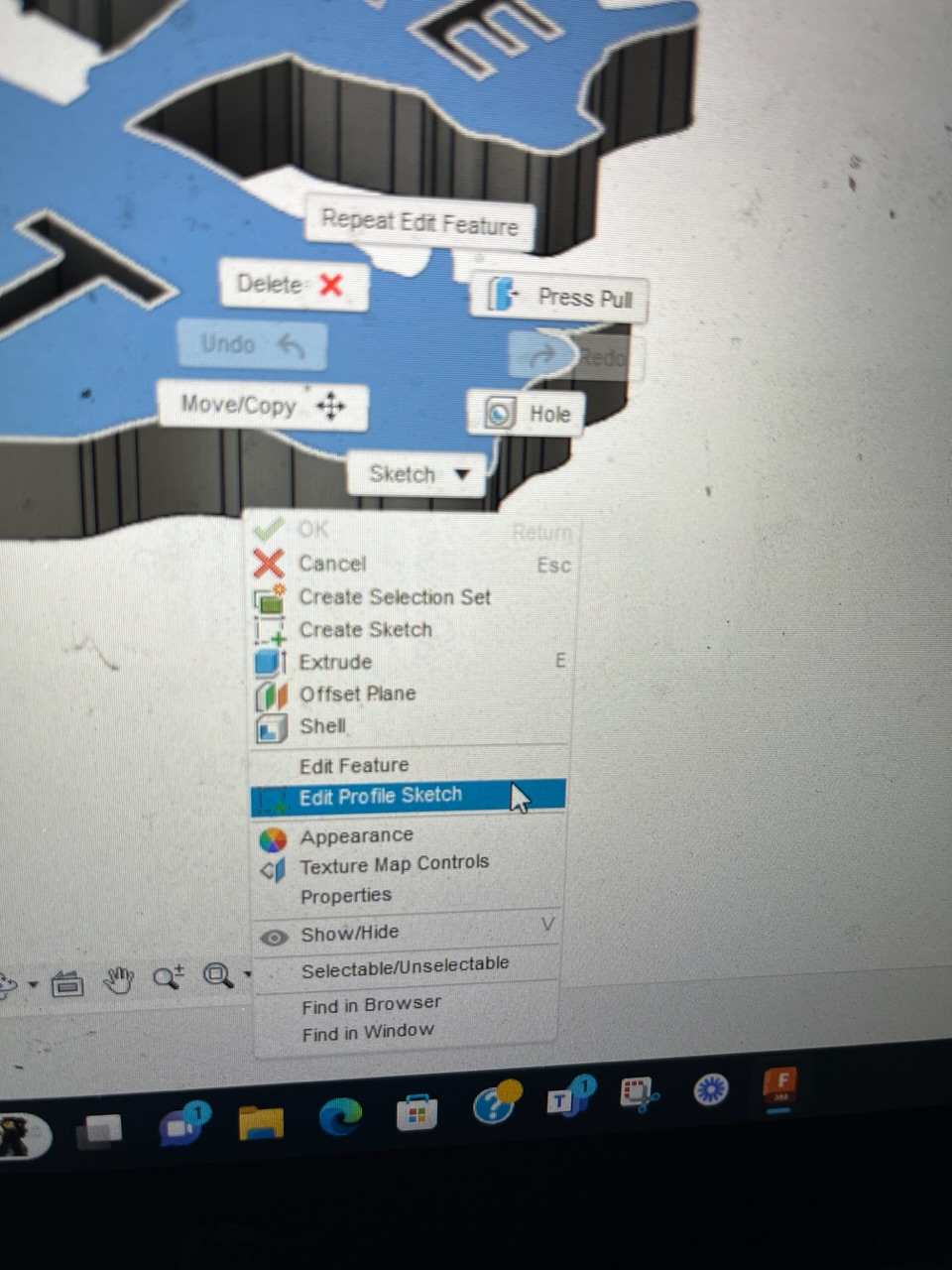

Just downloaded my first fireshare file and it seems to be read only and I can’t edit it. What am I doing wrong? Using fusion 360,
Sometimes it comes as a zipped file and you would have to extract the file first before you can execute it in fusion 360.
I thought I did extract it but maybe not. I re-loaded it (a minnesota map) and do I have to re-sketch the cut lines to make it work?
The straight lines were all light blue and when I re-draw them they turned black and are now editable. On the non-straight contures it is all black dots with light blue connecting lines. What happens there?

Try to right click on design and edit profile feature.
