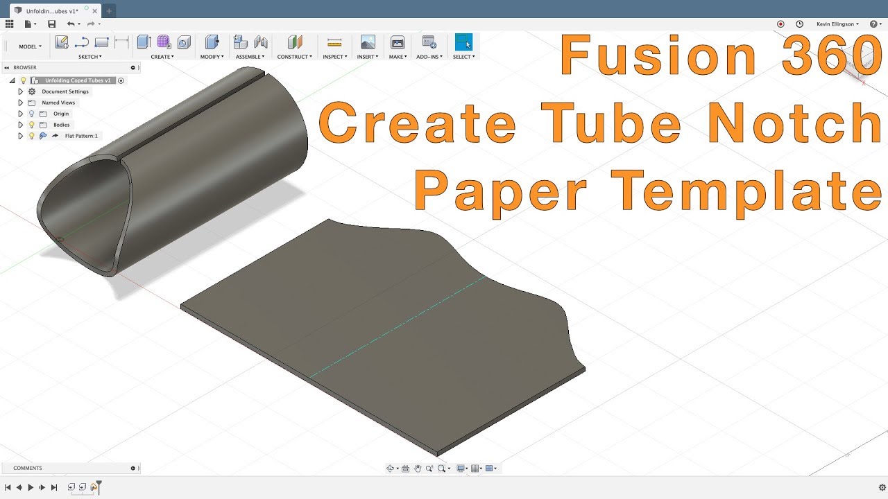

His slit method results in a split tube (non-flat) surface. Fusion’s sheet metal tool won’t let you select a non-flat surface to flatten from. I’ve seen a process where you split a tube, then extrude a small flat section, then use that flat section to flatten a curved surface. This works fine.
The method shown in this video may work. It is 5 years old so there is likely better techniques.
Yeah, that’s the video I saw several months ago. Thanks for finding it.
Tin made a video sometime ago for a circular fire-pit. It uses a small section that is not curved and then you create the curved portion as a flange. It is done in the sheet metal environment and by having the small section, it acts as the “stationary” portion for “unfolding”. That way you can make sketches on the unfolded portion vs the flat pattern. Perhaps that could be done with the pipe size of metal flange.

I found an interesting website that will print out a paper template for you.
This pattern could be traced in Fusion on the flat pattern.
