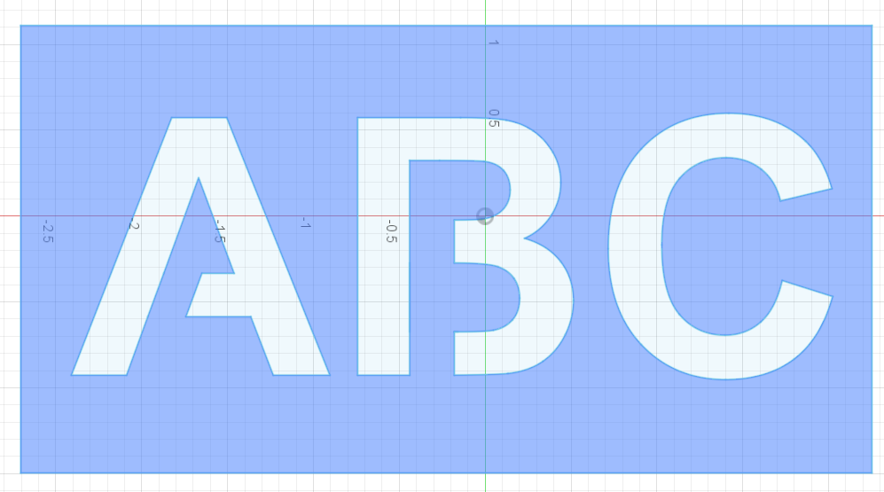

Generally, if you remove the most outer contour, all the other contours are reversed.

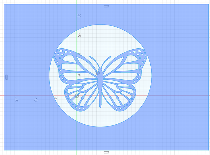

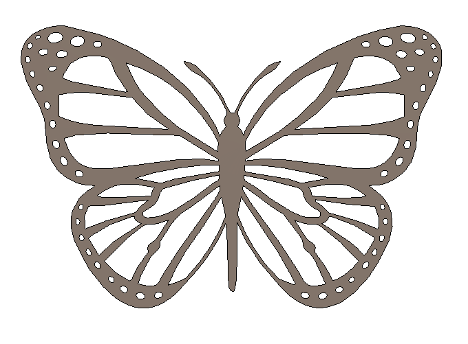

If you are using something like Fusion 360, here is another example. I would put the side of the stove/fire pit on one sketch. Then I would make a “body” out of the “side”. Then I turn on the sketch of the butterfly and cut into the side.
Of course you will need to chase the pieces that fall out and changing which is the open parts and which is the body complicates things. Notice how the butterfly would be fine cut out when its body is metal but when I switch to the body being empty space, the highlights are now “bodies” and they will fall out as well.

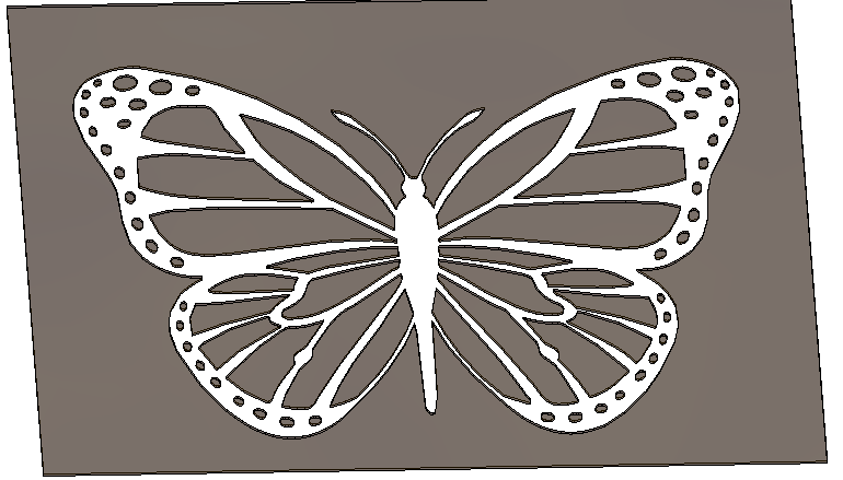

Here, I have a butterfly that I have only used to cut out the body.

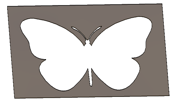

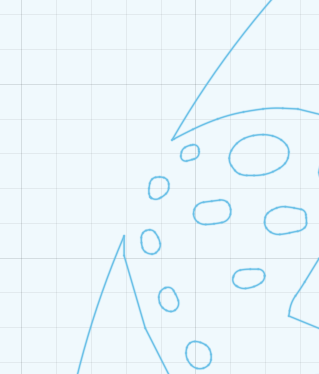

When I use it to cut the body out here is the result. This results in 75 floating bodies that will all fall out:
When they fall out, this will be the result:

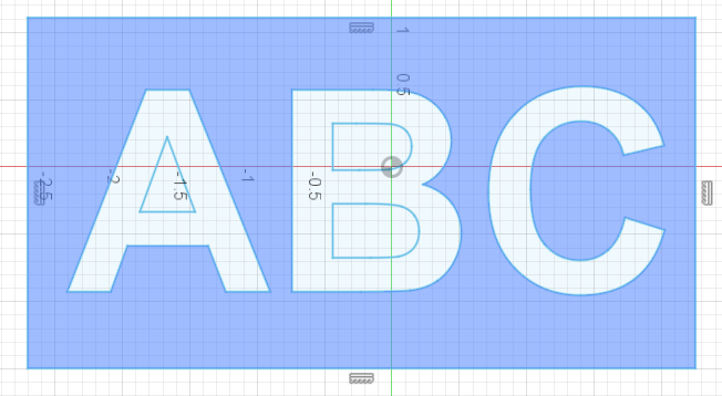

Yes, it is that age old concern of how to “bridge” those pieces to stay in the image. Just like with lettering. Here is a quick one:
You can see the sketch has more detail but it is lost. The image needs “bridges to the islands of pieces that will fall out.”

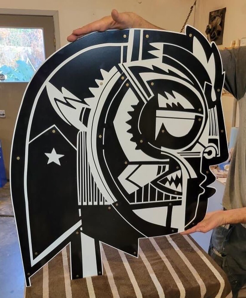

On an art piece, it is magical when it is done correctly. Another way that people get around it is to do multiple layers.
@TinWhisperer did a fascinating piece of an Indian face that I believe was done with four layers. If I find it I will add it.

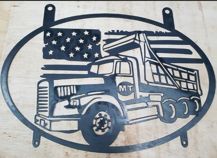

Here is an amazing example of quite a lot of detail and the support for the detail is concealed in the design. This is a piece that @Wsidr1 did from a design originally created by @DnKFab:
The truck is support by six contact points: 2 tires and 4 points on the flag.

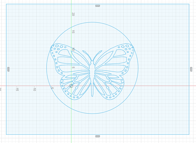

This would be the simplest solution for the butterfly. Use a 3-point circle that collides with the butterfly:
Delete the connecting areas:
There’s your image on the side of the panel:
