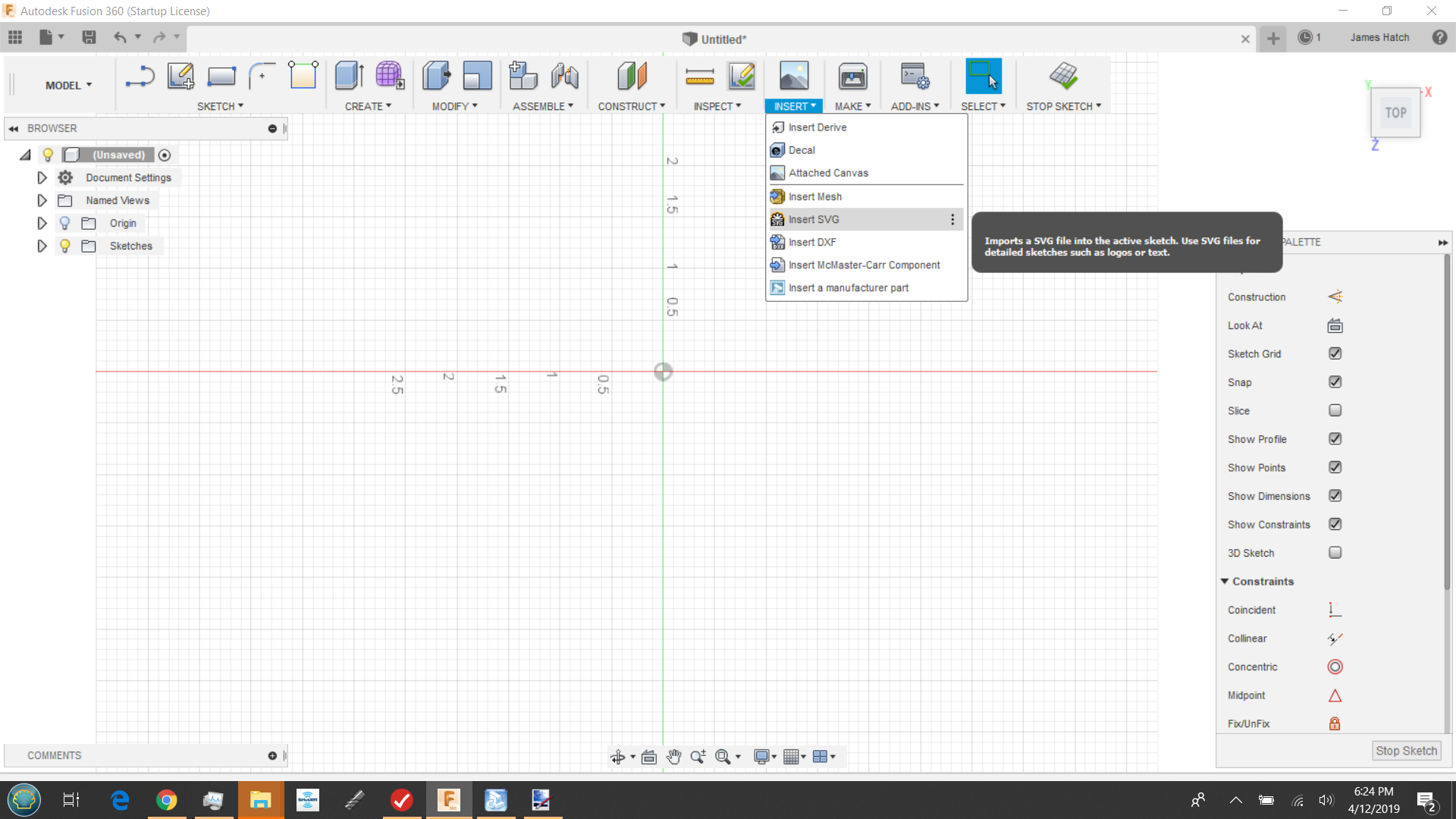

I know it’s been a while since my last post here but I still was not Successful with the DXF or the SVG file type
After Iupload the SVG file to fusion 360 and attempt to open it and work on or modify the file it is automatically redirected to https://myhub.autodesk360.com
Are you uploading (which puts the file in myhub) for a reason? I use the Insert option once I’ve created a sketch to hold it.
Here’s where you find it:
That places it in your drawing and then you can decide where to save it and what to name it. No need to upload the SVG or DXF files you might want to use in Fusion.
Great Tip James, Thank You, Yes I was Uploading .I will now make sure I use the insert tool rather than the upload. It also appears that the SVG plays well with others more so than the DXF do.
