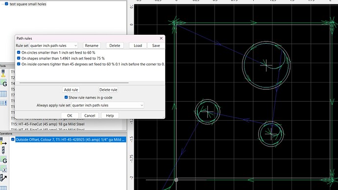

Background: I created Path rules for cutting holes in quarter inch, namely, cut holes under 1" at 60% IPM.

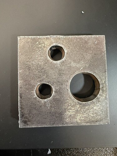

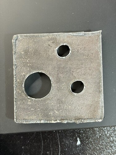

The 8mm holes are much smaller at the bottom than at the top of the cut. Top of cut might be 8.2mm and bottom at 7.3-7.8mm. The holes aren’t round on the bottom of the sheet metal.
The side view of my test piece shows that there’s more bevel on one edge than the others. Also, my corner settings don’t seem to be creating clean corners.

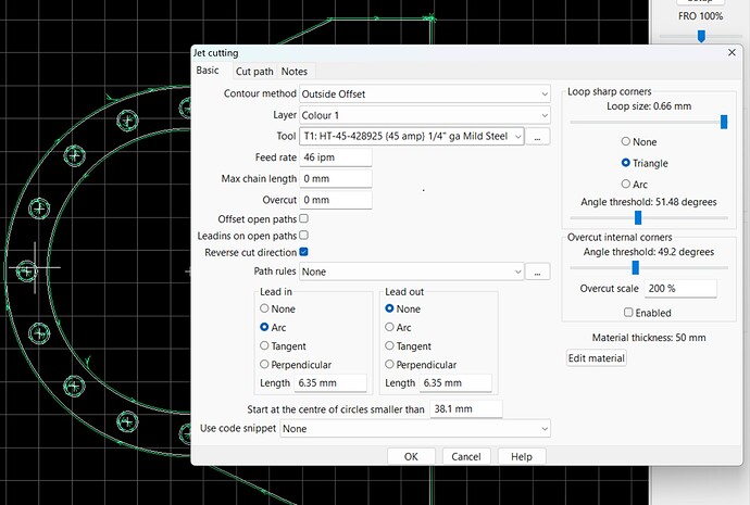

I see that you have created a rule set, but it is not selected in your jet cutting operation. Under rules, the field shows “none”. You have to click on “none” and your rule set should be in the drop down menu.
You will never get a precise hole that measures the same top and bottom with plasma cutting. If you need precise holes, they have to be drilled. I oversize my holes in the design, so the bottom of the hole will have the proper clearance.

You may have some backlash issues? Unsure how the XR works exactly but you can see that clearly with the transition from X → Y at the corners of your square.
This will also lead to oblong holes.

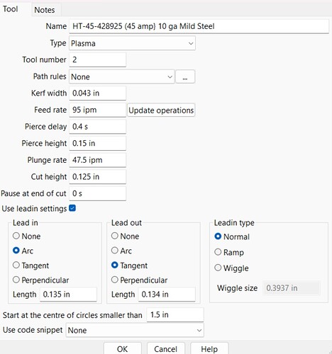

Now, I’m not a Hypertherm or a SheetCam guy, but it looks like your torch setting is too high, consumables are trashed, and you’re cutting way too slow.
You have the correct cut height setting, but as you can see in the image above, it is cutting too high. The cut IPM for a Sync on 10ga is like 115. Just because your settings are correct, the torch may be higher for many reasons. I would think the cartridge is toast or you are using a non-sync chart. Not to mention, the steel you’re holding up sure looks like 1/4-inch to me. Also, your kerf setting should be .073, not .043. The SheetCam setting picture you posted is for 10 Ga.
Mild Steel 45A - Cartridge 428925
He did say he was cutting 1/4” maybe he just changed the 10 ga settings and inserted 1/4” settings.

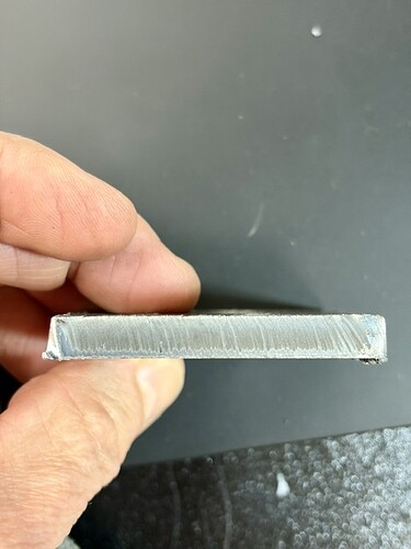

As others have pointed out, slowing down for the holes will help a lot. I noticed that on your straight cuts there is also a slight lag. Notice in this picture, the lower half of the cut shows vertical striations. That is probably as optimal that you will get.
Your straight cut is showing that the plasma stream is not quite catching up to the torch position. I would back your cut speed, in general, down a bit…not too much though.
Note: But don’t make this adjustment until you have checked your actual cut height to make sure that is dialed in. If the torch is too high, you will also create this situation.
Re rule: Yes, I uploaded the wrong screenshots. The first time I forgot to apply the rule. The second test I remembered. And did set the cut for 1/4” mild steel. I was going back and trying to recreate my settings so that I could provide all the info that might be useful. As it turns out, I did not quite nail it. Sorry, guys. I’m really trying NOT to waste your time here.

it is either your settings or the consumables are warn but looking at all the slag under the part you are defiantly tiring to cut too fast for the power setting.
